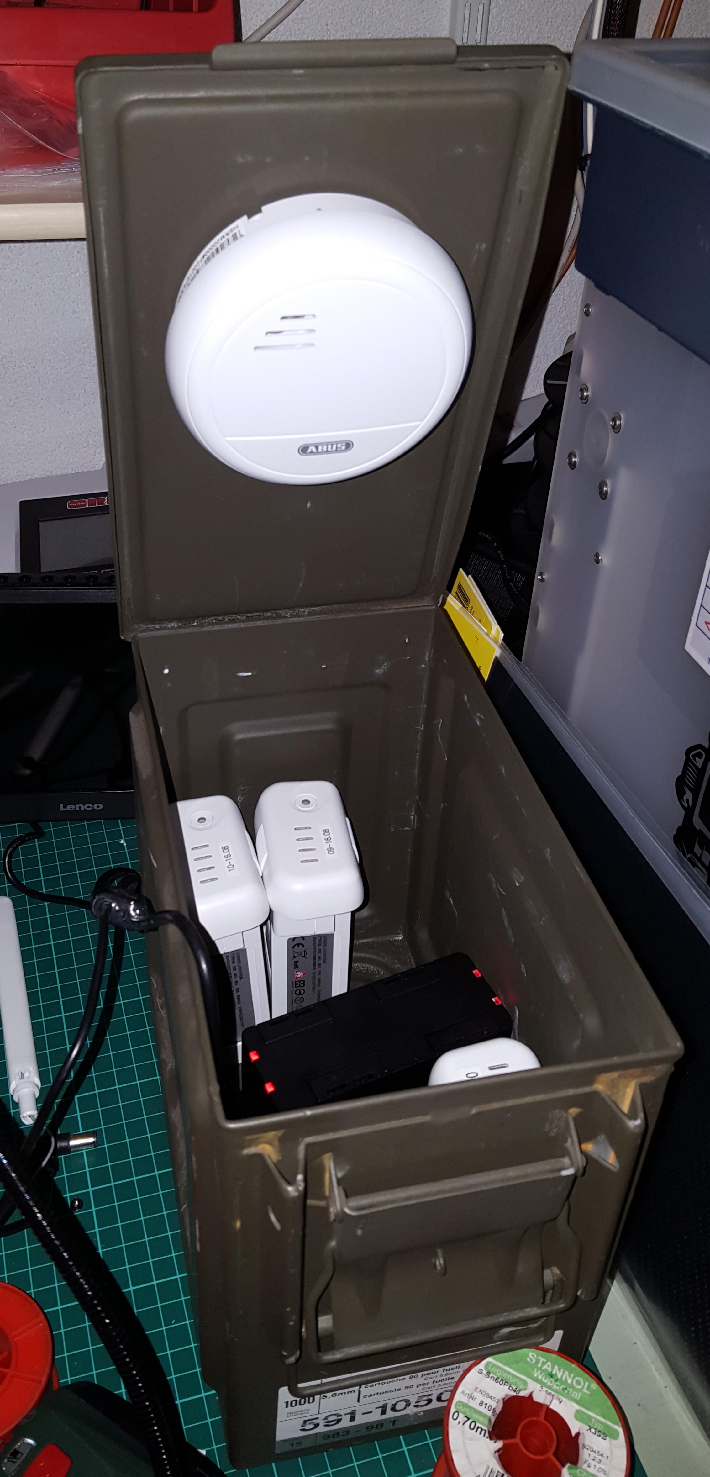

Finally I use at home ammo boxes to charge and store my batteries. I have put a fire detector in each which are wireless and connected to the fire detection system of my house.
Sure you will wake up in case of an issue but don't hit them or they will start a fire alarm test :oops:
Do you close the ammo box while charging? Can't close it completely with the cord coming out. But you can hook the bar under the clamp I suppose. Leave the lid slightly open but unable to pop completely open wide.
Besides, if a battery did blow up in a tightly closed ammo can, wouldn't that turn it into a bomb??
I've got some ammo cans & thought about winter storage of the batteries.
No, I don't close them, there is in any case the wire of the charger (was I too lazy to cut the box?). But as you said, they are air tight and I don't want to build pressure in them in any way.
Of coarse I don't put papers on top of them or other flammable material and turn them in direction of an open area.
Some others use a plastic bag full of sand and put them on top of their container. In case of fire the plastic would melt and the sand hold the fire (you cannot really stop a lithium fire but you can handle the fire of the plastic and other materials around the cells. I have never tried that.
Not a bad strategy with the sand. Bag melts, sand dumps on battery.
