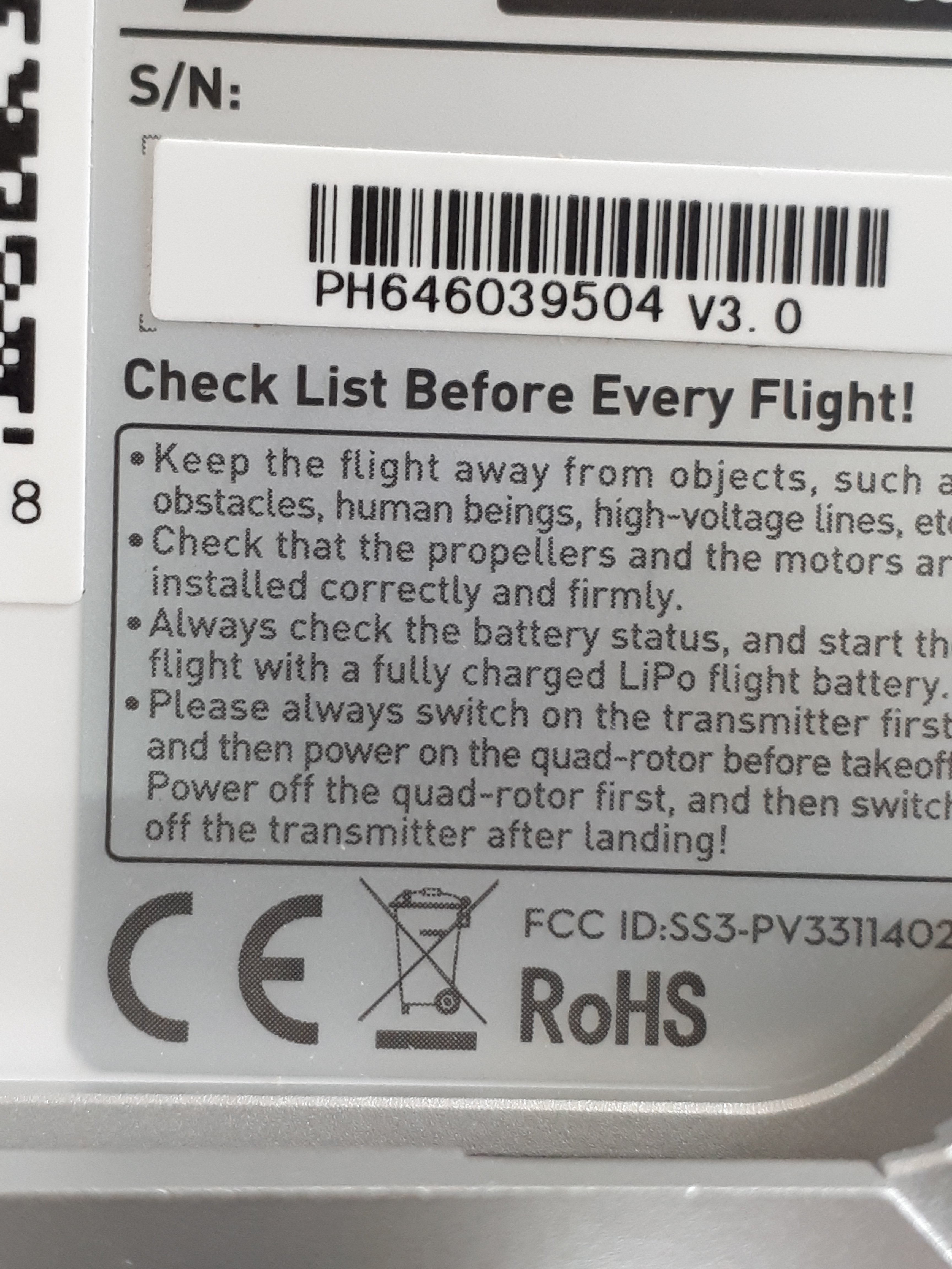

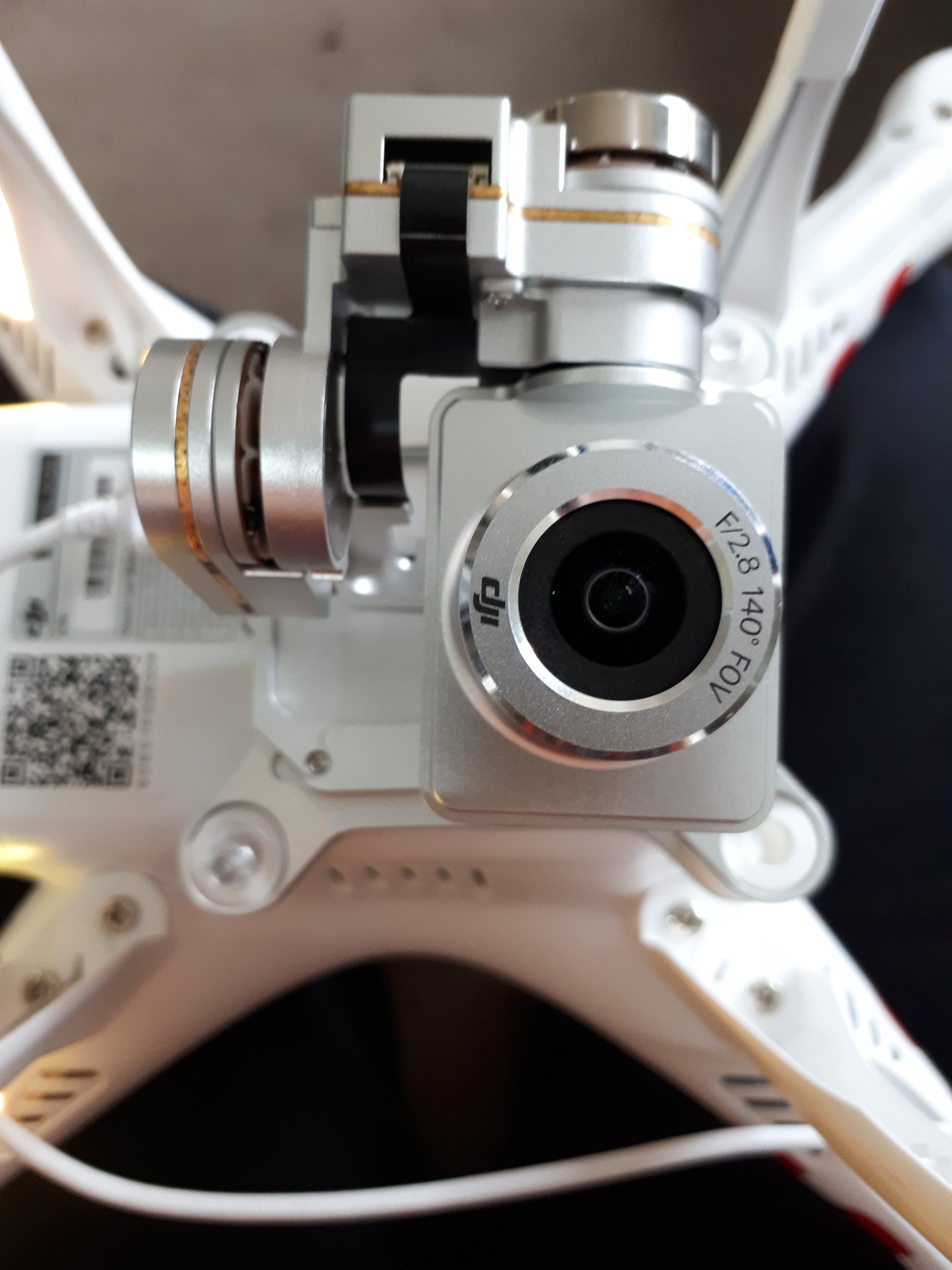

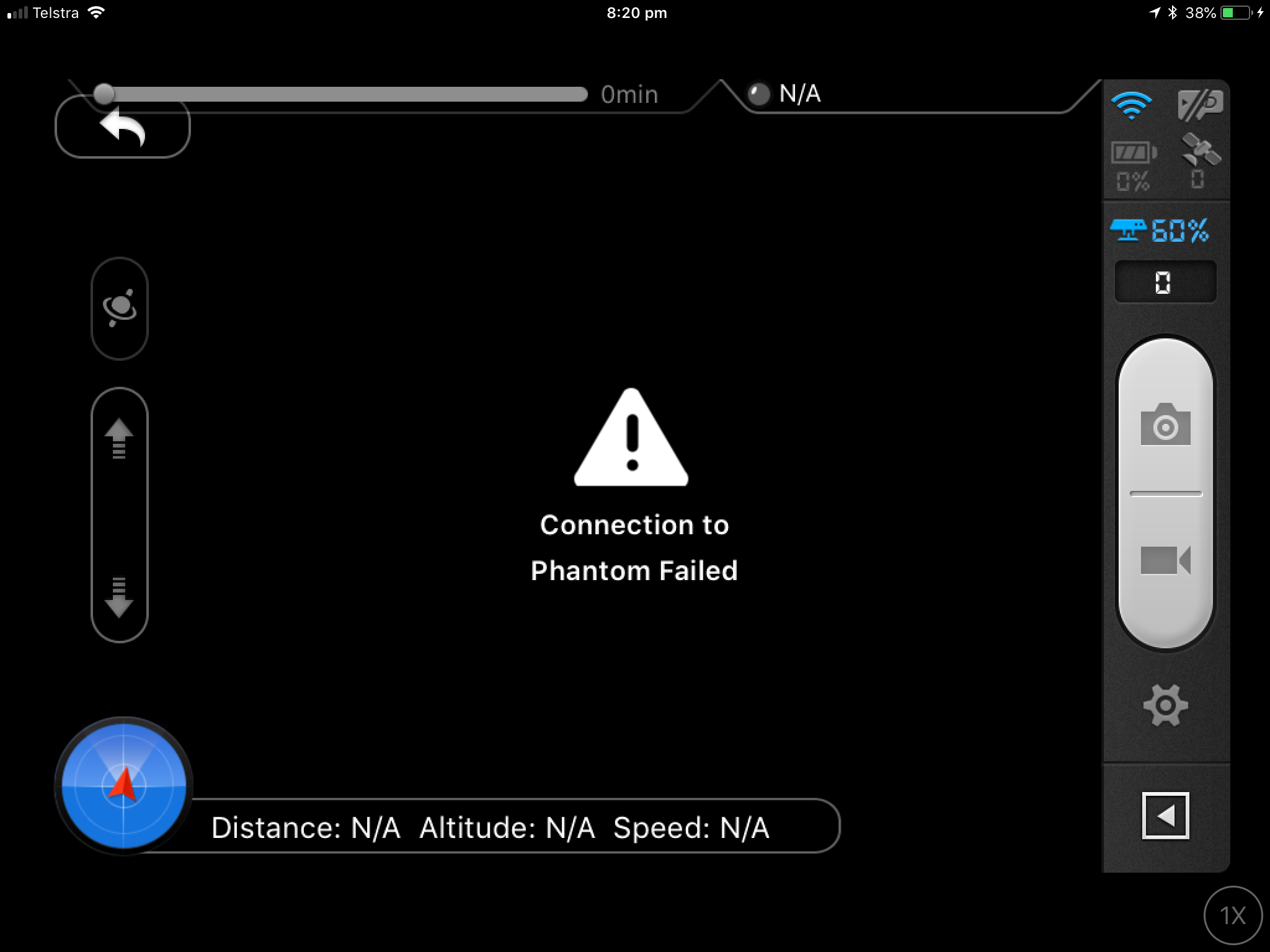

Hi People, sorry to bore you all, I have bought second hand Phantom 2 vision + that has never been assembled or flown. I am having difficulty getting the camera to connect to my Ipad on which I have downloaded the DJI Vision app. This camera is different to the one pictured in the instruction manual. I have attached some pictures of the drone serial numbers and of the camera fitted for your information. The wifi icon lights and then goes out and it says "connection to Phantom failed"
Aussie Paul. :)
Aussie Paul. :)
.View attachment 101721 View attachment 101722
View attachment 101718 View attachment 101719 View attachment 101720
Not sure which picture you refer to, that is the P2V plus camera, unless your seeing the Vision camera which is a white egg shaped unit

Thanks people, some sucess. Have not flown it yet BUT everything is connected, Video and stills are saved to sd card BUT no picture on Ipad. The icon on the range extender is flickering and NOT locking on as a solid green led the same as the on/off led. :( The gimbal is controlled by the Ipad vision app and the camera funtions of video and stills are also controlled from the Ipad.

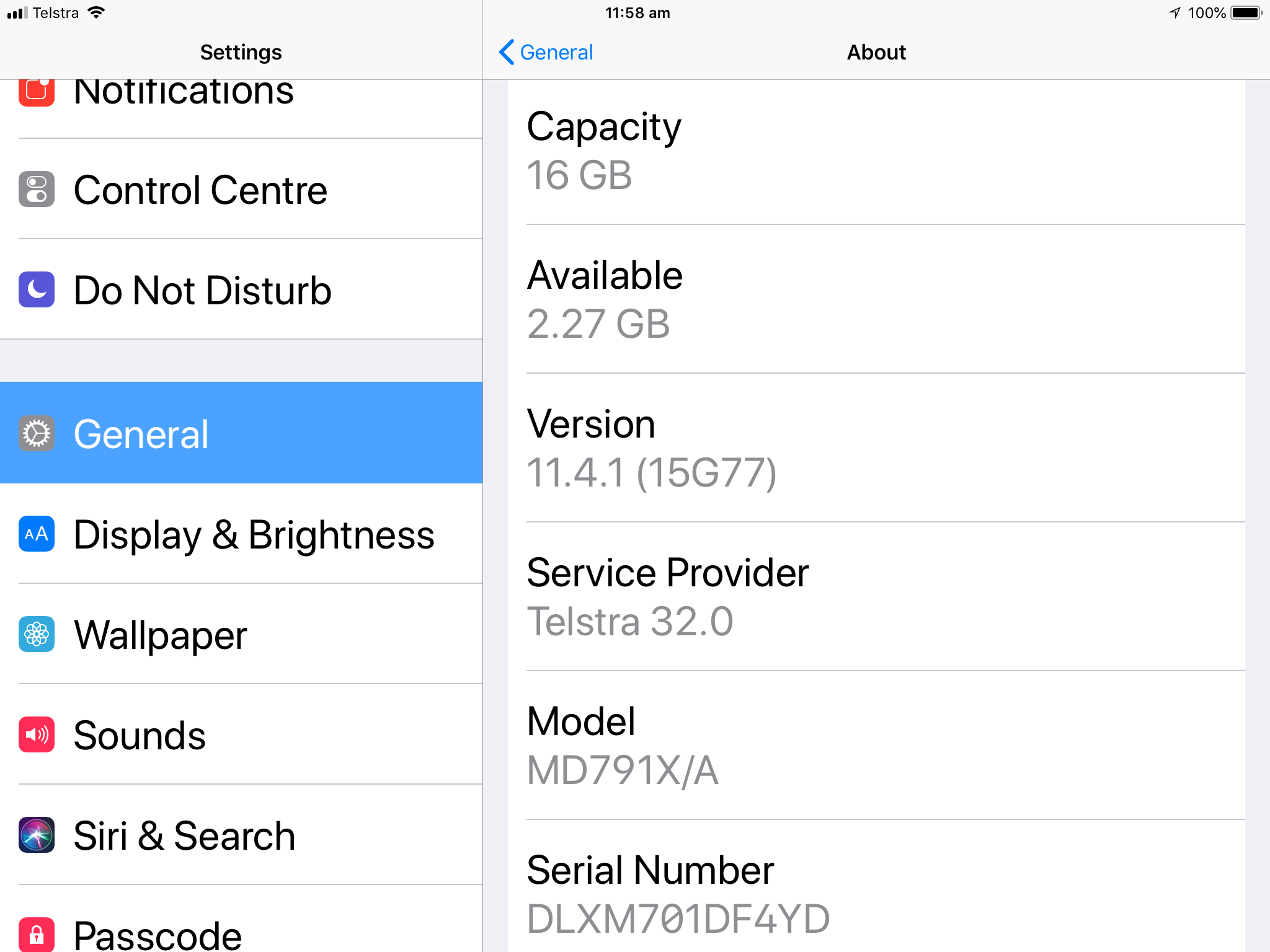

My Ipad is a few years old, these are the specs. We are going away for a few days in our caravan so I will have some time to continue to have my P2 operational with help from here,

Update people. Everything is linked etc and showing 8 GPS satellites, camera operates from the Ipad, BUT no vision from drone camera to Ipad.
