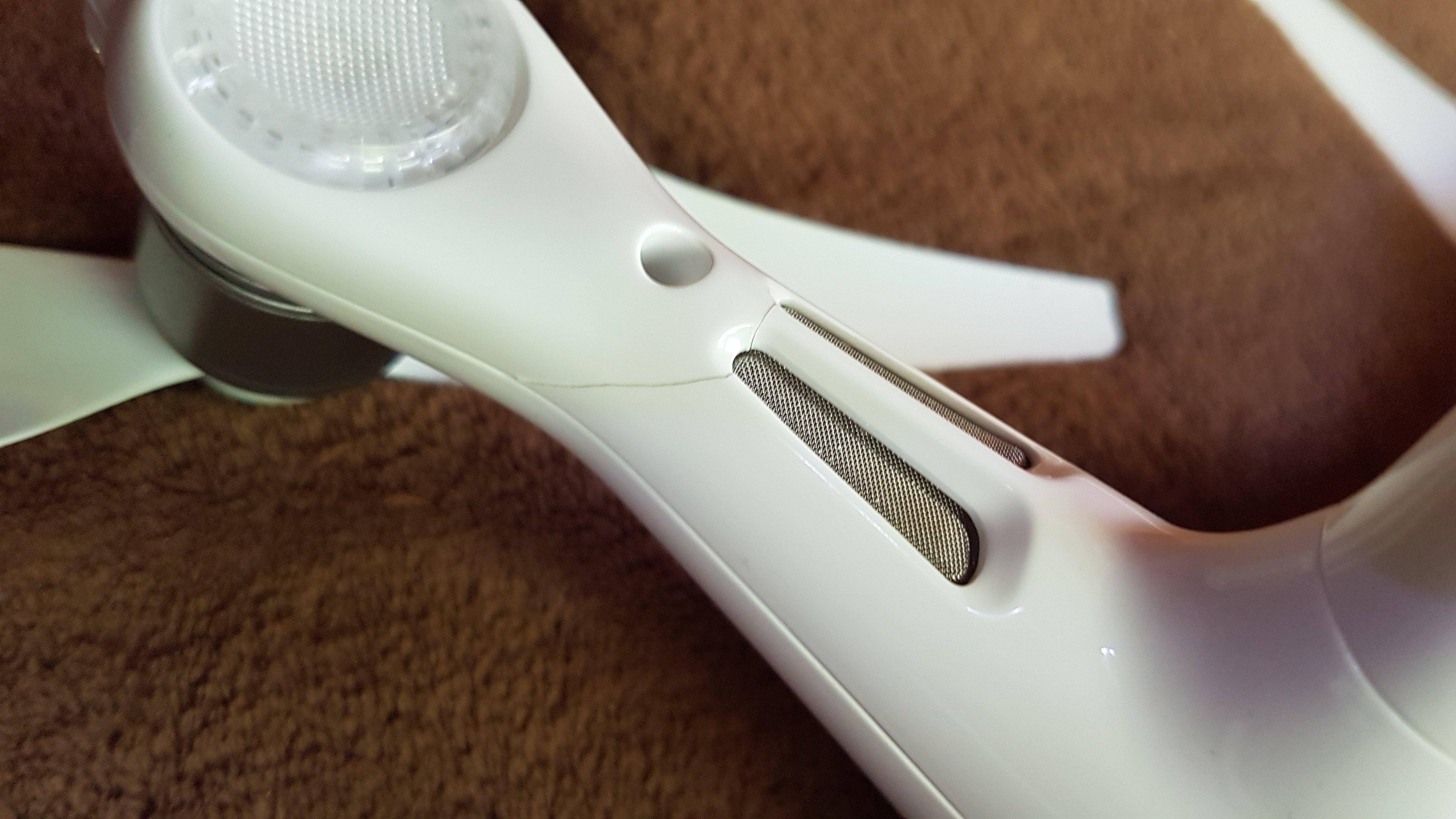

Where are the cracks happening? To stop a crack from travelling, drill the smallest hole possible just past the end of the crack.
I've stopped cracks in aluminum and plexiglass since being trained how to do it in the USAF Aircraft Tech Schools in the 1950s and have used that technique to this day. We would drill the small hole with a #30 drill bit just at, not beyond, the end of the crack to relieve the tension causing the crack. I've had no cracking in my P3P, P4, or Inspire v2 but would try a #60 drill bit or even burn a very small hole with the round pointed tip of a low wattage soldering iron.

Problem is not stopping the crack. The strength is already comprimised. This is my second cracked p420171117_125408.jpg

That Tarot Carbon Fibre Frame at the affordable price of $99 looks like a great project! I'd love to see your ongoing and finished project if you decide to do it!! That would definitely take care of your cracking problems!
The biggest issue would be the battery box. Either cut the Phantoms and use its assy. or just use the battery contact blades somehow. I think making a dual battery box would be great too.
The value of the Phantom 4 is the gimbal and camera integration. Tarot makes some nice drone frames, add your choice of components and you have a nice drone, but what gimbal and camera are you going to use? You might be able to hack the P3 Pro gimbal and camera onto the Tarot frame, but not the P4 gimbal/camera. You are better off getting a new shell from DJI and rebuilding your P3 Pro/P4. Probably easier too.
