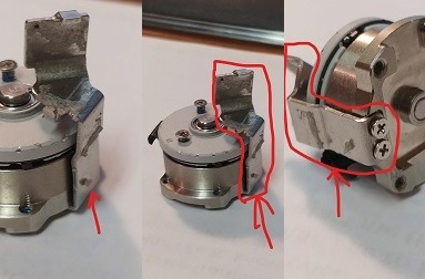

So i was able to get everything apart. seems like when the drone hit upside down the weight of the camera jerked back hard enough to where the screw heads that hold the yaw motor in place pulled through the gimbal arm, bent the little bracket that is attached to the yaw motor and popped the yaw motor ribbon but the main ribbon is good i guess thats why i was still getting good video after the accident. I ordered a new yaw motor, and gibal arm and tried to bend the damaged bracket back to the way it was. it looks as if i may have it but i really want to get a new bracket to replace it . the pictures attached ate the yaw motor and the bracket that was bent. After searching on google i could never find the name of the bracket or where i can get one if anyone has any ideas where i can get this bracket please let me know, it doesnt look as if it comes on the new yaw motor.

Hi Gervin, yeah I had the same trouble with that bracket but managed to bend it back into shape, make sure when putting it back on that its free and not rubbing against gimbal motor...As where to get a new one i dont know ? good luck with the repair.
Thanks Alan, i have it straightened pretty good , now i been reading the new yaw motor may not work properly unless i take it apart and put it in the shell i have . oh well we will see.
Yes Gervin when you replace the yaw motor on the P4 you may or may not get camera dis alignment,,,unfortunately that was the case with mine..but I was not really concerned as I bought it for a song on ebay. I know how to fix it...replace the yaw motor housing..which I still have...anyway I have 2 Phantom 4s now I reckon they are DJI s best!!
