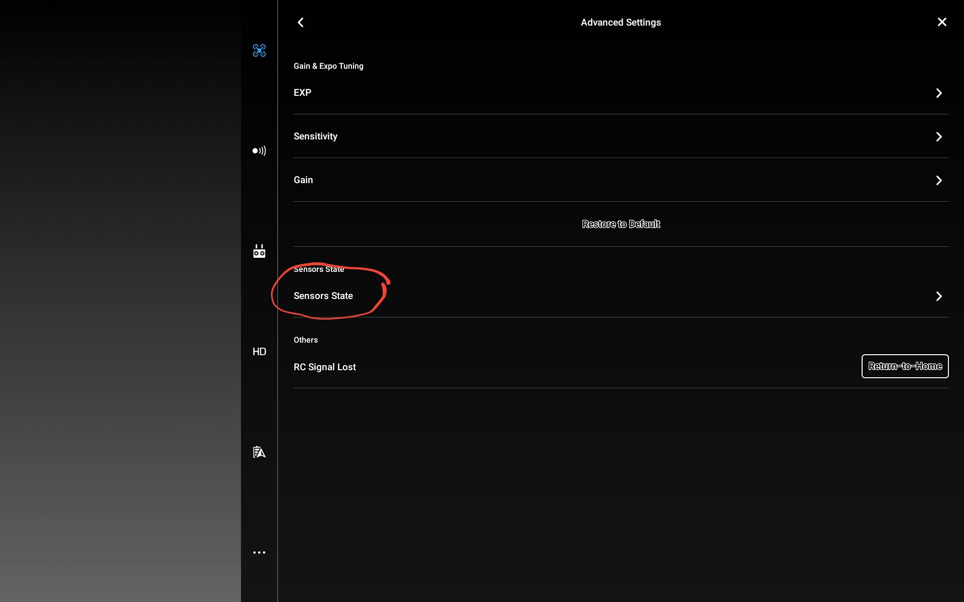

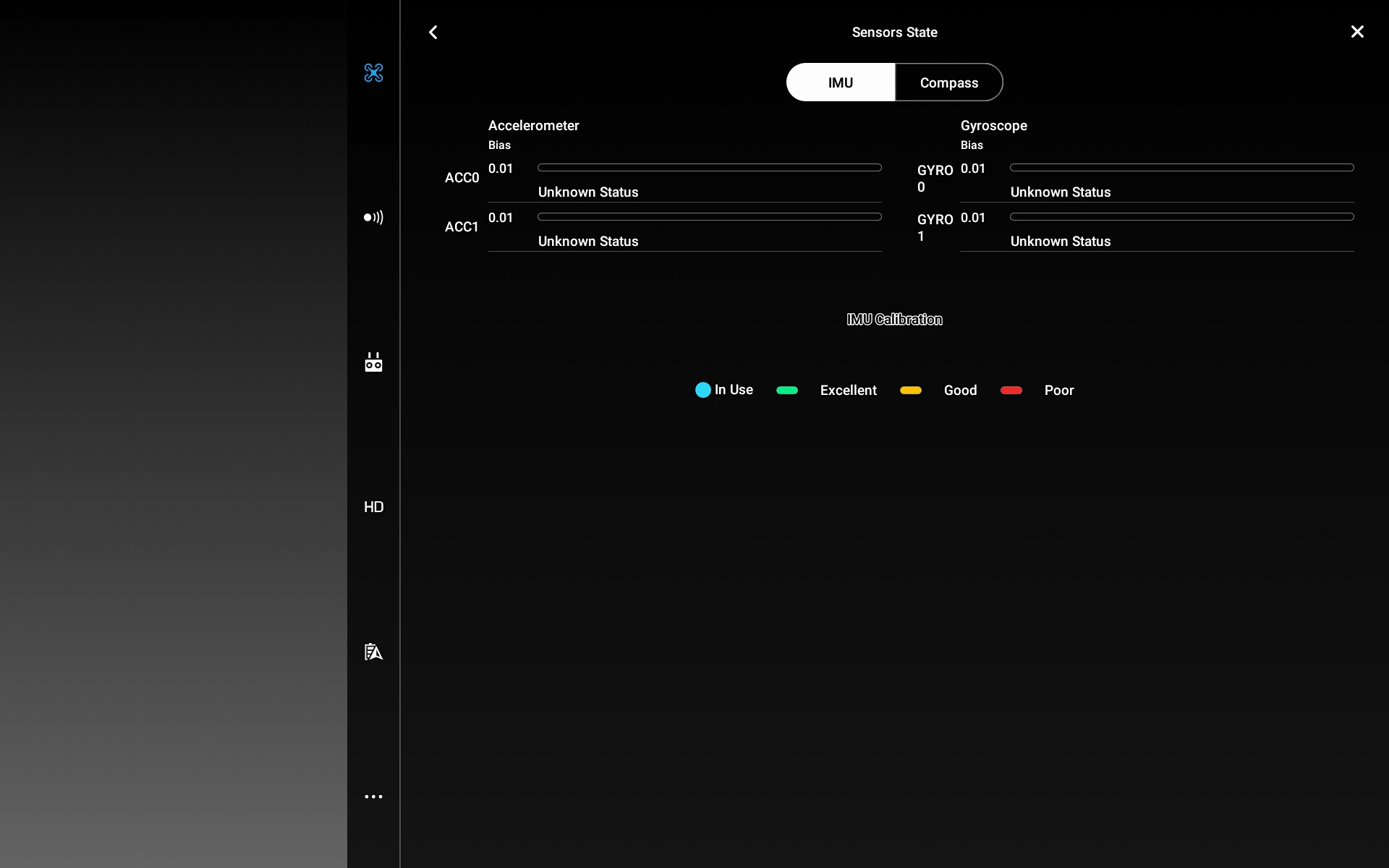

Which advice you look for,,how to do it ? Where to find it ?,it's a 6 step process where you take off props and follow onscreen prompts,it sits quiet for bit then you move to the same picture onscreen,example,,picture show drone on side,you copies it with your drone,,very easy,it should last move is upside down,,
Is this what looking for ??
I updated my firmware and had an issue with it saying battery wasn’t connected which it was. I will look for them icons tomorrow to try to calibrate. Any other advise? Should I calibrate campus first or Imu?
Just do imu,that takes care of most sensors and compass related adjustments
You could do the compass if never been done,,can't say I've heard of one saying batt not conected but these things seem to spit out random prompts,it be asking if we want coffee next
