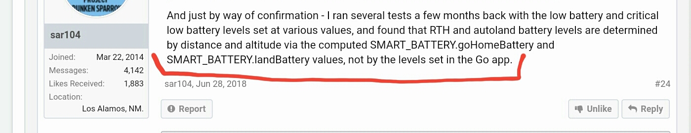

Ha was thinking of you when I reply to other post about batt settings in app,did you find a fix,was thinking how the smart return home setting is triggered by the app,by any chance did you check the settings with a computer to see what they read,after reading @sar104 how he mention that sometimes settings in the DJI app, here's a pic,,this was from your post aswell little while back,,mayby it's not what it read,, just a thought

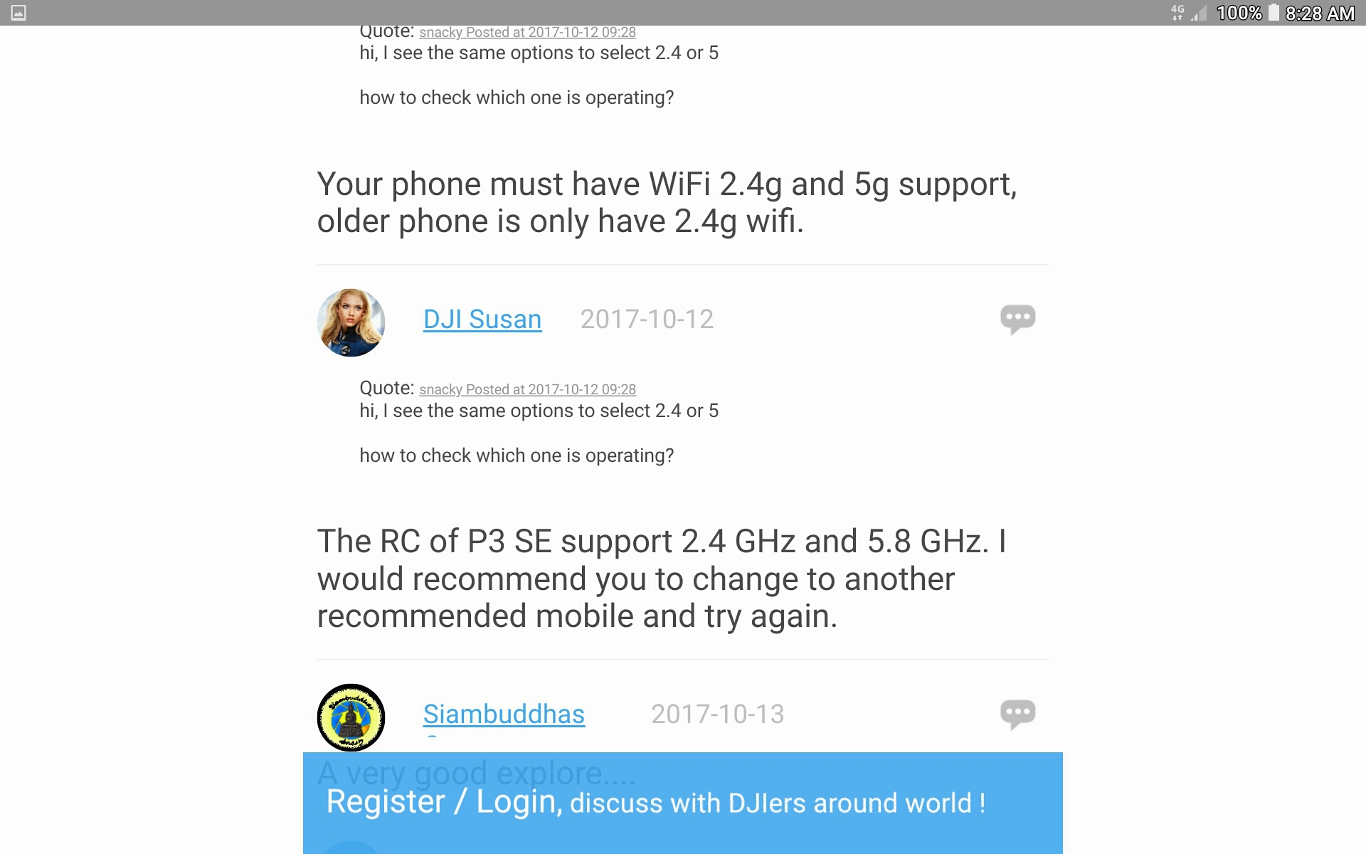

OK me had study overnight , since no one corect me on this I find out its just for the video downlink,this post below says the phantom se can be changed from 2,4 to 5,8 but only on a newer phone, oldER devices only have 2.4 , mayby have a change and compare if it better,,,gosh hope this can shed some light on this issue
