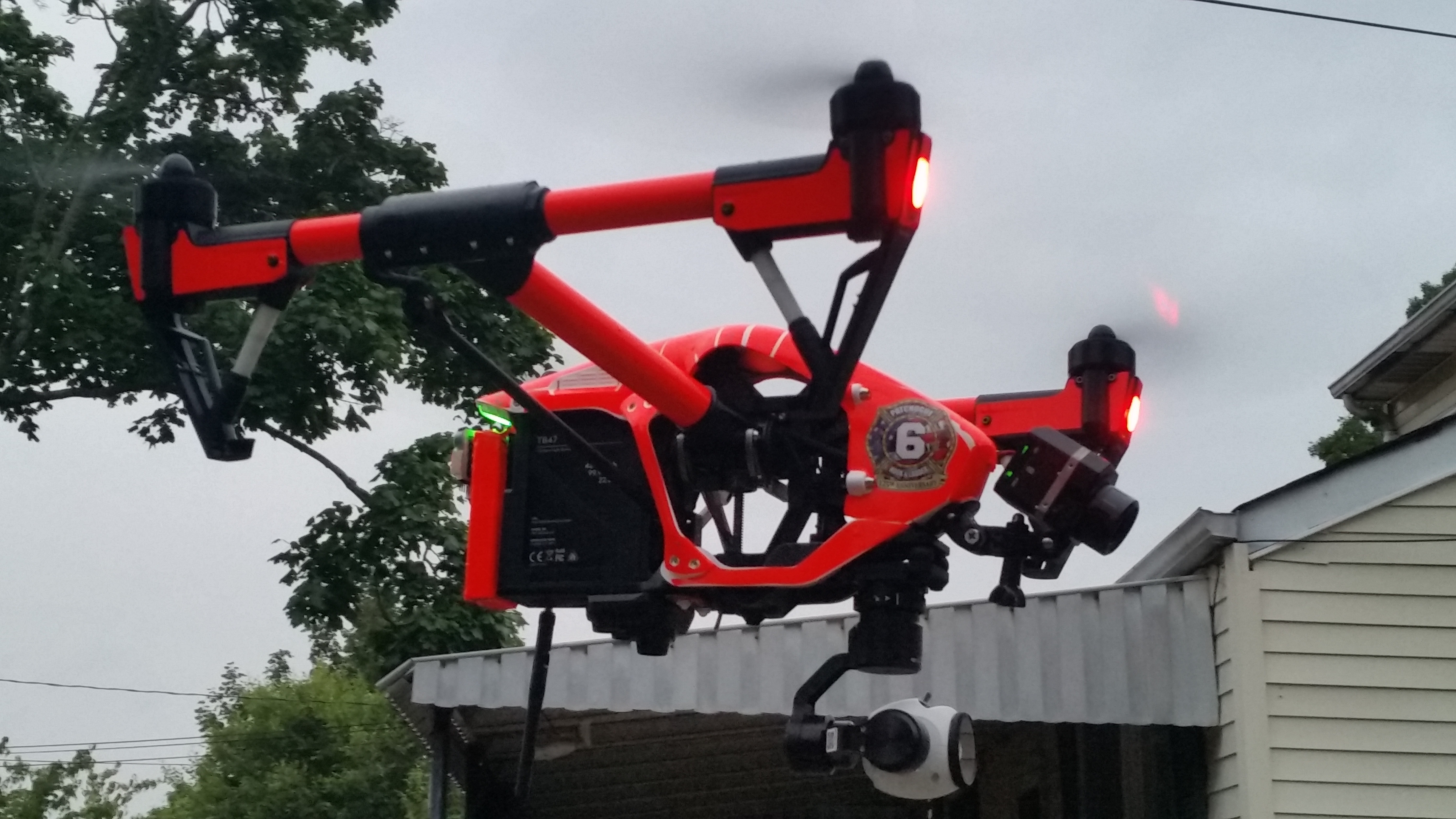

Thanks for the words, I started using my Flir on my Inspire One mounted on the nose with my battery mounted outside on the tail, the I1 handles the weight with no problem, I also use a Z5 camera with zoom. Just recently my I1 became unreliable losing gps and drifting off scene while covering a house fire in moderate winds. This needless to say woke me up since my flight zones are usually tight with trees and wires. Having my personal Flir camera on the front, $2000, I get concerned about drift away when gps is lost. I came upon a P4P, saw the Flir gimbal mounts which looked great, but the crazy price tag of $1770 was out of my league. I designed my own mount out of cable Panduit plastic, added a 11.1vdc 1.8amp battery and video transmitter to the upper portioned area of the mount and put a go pro mount below that. It fit perfectly, the P4P flies great. Total cost, nothing, since I had the parts. I know that if I add a gimbal, I will need to add a receiver to control the gimbal and add another remote to talk to the gimbal. I use a drum shoulder harness to mount my two screens and remote, it should be a challenge to mount another remote. If I had the funds to buy the commercial mount I would, but somehow I will succeed.
