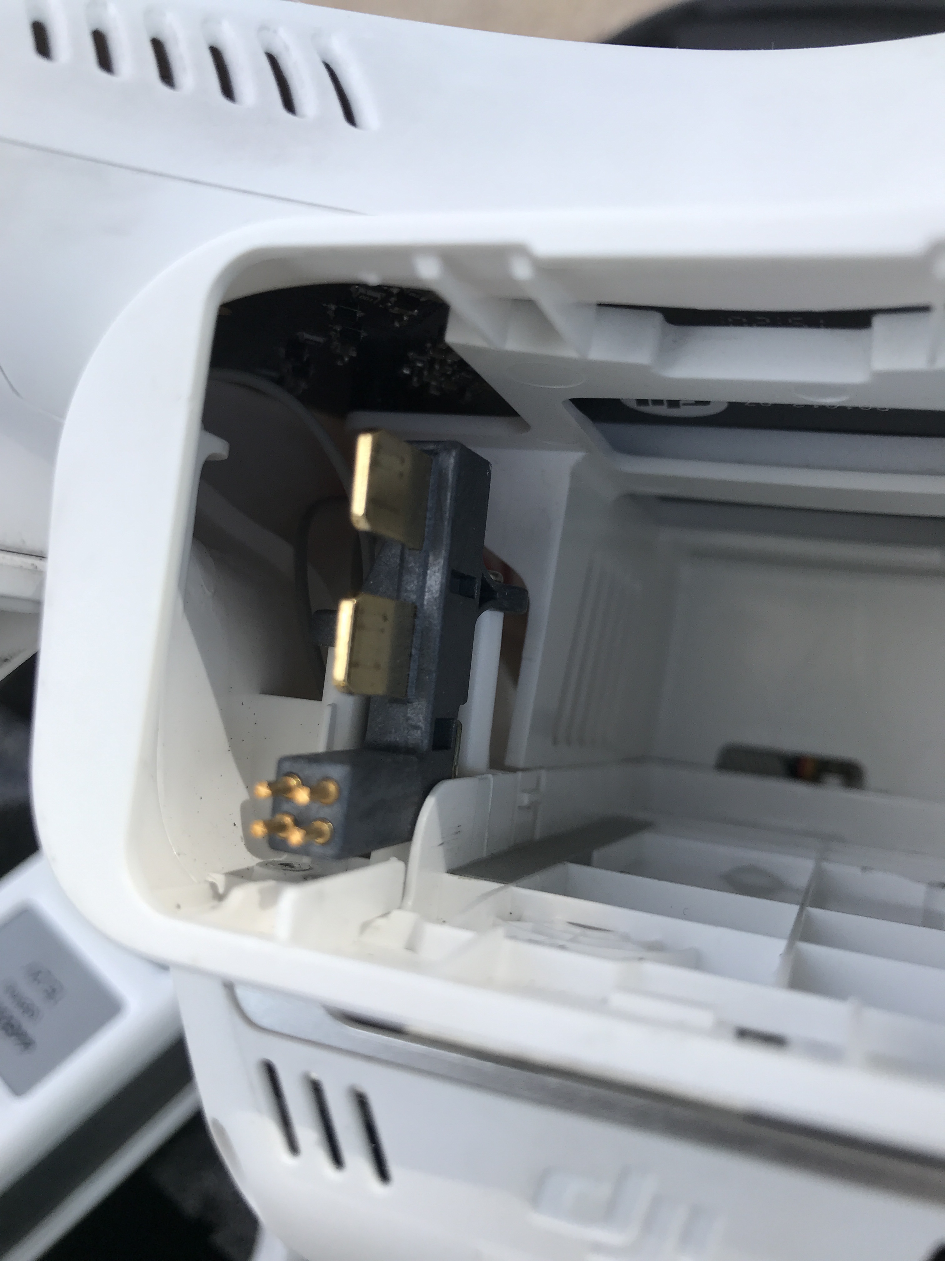

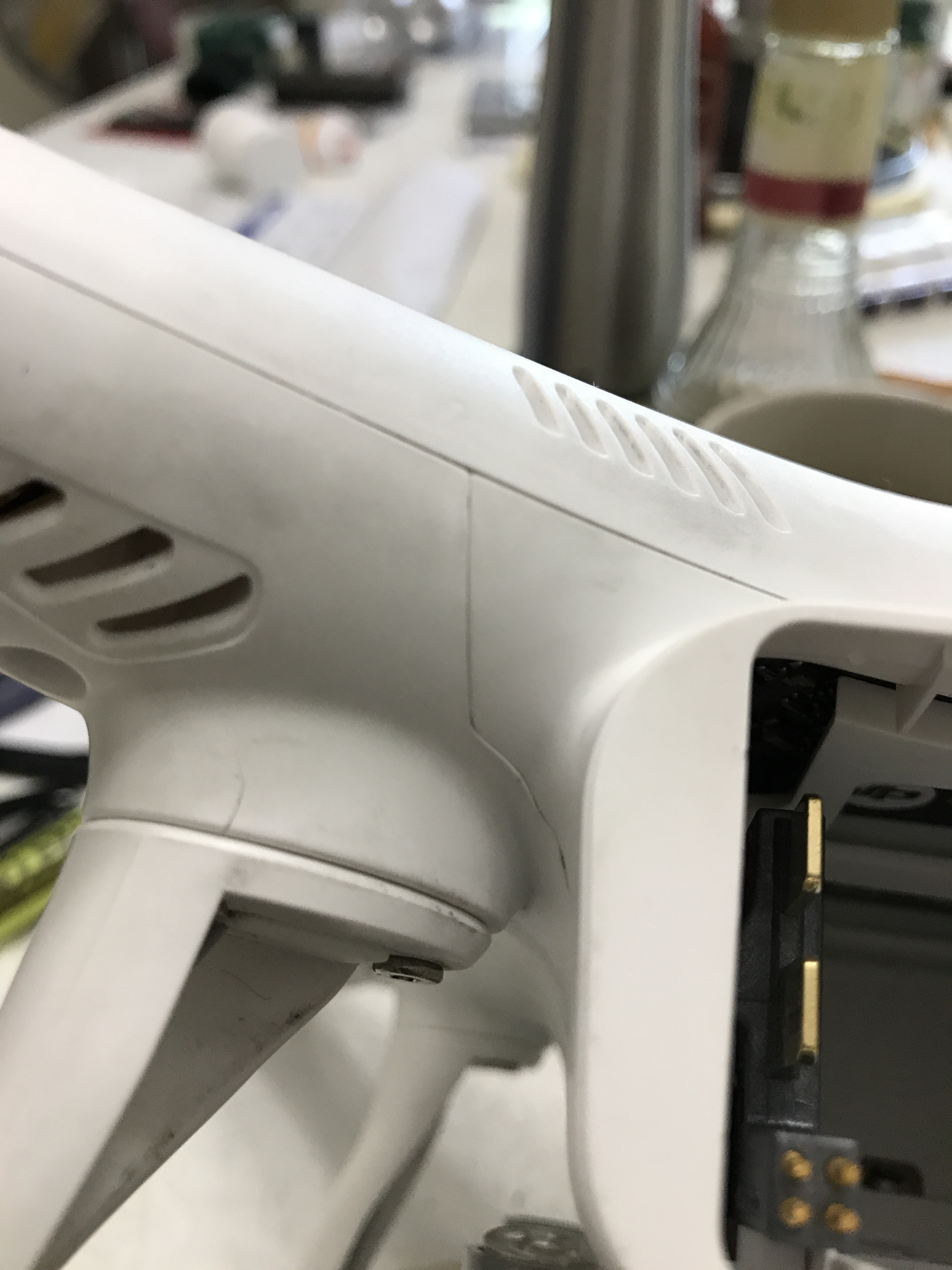

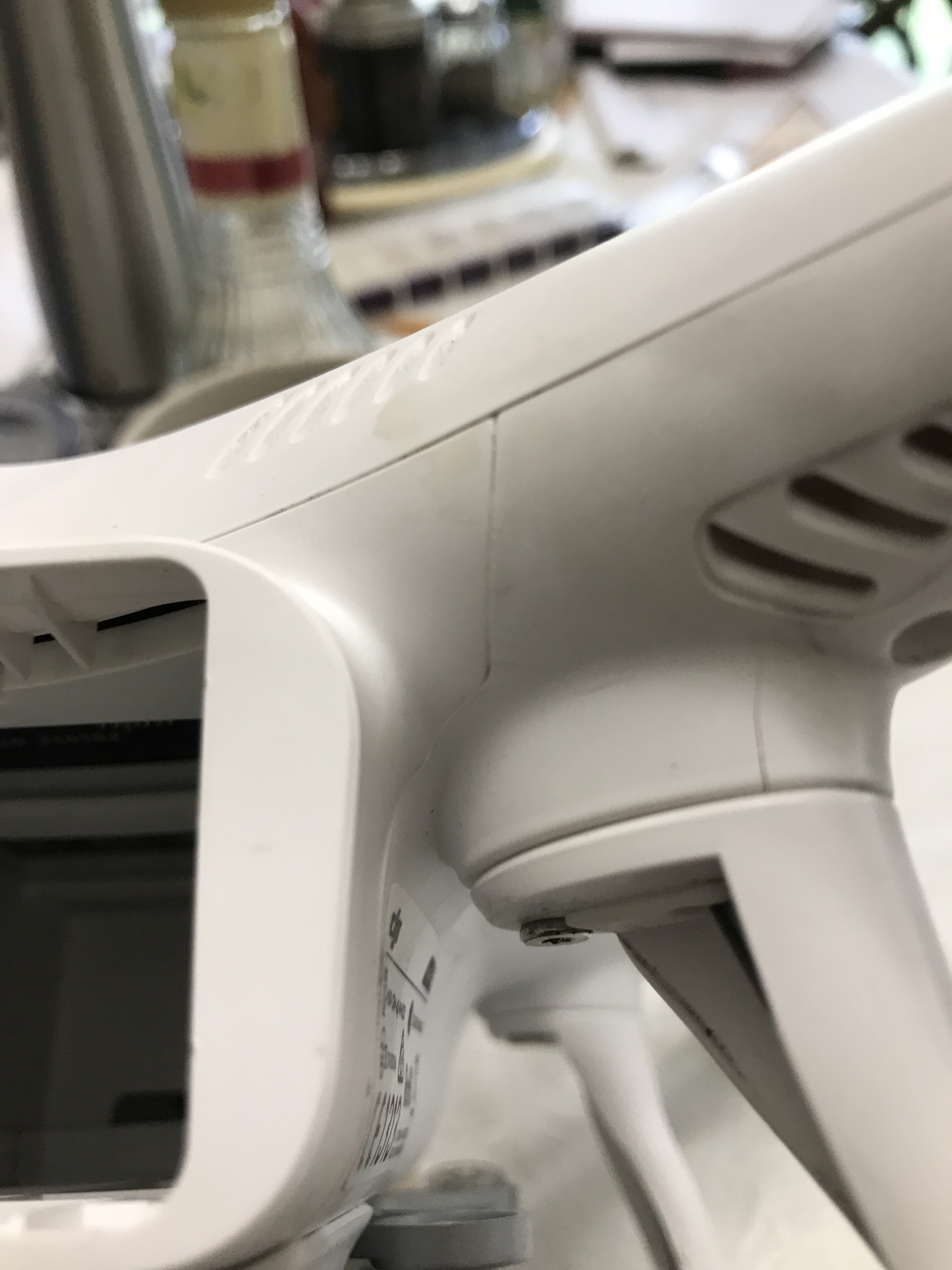

I assume you know that the long diagonal lines are not cracks, but there are certainly cracks where the landing gear mount to the bottom shell.
Also, are the main power terminals melted a bit on the tips? Hard to tell for sure in your photo. Perhaps this was submerged at one point?

Ah found it,you started another thread ,I reply but no one home over there,,,p3p uses usb from remote to device,got this in,won't conect without usb,,,,my legs got cracks but haven't grown in size,looks like couple hard landings mayby

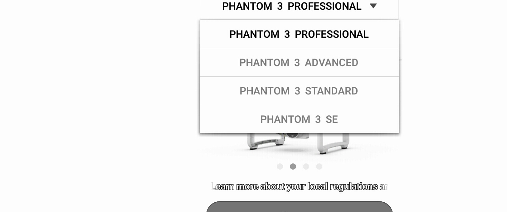

I can still use the same DJI go app to fly both p3s and p3p right
Yip very good does need the usb cable
Yip can fly djigo app with both
Pro and advance use usb,,,p3s p34k,p3se use wifi with go app
