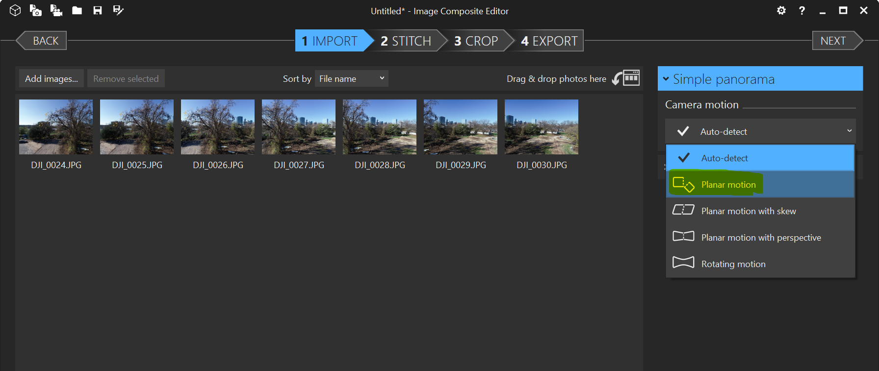

I usually get close enough that I would need 4 or 5 pictures to cover the subject in landscape. Be sure you don't rotate. Just strafe from left to right. Tip is to pick a landmark on the right third of the frame and strafe right until it is in the left third. Once you get that row done drop down 1/3 and go back to the left. Of course the directions are up to you, but you get the idea. Microsoft ICE is free and super easy. Just upload the photos and click next. It should figure out how the images were collected, but if it doesn't you can select it manually. You will want Planar Motion. The rest I am sure you will get. Be sure to overshoot so you can crop if needed.
