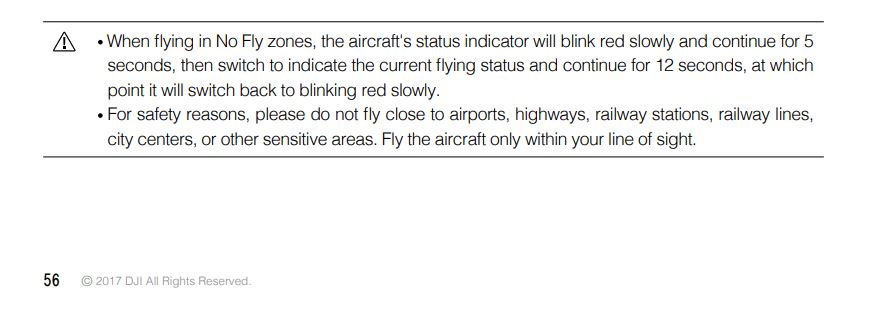

My take is that it is related to the geo system and being in or near some sort of authorization zone. I don't know for sure however. This snippet from the manual seems to confirm.

I had the problems since about beginning of september, after a firmware update. In the meantime I did some tests. After Oso's tip I checked the dji no fly zone map and I noticed that I am living and flying on the border of a no fly zone. So I did some starts near the border but inside the no fly zone and I always had the issue with the red (2x) and green (6x) blinking rear led status indicator. When I moved outside the no fly zone, still near the border, I had no problems. The zone is an altitude zone. What I can not understand is that there was no notice on the screen about the no fly zone. Nevertheless for me the problem is solved, thank you very much for your help!!
