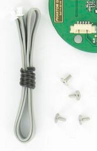

Mine GPS antenna also cracked among other things: Two motors, ESC module and body. But when I dismantled the GPS module the grey cable to the unit appeared broken as well. The connector that is.
So I will order a replacement GPS antenna from Digikey, but I also need this cable. Does anyone know the part number? Or other ways to replace this cable?
That is the compass cable and you can order it separately as either the cable kit or compass complete. Clearly I don't use any Dutch suppliers, but Buzzflyer and Align-trex in the UK have them in stock.
