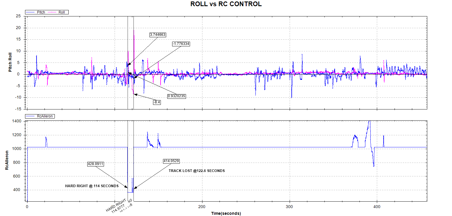

First, take this with a grain of salt, because I am not disputing your story at all. But, unless I am looking at this data incorrectly ( And that is entirely possible, because I do not know how long the tracker continues searching after loss of lock) It appears that your hard turn was several seconds before the loss of active track. This could be normal due to latency, and other factors, but I wanted to clarify that with a second opinion. That said, according to the graph below the hard right you mentioned is 7 seconds before the loss of active track which is slightly different than what you explained, so if @sar104 has the chance, I would just like a clarification.
That data is correct, except that I made a hard left not a right. I walked out of my driveway and into the road, making a 90 degree left turn at the intersection to the road and walked about 7 seconds down the road until it veered to the left suddenly.
About halfway down the road, the P4P suddenly veered to the left,
I don't see a severe left veer, only the hard right from the RC, which I assume is in response to that. I would think that you would see that veer in the Roll Data, there is a very fast spike to the left, but only around 300ms-to 500ms, approximately.

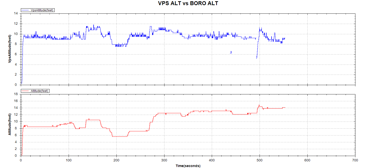

Which might be one reason why AT won't start until the drone is above a certain height. Starting with the P4, it also maintains altitude up until the VPS sensors work.
@tcope Good Point....VPS was active for the entire flight....as per below.....

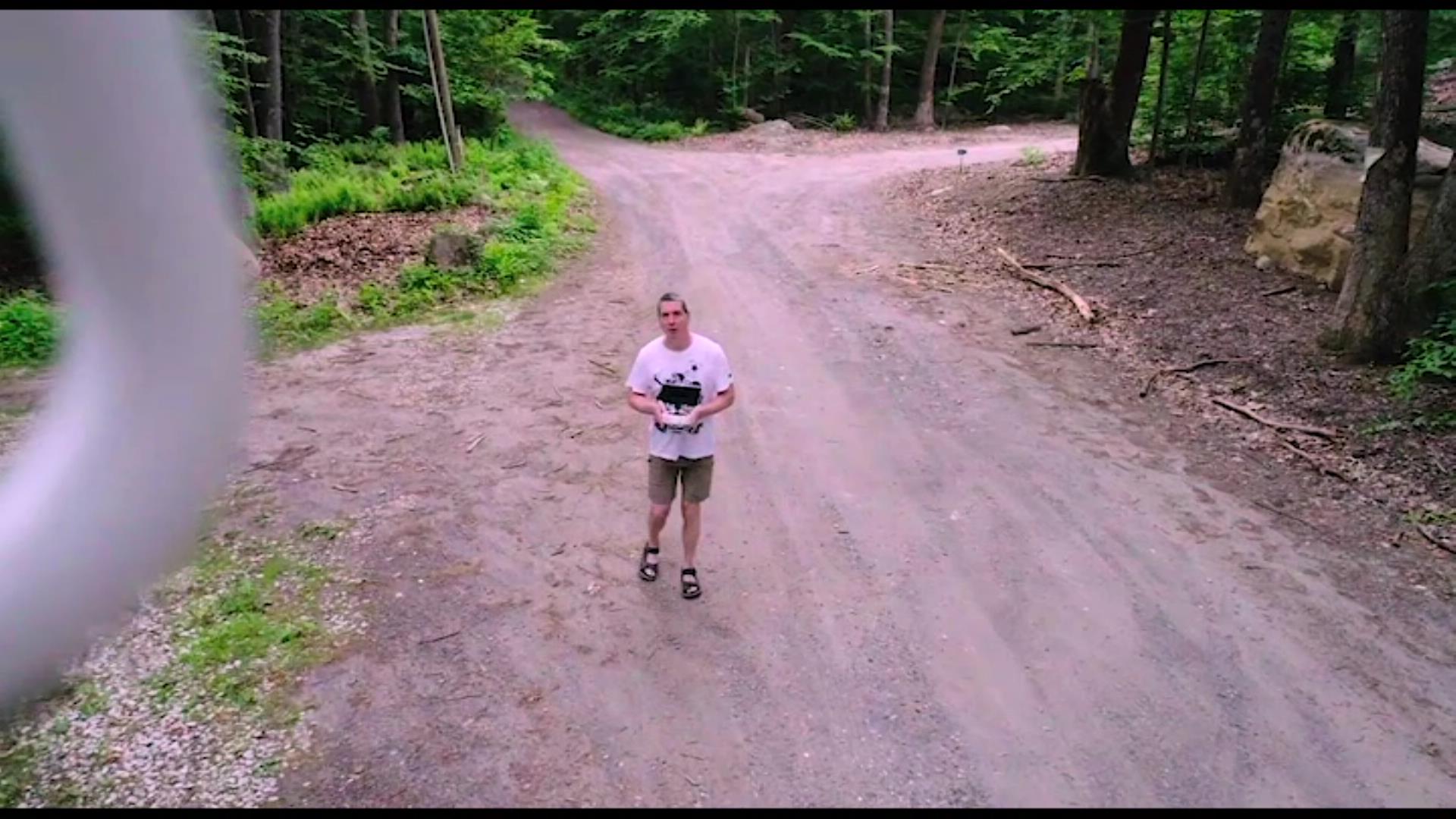

Doing a frame by frame on the video, this could be purely coincidental, but may also be a cause of the loss of lock. In the image below, notice the landing gear are extended far in to the frame. Coincidentally or not, this was within only a few frames of when it began moving toward the trees. Also, I looked at the frame rate and unless you changed it in the edit, this was shot at 24fps. That could also have an effect on the tracking. You might try a higher frame rate and see if that improves it

I did notice that sudden yaw where the gimbal kept the shot straight but the landing gear came into the frame. I think that's where something went wrong first.

Someone else just posted an identical incident this morning in the DJI forum. I saw the video--same thing happened, with the landing gear coming into the frame and the drone veering off to the left at high speed.

Doing a frame by frame on the video, this could be purely coincidental, but may also be a cause of the loss of lock. In the image below, notice the landing gear are extended far in to the frame. Coincidentally or not, this was within only a few frames of when it began moving toward the trees. Also, I looked at the frame rate and unless you changed it in the edit, this was shot at 24fps. That could also have an effect on the tracking. You might try a higher frame rate and see if that improves itView attachment 100068 . I would think that it would be more efficient at 30fps.
