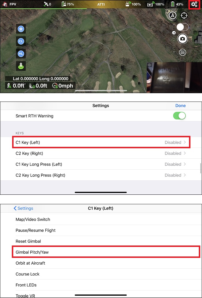

Ok went to fly my p4 and for some reason left dial doesn't move gimble up and down.It movets left to right instead!Just downgraded firmware and same thing.
And if the fix from the DJI forum does not work, you can install Litchi and set the C1 (or C2) button to "Gimbal Pitch/Yaw". Then, press the C1/C2 button to toggle that setting from yaw back to pitch.

Ok just got home and did the litchi pitch/ yaw..Bingo did the trick!! Thanks for the help that was the problem pitch/yaw changed in litchi.??
