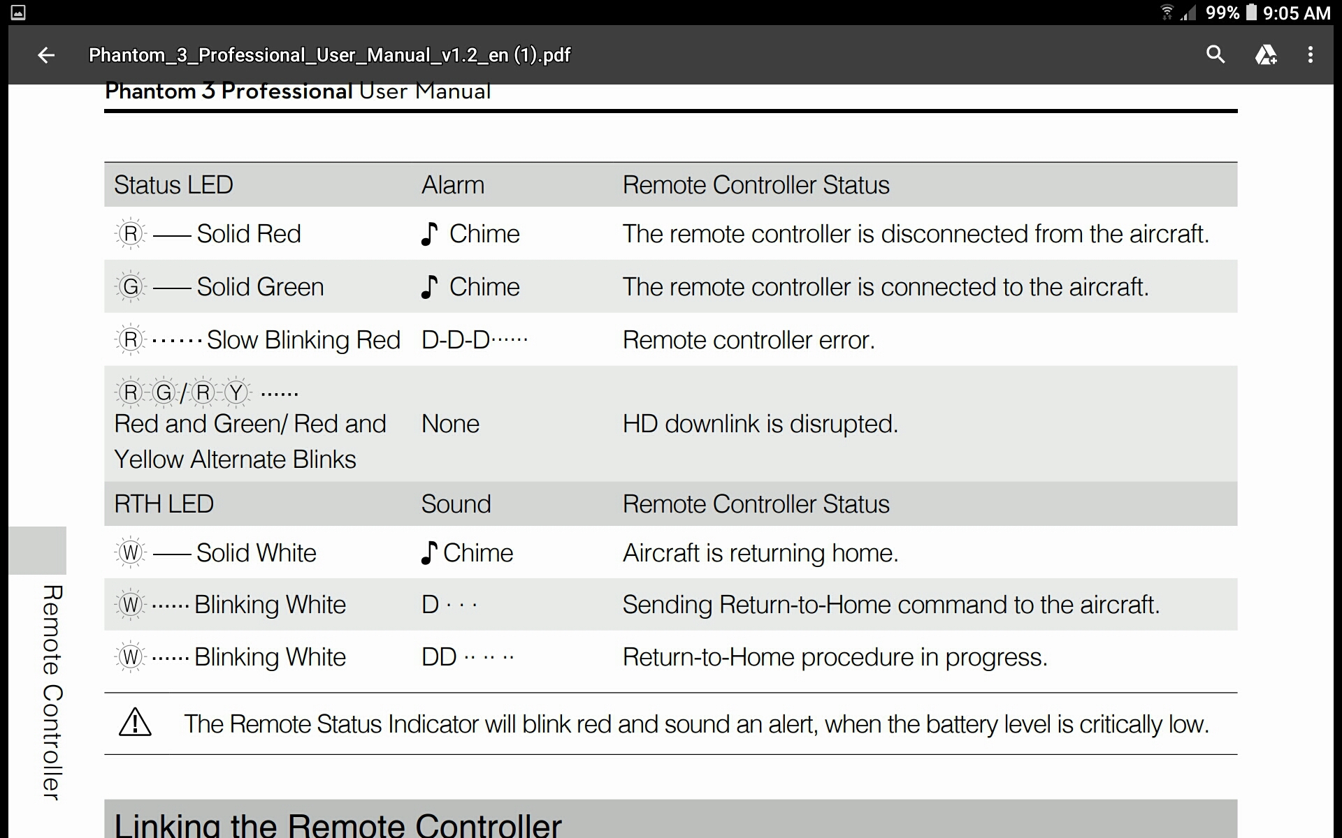

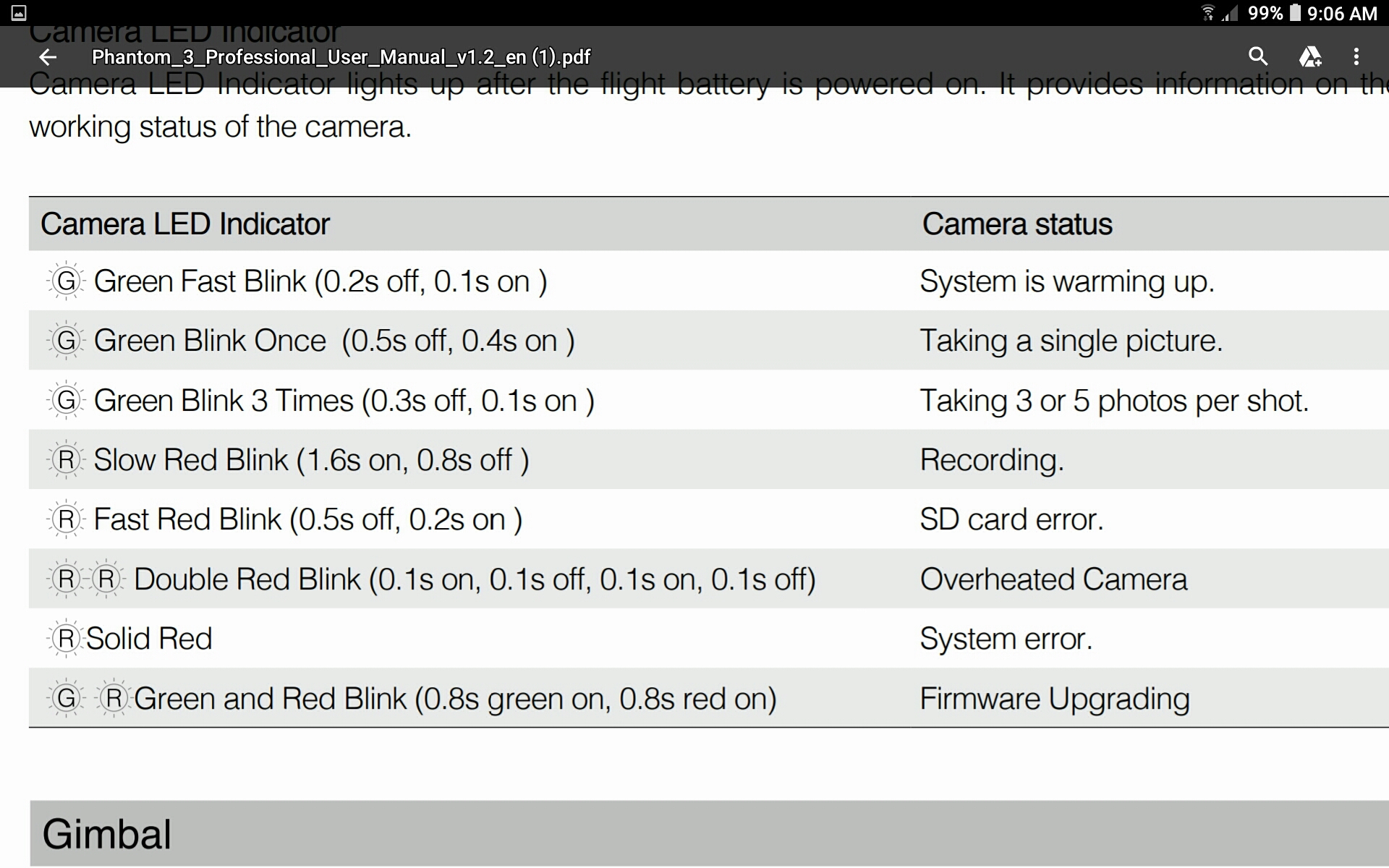

I just recently bought Hey Phantom 3 advance I replace gimbal ribbon because the gimble was going crazy .Now it's working fine But it's not showing any image my go app is working everything else works fine the led light blinks Red and green dones an one know how to fix
Which lights red and green , the remote .?what colour drone link button,green or red.you? If relinking not work was the ribbon cable set from authorized dealer cause some just don't work,cables ends vary ever so slightly and not contact proper,could also reinstall app that sometimes help to
Yes it can move normally up and down thae model is phantom 3 pro
Light charts,,ok if relinking not fix it ,,,have you tryed different sd card in cam just incase it not up to the challange
