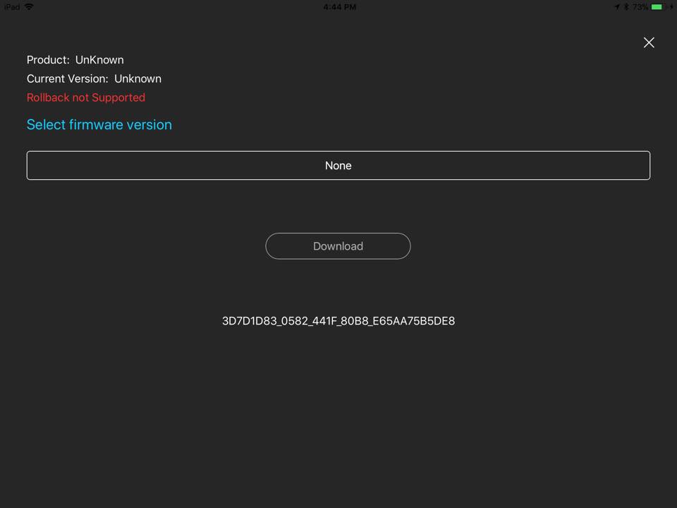

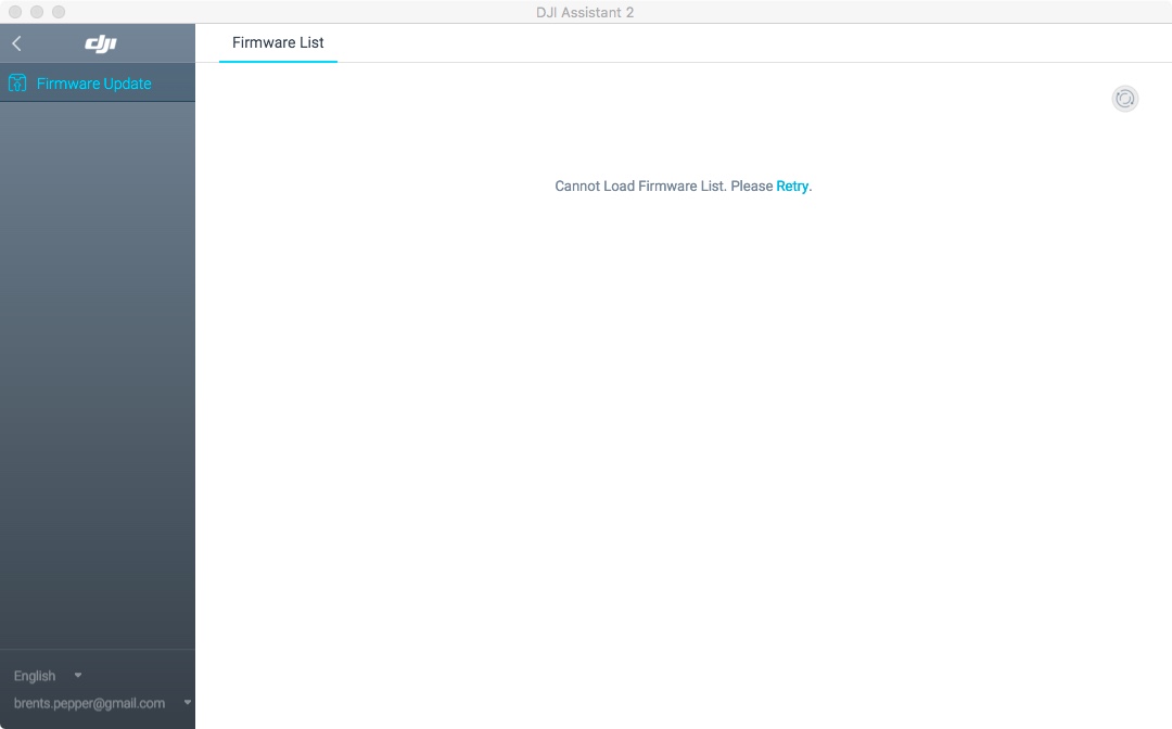

I was having an issue with my Phantom 4 remote not completely charging and the remote battery running down quickly. After some research I found out it could possibly be a firmware issue and it was recommended that I back down to the previous firmware. I did that and it seemed to fix the issue with the transmitter but I was not able to get the Phantom itself to change firmware. I was doing this through the DJI Go app on my iPad. I downloaded DJI Assistant to my laptop and reloaded the most recent firmware to the Phantom and decided I would just put it back on the transmitter and now it would let me load any firmware to the transmitter. One photo is what I see on the DJI Go app and the other is from DJI Assistant.
Any suggestions?
My transmitter would not connect to the aircraft and I thought it was because there was a difference in firmware between the two. I'm pretty they are still different, but I did just re-link the controller to the aircraft and now they will connect. Still no luck getting the transmitter to update the firmware. Attached are a couple of screen shots of what I'm seeing now.

I was having an issue with my Phantom 4 remote not completely charging and the remote battery running down quickly. After some research I found out it could possibly be a firmware issue and it was recommended that I back down to the previous firmware. I did that and it seemed to fix the issue with the transmitter but I was not able to get the Phantom itself to change firmware. I was doing this through the DJI Go app on my iPad. I downloaded DJI Assistant to my laptop and reloaded the most recent firmware to the Phantom and decided I would just put it back on the transmitter and now it would let me load any firmware to the transmitter. One photo is what I see on the DJI Go app and the other is from DJI Assistant. View attachment 92056 View attachment 92057 Any suggestions?
I did everything you did, except I deleted both go and go4 apps (have a p4 and p3p so I have both apps) and installed the go app for a phantom 3, opened the app on my ipad mini4 and picked phantom 3 standard on the go app, i pressed on the three bars on upper right side for about 10 seconds and it came up with rc firmware update. I chose update and firmware loaded and my rc was now solid blue and not that annoying green red that i have been pulling my hair out of my head after seeing for weeks, i figured I may be all set. I deleted the go app and redownloaded the go4 app on my ipad mini4 and the problem was still there rc came back to blinking red and green. I got fed up and hooked up my samsung galaxy 7 to the rc turned on the the rc, turned on the aircraft and a triangle came up in the overall status bar saying firmware update needed, I pressed it and firmware loaded and rc and aircraft where back. No more green or black boxes on screen where picture should be .
I wish they would just say use an android devise to update firmware, my whole reason for buying the ipad mini4 is just to fly (cant stand apple products)
