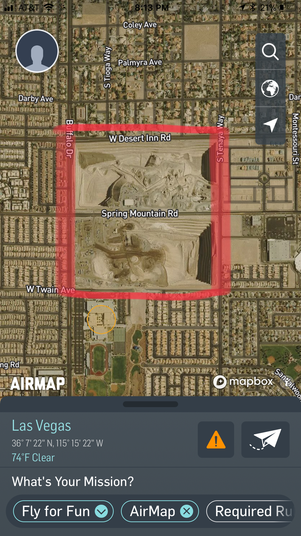

I know about those 2 but I wanted to fly down into the pit as far as I can without worrying about equipment. And I never seem to know when that pit shuts down. I don't want someone yappin in my ear about my activities there. You use Airmap app? How do you like it? I'm tempted to give it a shot because (I think) it allows you to add orbits to your missions.
Edit: Never mind. I must be thinking of another app.
