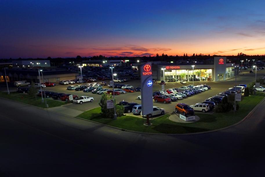

Looks pretty dang good to me for sure! What ISO and aperture did you use here?
Semi Pro here. I was a wedding photographer for 25 years and had enough of weddings. Had a P3p when they came out and was very surprised at the images. I took a night shot of a new car dealership with a 4 second exposure and I was truly astonished with the outcome. The dealer bought a 100" print which I was dubious of but it turned out proper good, even the dark areas had little noise.
I could not resist getting the P4p when I found out the camera specs but sadly its -25C here in Canada so will have to wait to try it all out. I envy you chaps that live in warm climates but the snow can look pretty on a sunny day :)View attachment 70291
nice pic, i have flown 3x 10 min flights with mine including today at -21 with no issues just keep the battery warm before you fly.
