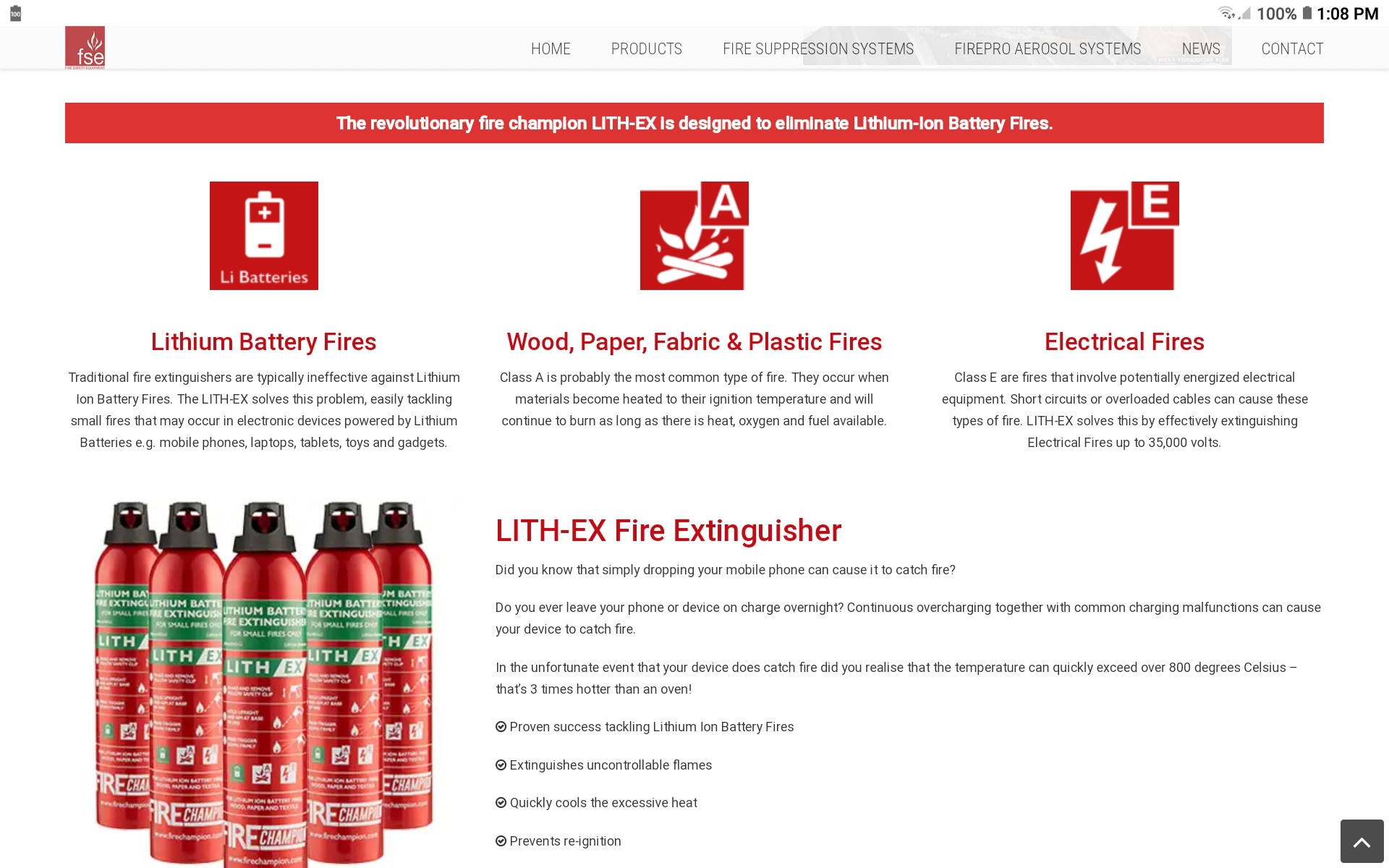

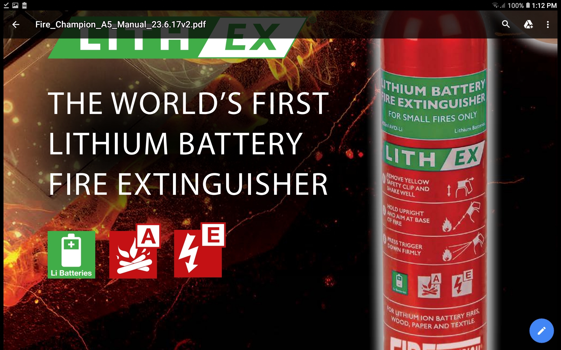

If this works it is excellent. But I don't know on what basis this extinguisher eliminates the fire of lithium bat. as this is the self generating fire with oxygen producing reaction so usual fire eliminators can't work.

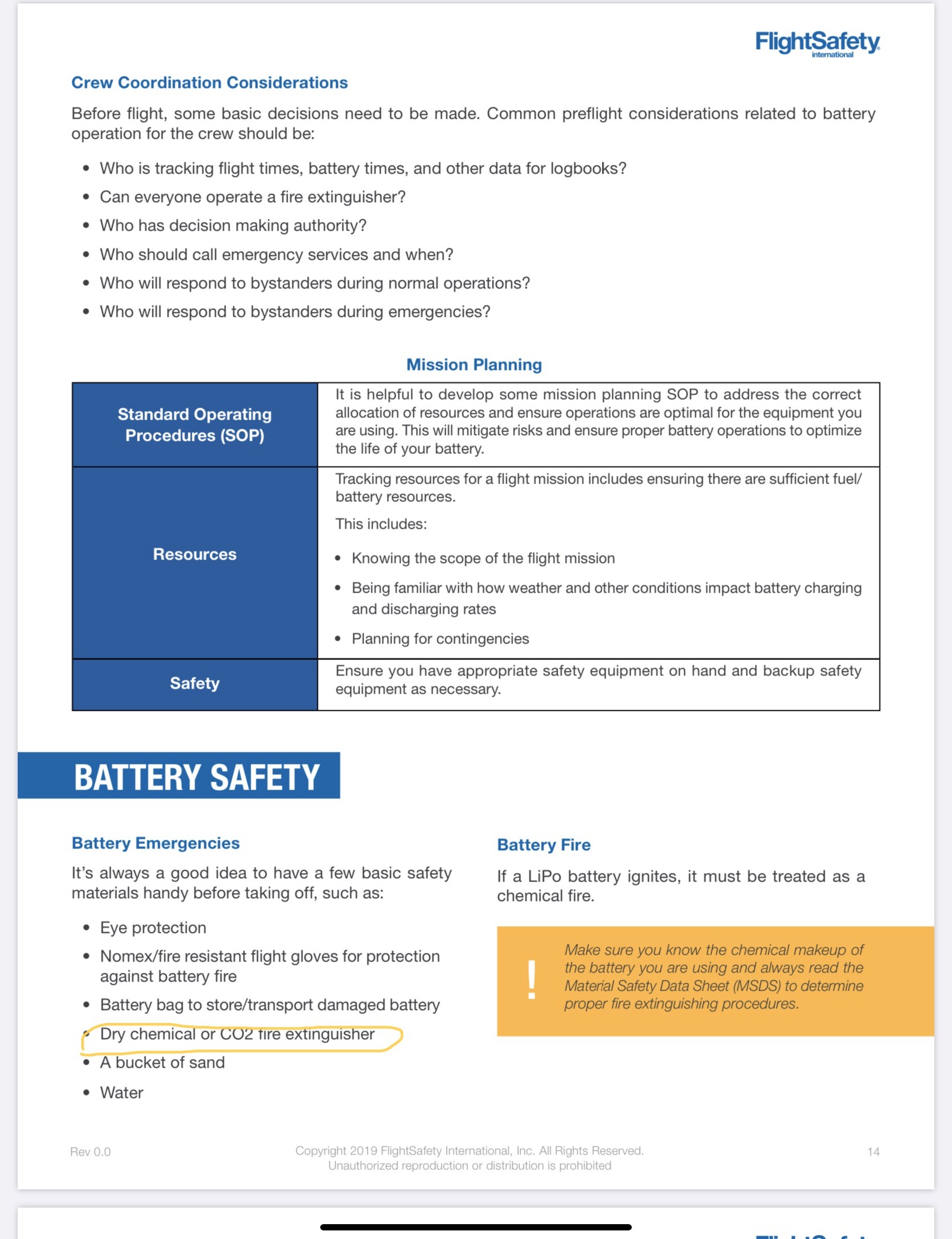

A lot of Sand is best and cheapest cooling and air tight, no cloth is tight against gas from LI-PO fire in cloud Nomex who in used in fire protection cloth
That are reason to not use or store damage battery indoor.
