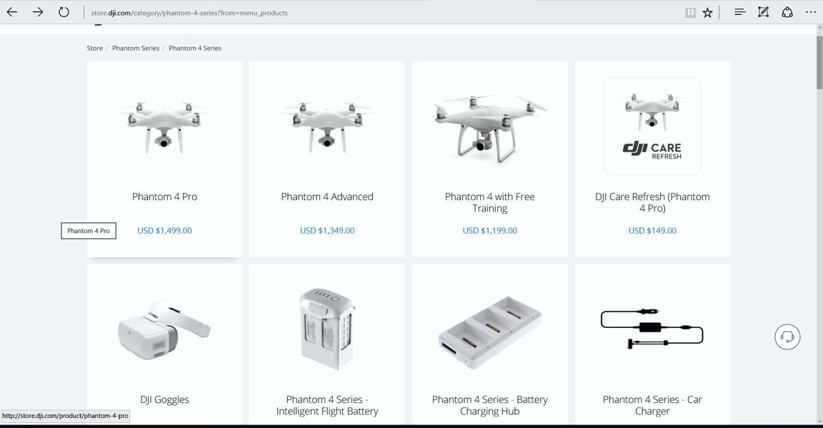

Stuff is often difficult to find on the DJI site.
In the store, under Phantom 4 accessories, this page appears:
Like I said, since I have a P4P that is where I was looking. It never occurred to me that they would not list such a product there if it was compatible with the P4P.
So Google "Phantom 4 Pro" and select the DJI Store.
No presentation of the charger.
Select Buy, Select RC type, get a list of accessories.
No car charger.

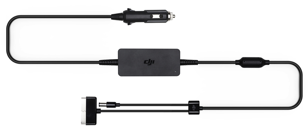

The DJI Phantom 4 chargers works perfectly with both types of batteries. Also, if you want, you can use an external booster pack that has the 12V accessory jack to charge them rather then running your vehicle. Works great. No wasteful inverter needed.

I could never get the dji in car charger to work properly, good inverter sounds the only way to go
Snowwolf, you must have a bad unit or there's something about your car. I've even used the 3 charger bay with mine without issue.
Think my car may have an intelligent charging system and may have been causing the cig lighter to drop to 12v often, think it would have been better having a direct socket put on the battery, other people may have the same problems with modern cars.
Was the engine running or stopped? Stopped the voltage falls quickly when there is draw on it.
I have a 2014 Toyota. My only limitation when I use the car charger is that the 12V socket shuts off when the key is off. This is why I use a booster battery that has a 12V socket to charge them when it is off.
Hi all. I was thinking that I had a faulty p4 charger as well. I have a 2015 model Toyota Hilux, I did some checks with my multimeter and as it turns out, the battery never stores more than 12.3V but it reaches 13.4 once running. The p4 charger has a minimum requirement of 13v to charge. If I turn off the vehicle, the charger will be lucky to stay charging for a minute or so. It really pumps in the current hence the quick voltage drop from the car battery. I have a second 160a/h deep cycle battery with a dc-dc charger, but even this at capacity is around 13v....so yeah, the p4 charger cuts out quick with this option too. I either need to keep the car running or I'll have to invest in some decent solar panels.
