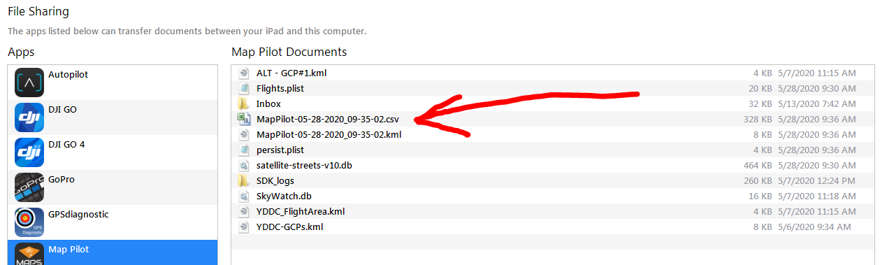

Yes and no. The flight logs I use are stored on the iPad, and not the FC. Simply copy the .kml and/or .csv files from your iPad to your PC via iTunes or a third-party app like iMazing. The example below is MapPilot, but I'm sure Litchi has the same option.
Then simply open the .kml file in Google Earth. I use Google Earth Pro, which is free.

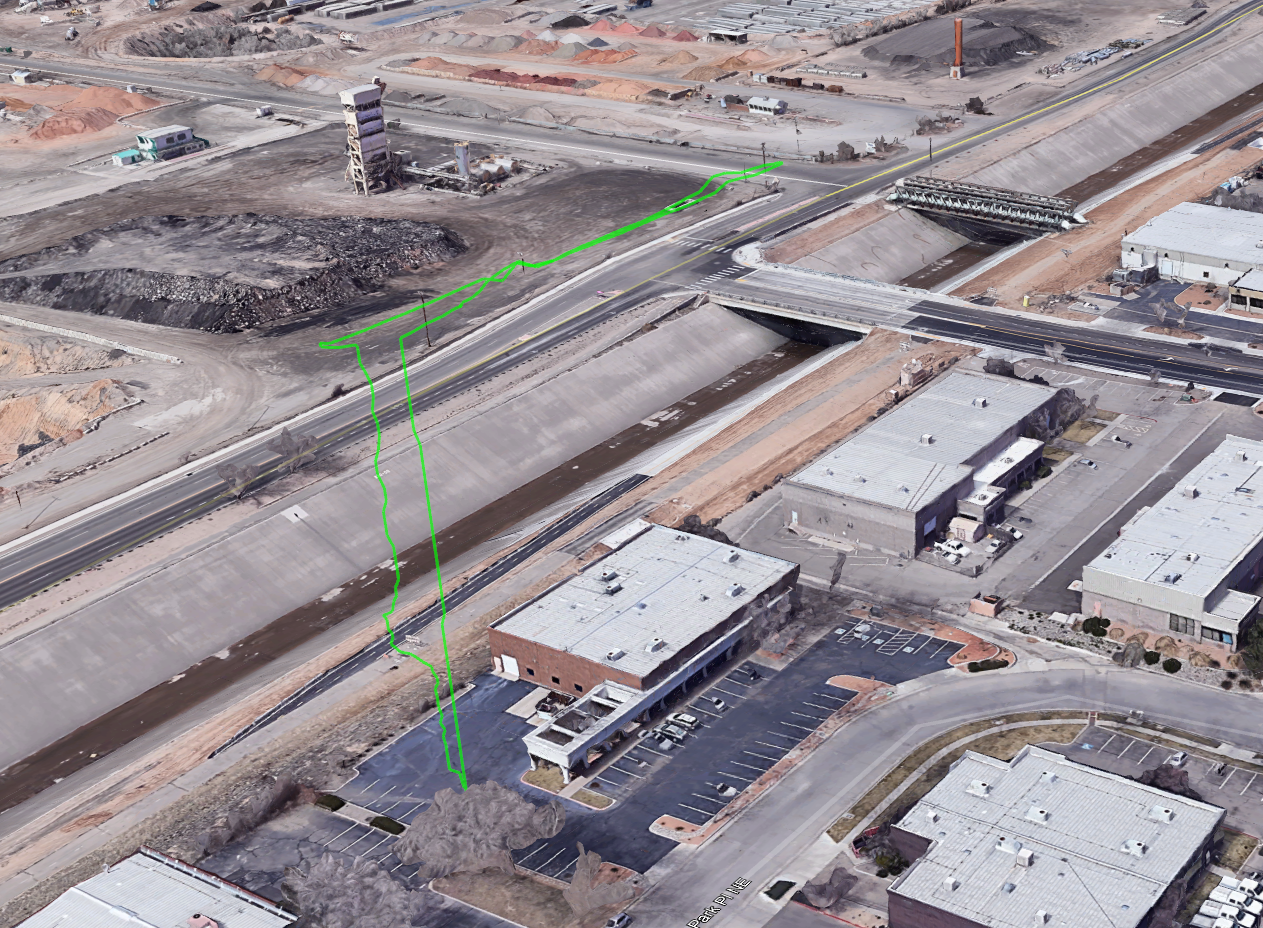

This mission was just a quick test mission.

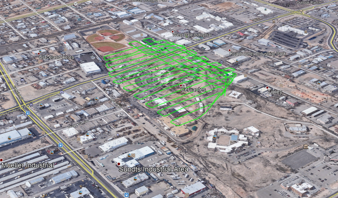

Here's a screen shot of one of the actual missions. This mission had a battery change, so this is just half the mission.
