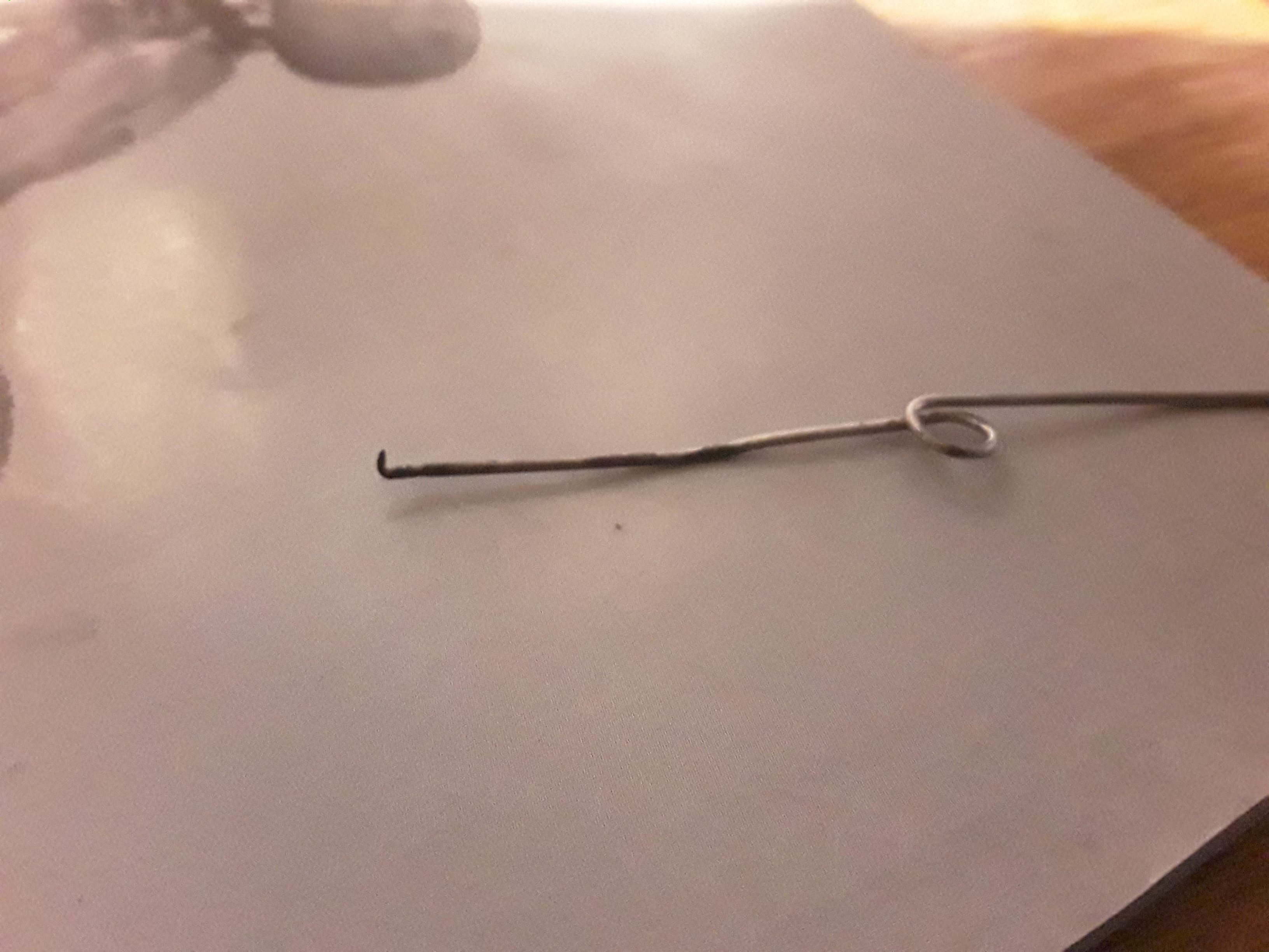

1530735611820941409971.jpg mayby a couple of needles bent at ends to work as pics,if no luck , a watch maker will have some fine tools if ask nice,,
