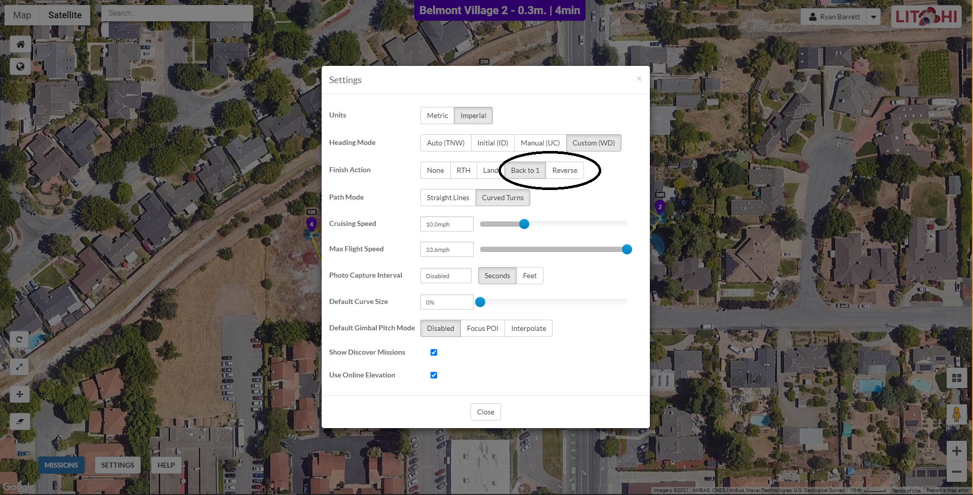

Using Litchi, place your waypoints. Then in SETTINGS / FINISH ACTION, select either BACK TO 1, or REVERSE. That will set up a loop flight program that will only end if you select SPORT mode, or hit RTH.

If finish Action is set to "Back to 1" the AC will fly in a straight line from the last waypoint to waypoint 1.
If Finish Action is set to "Reverse" the AC will STOP at the last waypoint until you pull the right stick down, the AC will than fly BACKWARDS to each waypoint in descending order as long as you hold the right stick down.
