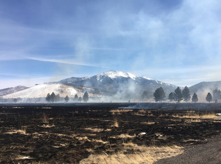

I lived in Flagstaff for 20 years and know the area well. Can anyone tell me how an electric powered drone approximately 16" X 16" could catch on fire by crashing in a grassy field?
Drone catches fire, ignites wildfire north of Flagstaff - Wildfire Today
It's not out of the question for a battery to become damaged and short out during a crash. Our batteries have a LOT of stored energy and when released quickly produce a LOT of heat. I have a LiPo battery terminal "weld closed" and the resulting energy discharge literally melting the asphalt where i tossed the battery.
