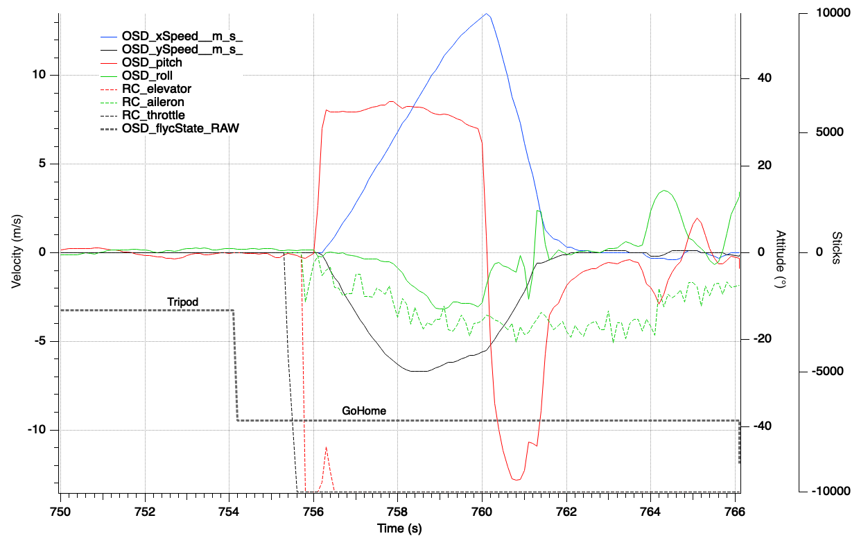

I was flying through a forest, narrow sensing assign to c2 button. p4p stopped due to obstacle, narrow sensing wouldn't react, height 5 ft, distance about 200ft. Couldn't get the p4p to move. Battery dropped below 30%. Pressed and released c2 button several times. Nothing. So I turned off the obstacle avoidance in the go app menu. Then I could move the drone, flew past the obstacle and turned it around to fly home. That's when the auto RTH countdown started, I tried to land within 7 seconds. Drone wouldn't react. Then the p4p decided to commit suicide: it took off in the opposite direction at high speed and crashed into a tree.
If the p4p doesn't react, is it my fault? I uploaded the flight record.txt here:

It did not take off in the opposite of its own accord - it did so because you applied full reverse elevator at 755.7 seconds, 1.6 seconds after it switched to RTH. It appears to me as if you panicked, because you pulled back on both sticks when you tried to make it land. That crash was pilot error.
