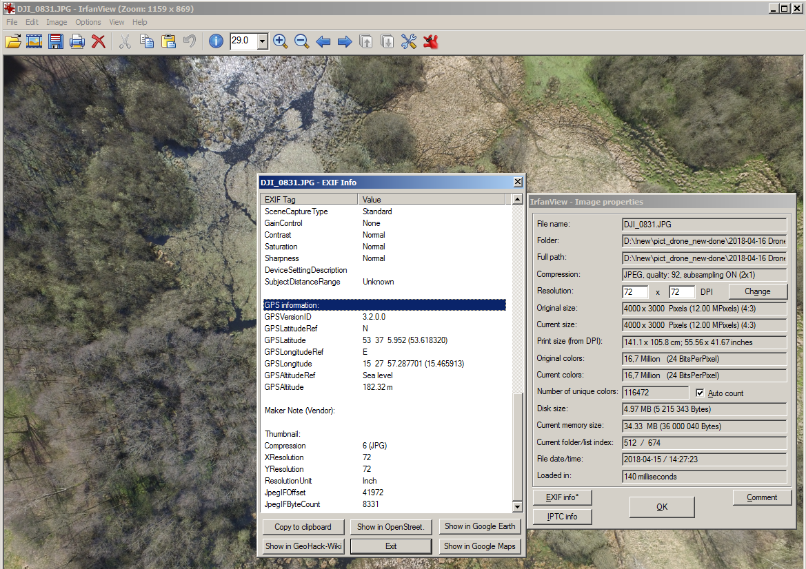

DJI drones store coordinates in JPEG EXIF format. See Exif 2.2 format specification for all the details.
