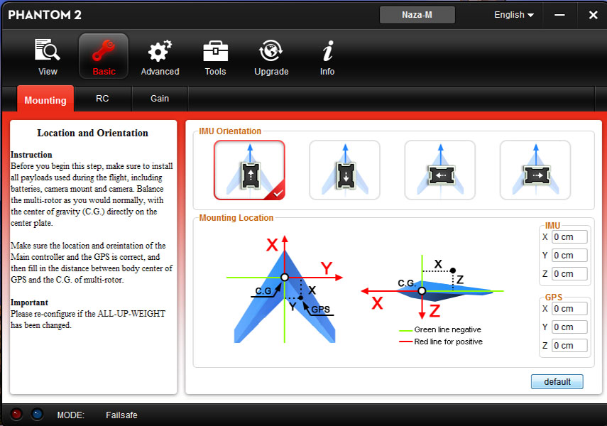

I was looking on the PT2 under Basic and Mounting and was wondering if I was suppose to change the settings for the IMU and compass location or leave them all at 0cm. If I do need to change it I was going with;
Compass
x 5cm
y 6cm
z 15cm
IMU
x 0cm
y 0cm
z -1cm
would this be correct?
Compass
x 5cm
y 6cm
z 15cm
IMU
x 0cm
y 0cm
z -1cm
Put those settings back to 0 as in this screen save.
To do so by typing in in 0 in all six then hit enter
will do Right now. Thank you

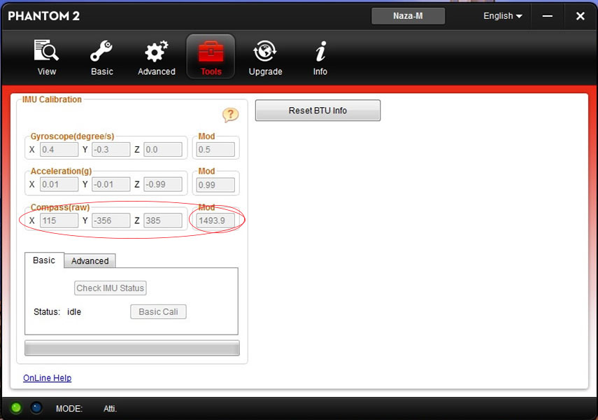

The advanced IMU MOD calibration should be between 1300 and 1600 and anything higher then that will cause flight problems no matter how how many time you do the compass (dance) calibration.

well just today alone while just sitting in the shop it has been around high 800-low 900 and now its showing 1006.3.

Since you're on a computer why not post a screenshot of the advanced IMU. If the compass MOD is that low i'd say you have a problem.
