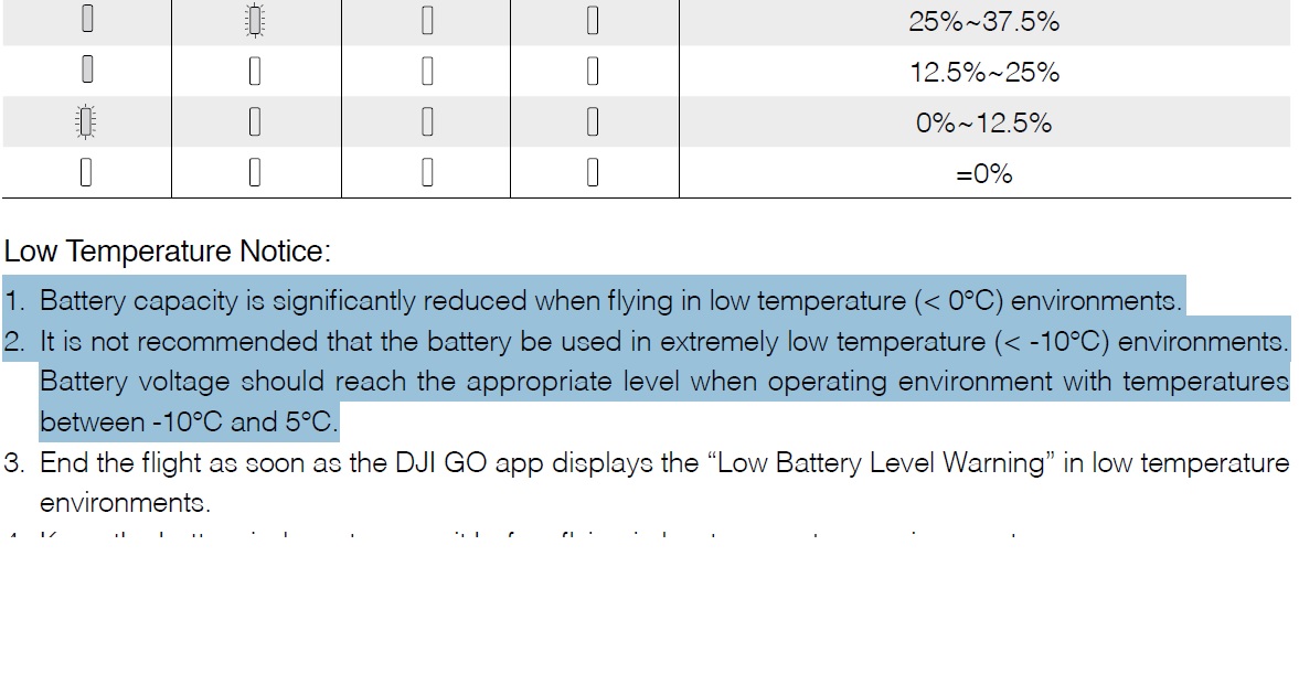

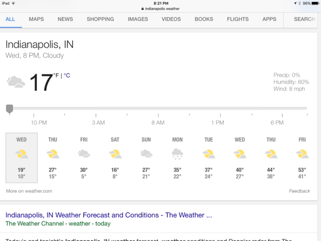

Frank, your profile says Indy.. Maybe this is why? View attachment 43510
Yeah, that's right. I'm in a cold climate part of the year. I would have to live where it stays above 70 degrees to not have any crippling from the not so smart battery.
You should stop complaining so much, let your battery warm up to 24 degrees celsius before you take off, I have not been "crippled" at all by my battery during cold weather. Keep in mind that DJI has a stated operating temperature which you should not fly when it is colder than that or at least you should not complain if you do.
