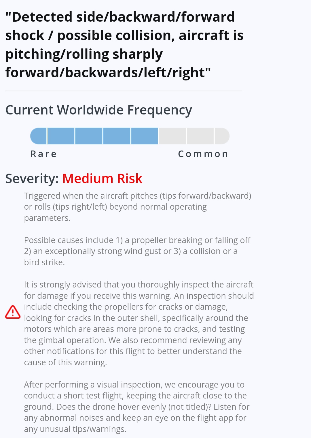

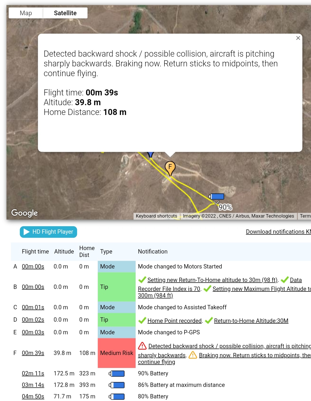

hello pilots.. its been few days since ive noticed a weird warning about a shock detected midflight and a sharp pitch or roll.. there was no such a thing.. airdata says someting about collision.. no collisions.. no obstacles.. no birds.. no weird attitude noticed..
can somebody explain what happened??
thanks a lot!! 🙏

At 0:39.0 you were flying southeast at 8 metres/sec, 57 metres above the ground.
The drone was tilted forward at 13° when obstacle avoidance suddenly tilted back 55° and brought the drone to a stop.
There was no change to the roll or yaw data which suggests that the drone never actually hit anything.
It looks like an obstacle avoidance false alarm.
The message about a possible collision is Airdata's mis-interpretation of the data.

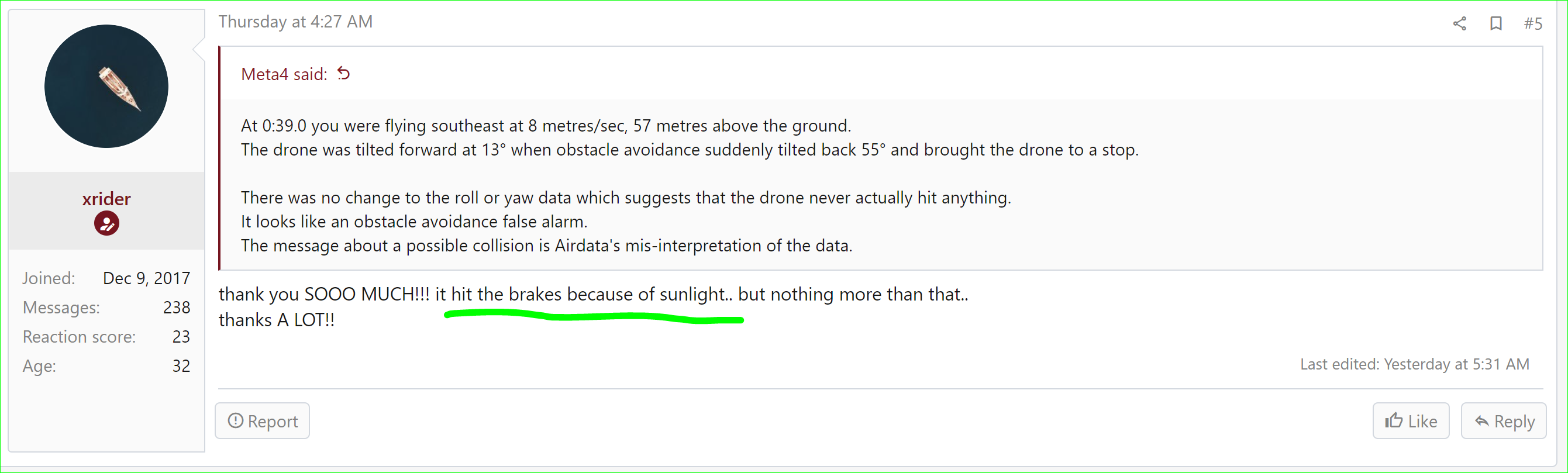

thank you SOOO MUCH!!! it hit the brakes because of sunlight.. but nothing more than that..
thanks A LOT!!
This happens usually when the sun is close to the horizont and the cam is facing directly to it. Sensors false trigger avoidance collision and stop the drone.
Happened to me several times.
Just turn the camera a little downwards and it will be ok.
