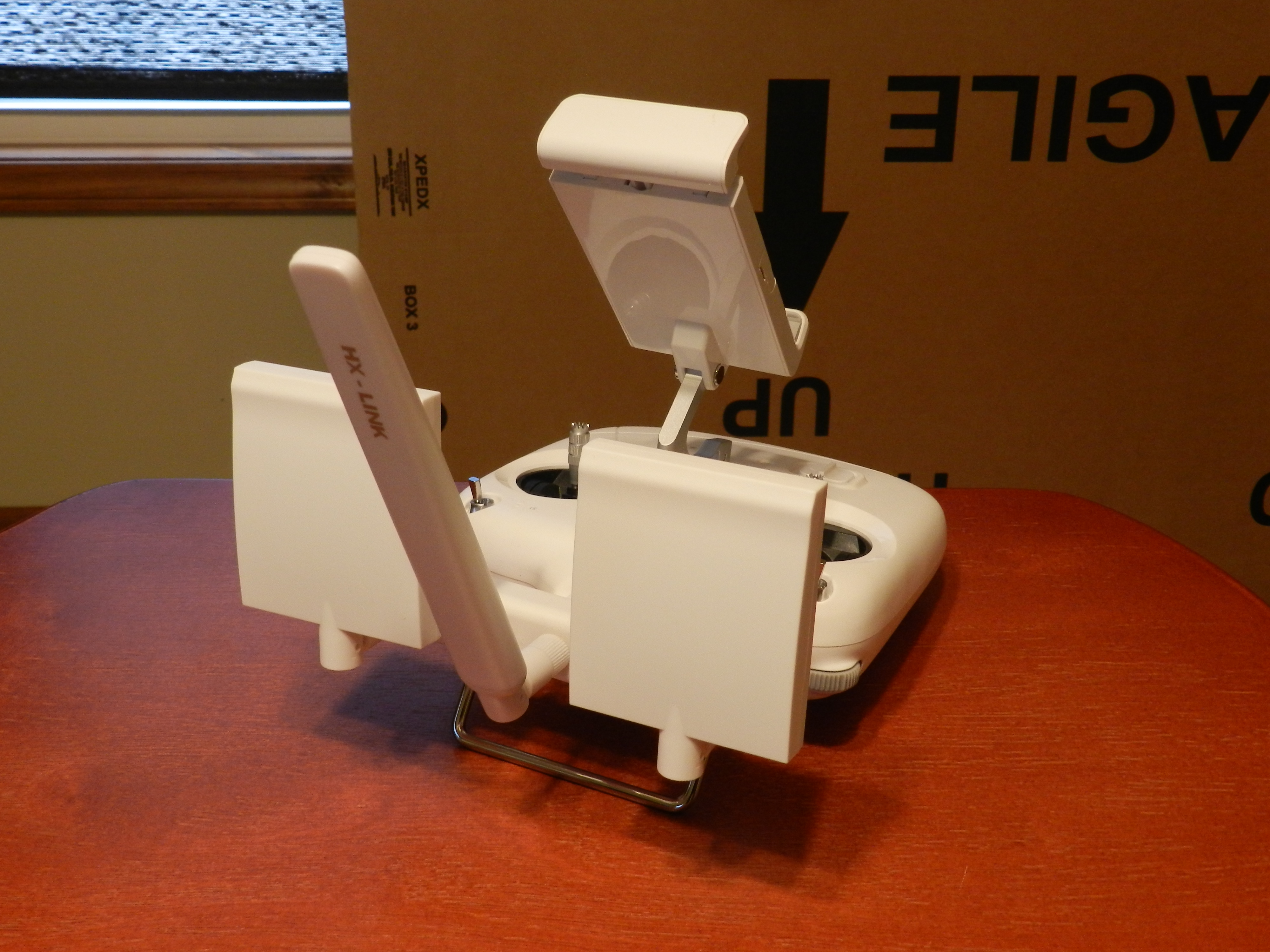

Well, didn't have much to do today so I installed the ARGtek mod to my Standard controller this morning. I took it out for a spin. This is what I got:
2 Runs
Alt 394 feet for both runs
Light wind. 22 degrees F
Over open fields. No obstructions.
1st run was 3800+ feet before I lost signal. (north)
2nd run was 4500+ feet before i lost signal. (west)
Video was good throughout the runs. Seemed to get a little jumpy as I got close to landing but I think they may be the antenna. I am still playing with the placement for best results.
All in all, I am very happy. I am never really going out that far anyway. I just wanted to make sure I got FPV the whole time.

Correct. Range improvement was minimal to none.
FPV was much better. I had video the whole time.

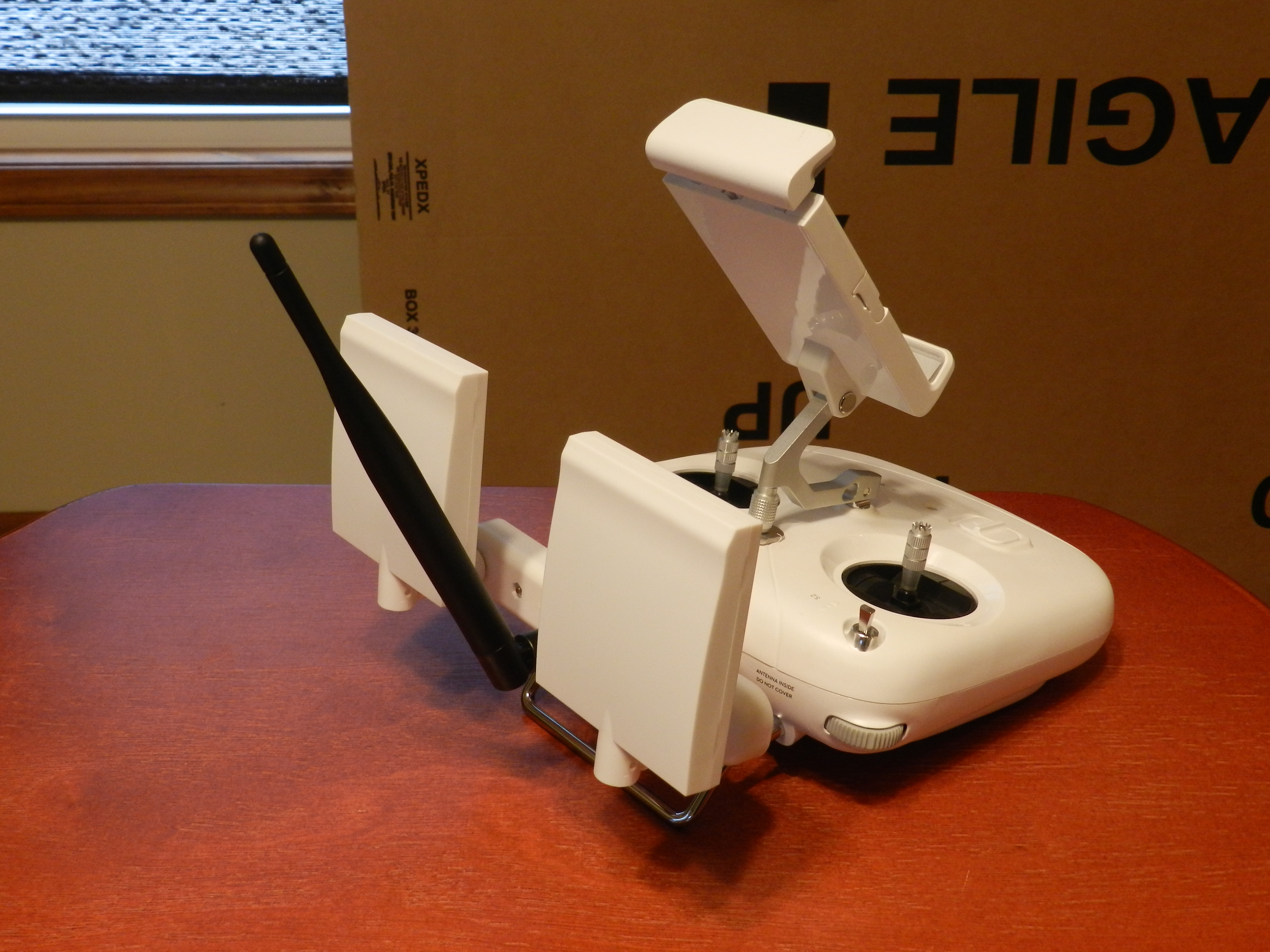

Was going to try and do some flying today and change a few items.
Positioning of the 2.4G antenna for video. Want to try them in another position. Turn them, move them up and down.
Also want to try a new antenna for the 5.8G (control). Purchased it a couple of weeks ago and I want to try it out. Just unscrew the ARGtek antenna and put the new one on and test.

DSCN0126.JPG This is what you get with the ARGtek
DSCN0127.JPG This is what I want to try the next time.
