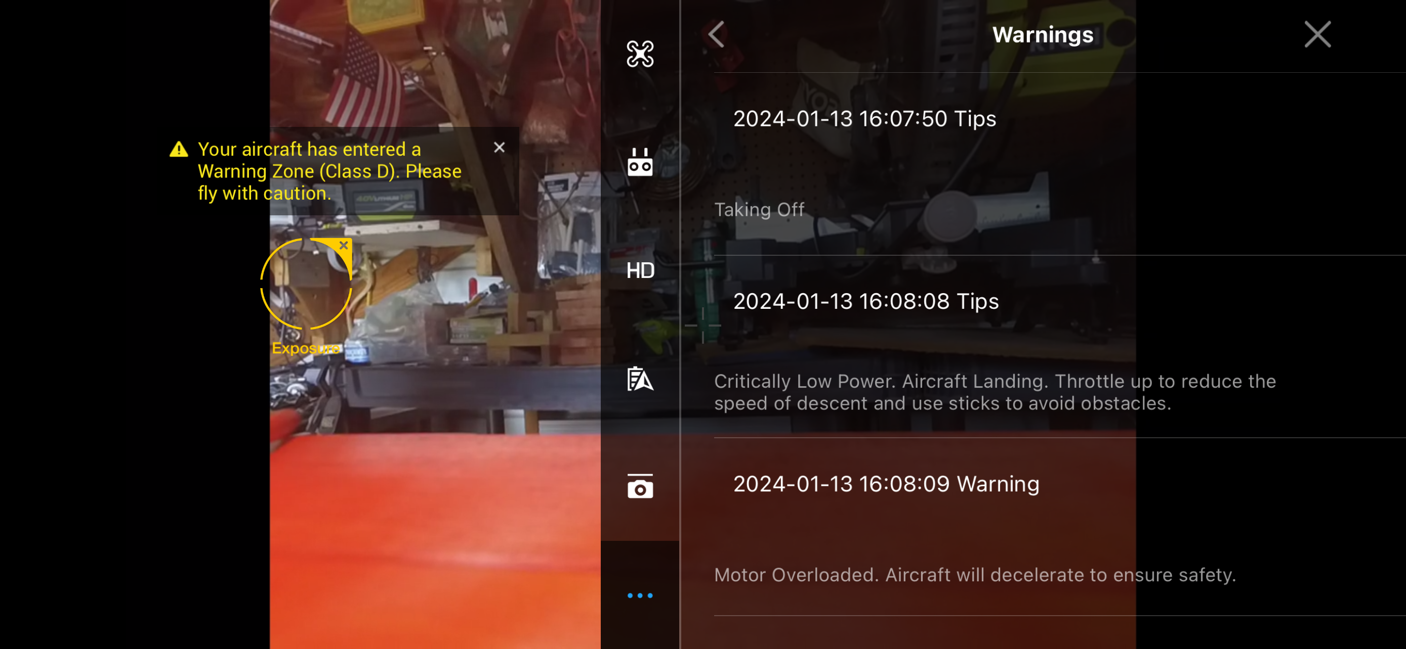

After hovering for about a minute I get this these warnings

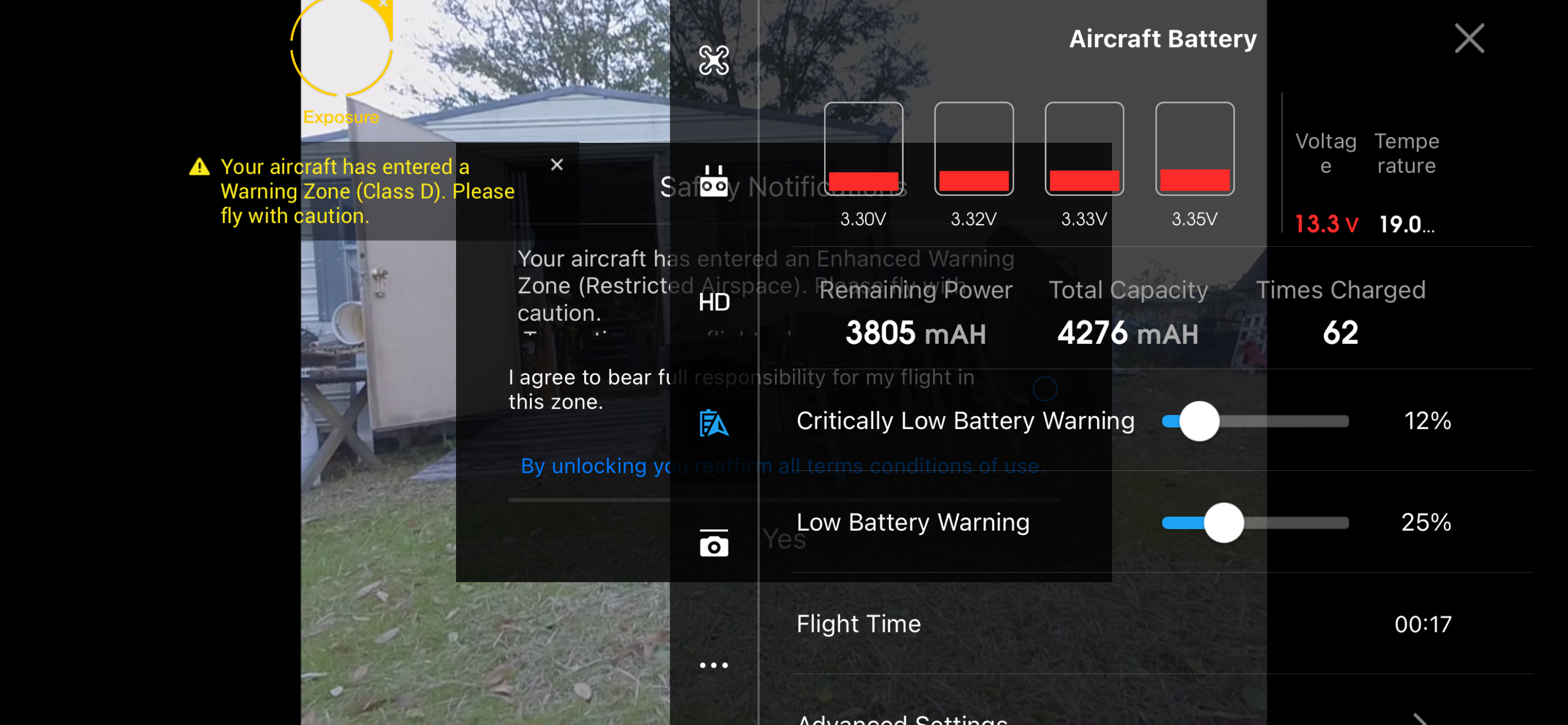

Under your warnings,what does "tips say" anything about battery temp,,I dont think these warnings are from cold battery, Sure looks like this battery needs a charge, always fly with full battery or it start predicting things for you,some things can change based on battery voltage always full battery on launch or testing

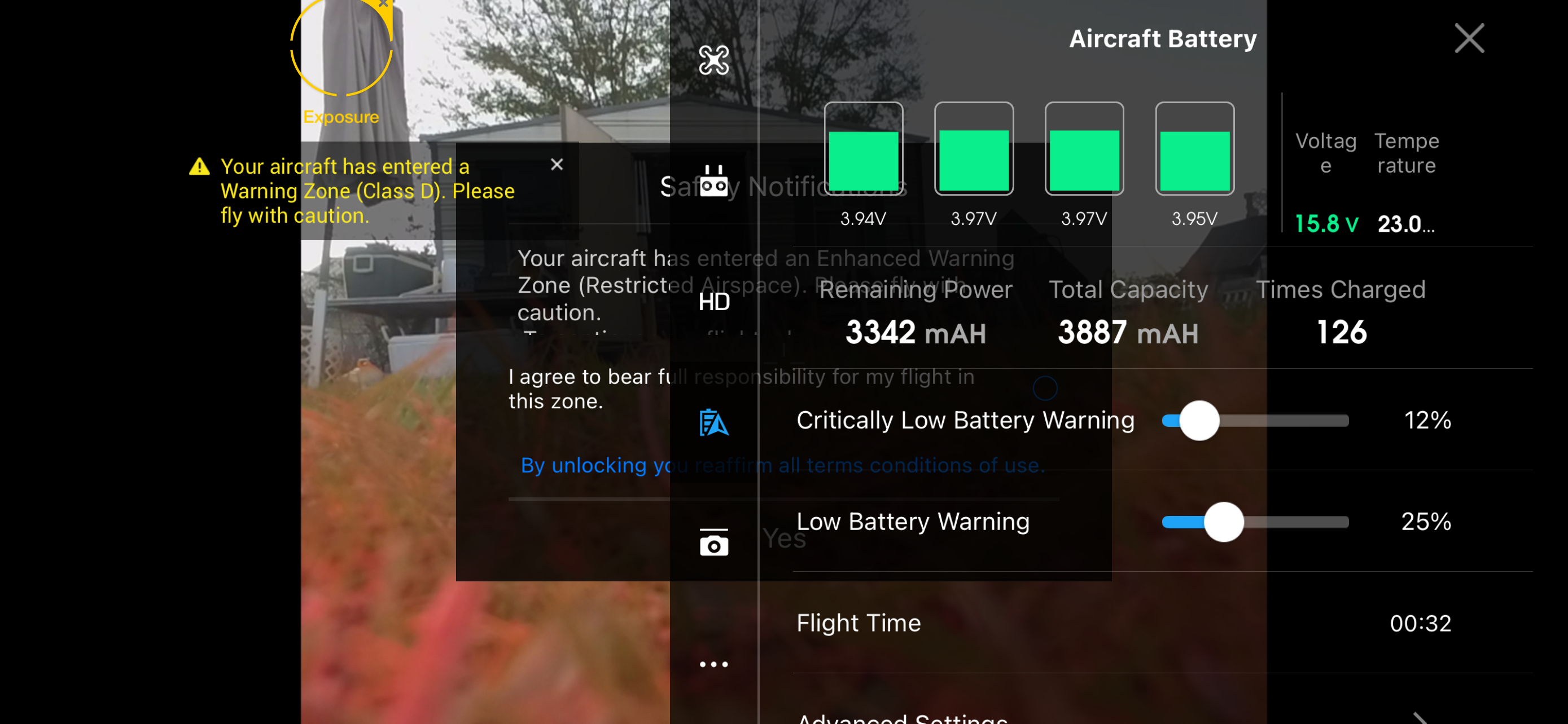

After I let the battery warm up I had no issues. The last picture I took of the battery after warming up . I tested my three other batteries, after they warmed up the critical low voltage warning didn’t show up. I will keep my batteries out of the cold shed . I think the voltage draw on cold batteries is what triggered the critical low voltage warning.
