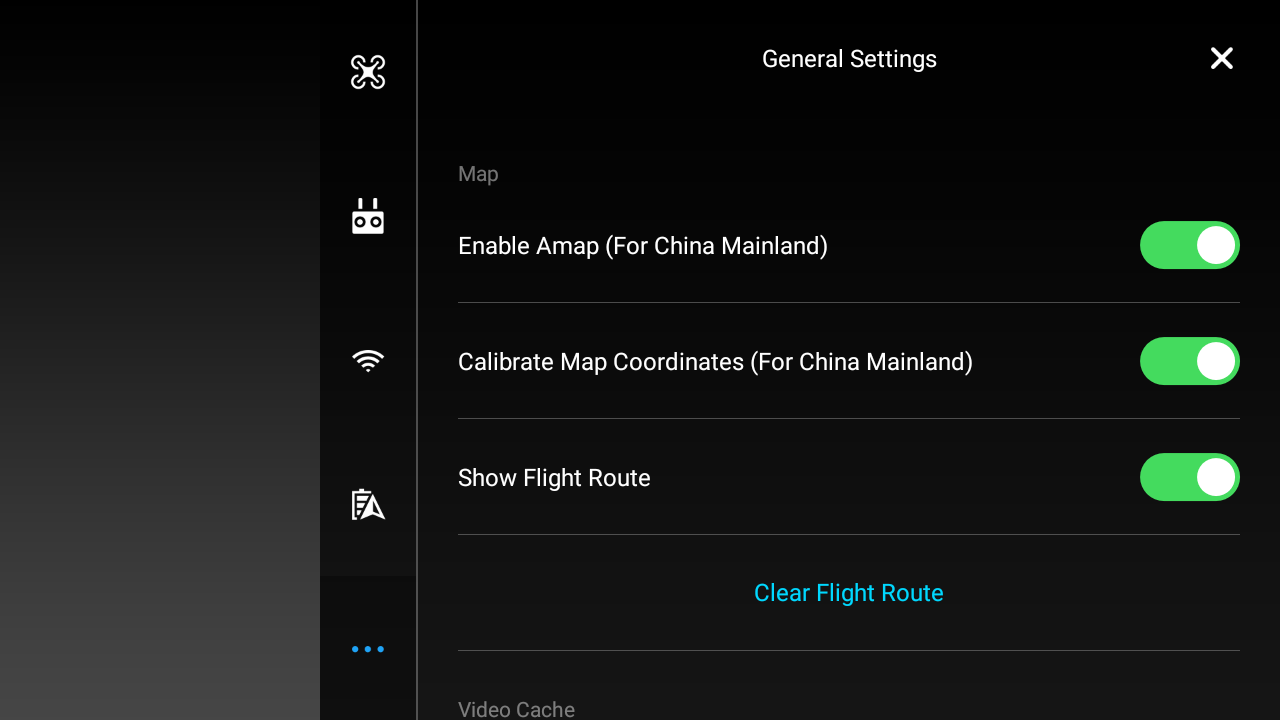

HI green light good sign,,,checked your settings in general settings,,is you enable amap (for mainland china) ..I read something like this yesterday to do with caching maps,,:)
