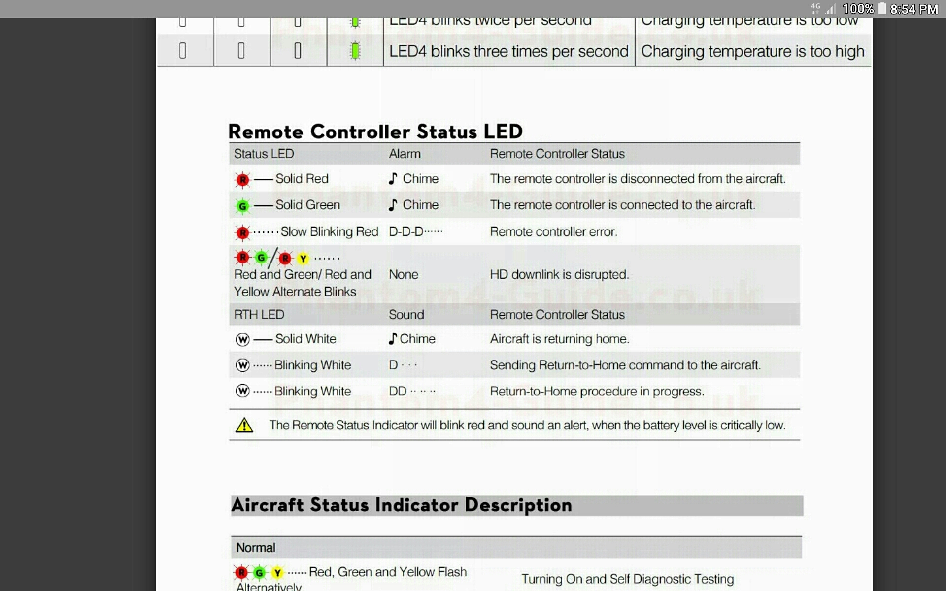

Try rc stick calibration,which p4 or p4p,,played with usb cords,could be at fault aswell,,light chart above incase
