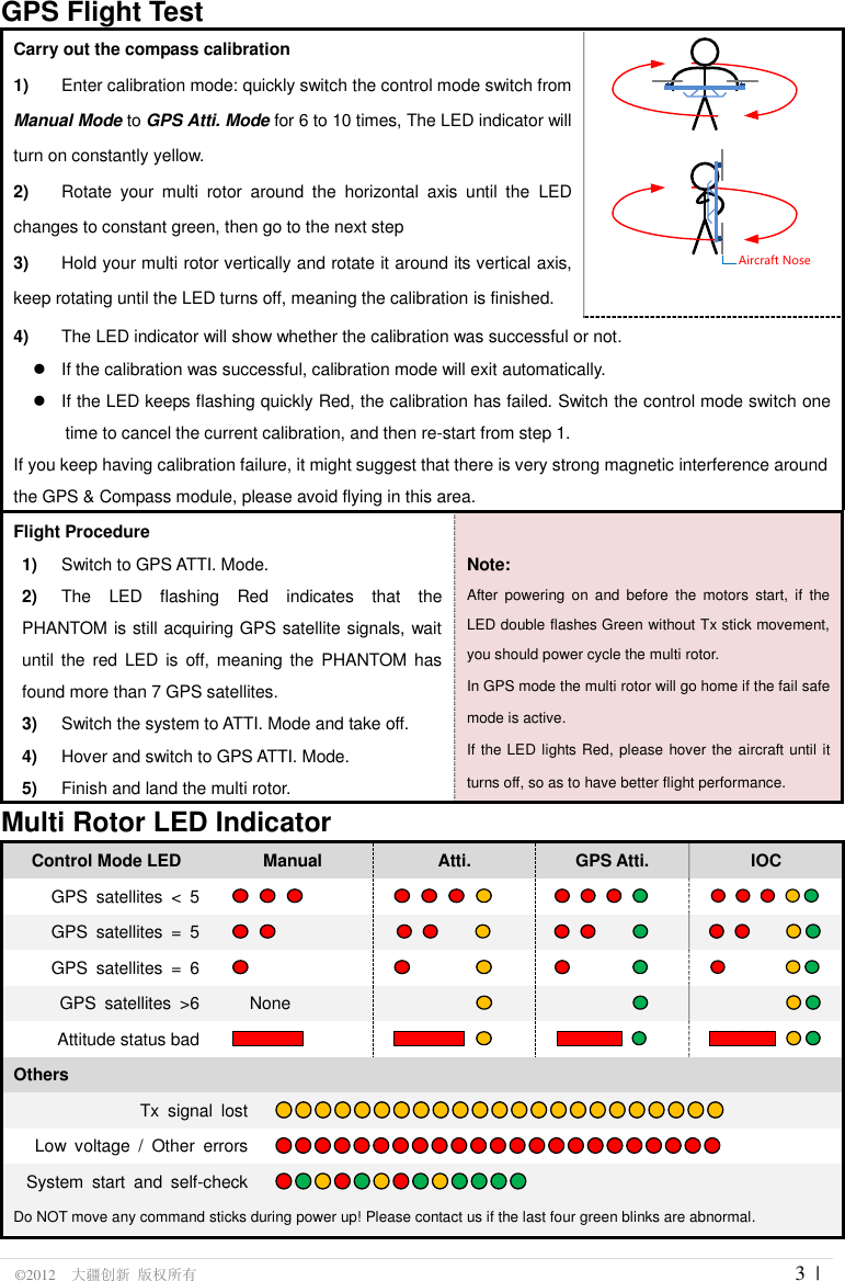

This should have everything you need to set up your NAZA-M V2 controller . This is the controller P1 uses .
Hope this will help.

You might not want to update the software on the Phantom one because it's so old it's not going to probably fly with all you need to do is Flip Your F2 switch seven times up and down to and then rotate the Drone connect to the satellites calibrate it to the compass on your remote
And a diagram down below that the other man posted is what I'm talkin about flipped the switch up and down seven times and then rotate the Drone like it shows in the pictures below
