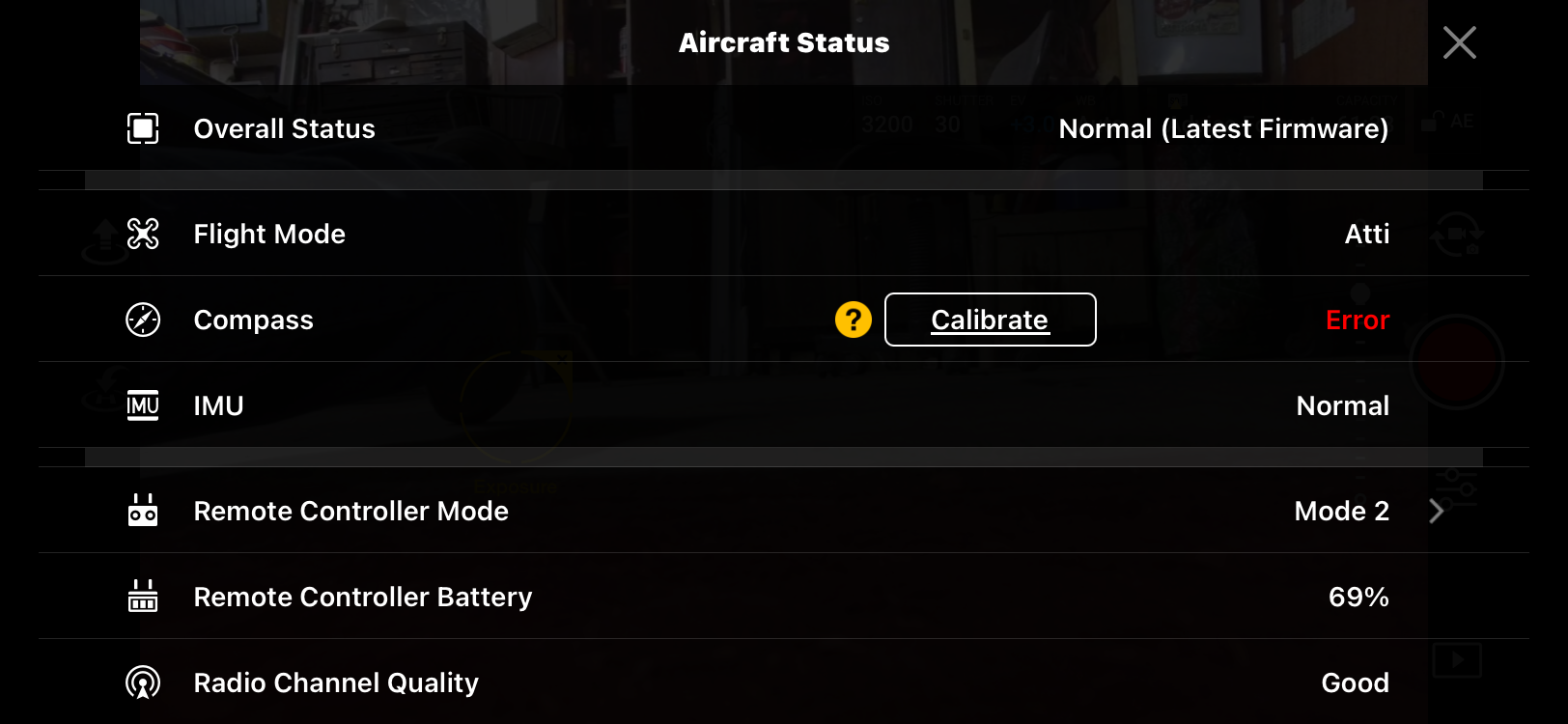

Hello I’ve got a DJI Phantom 3 pro can’t get it to fly. Keeps saying calibrate compass!

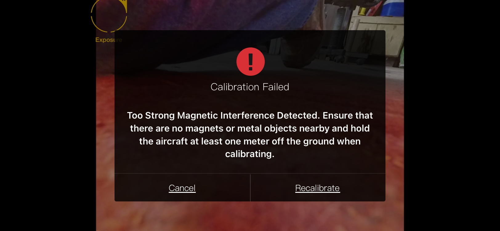

I’ve tried recalibrate in different places. The drone on the screen doesn’t change colors
Or a big wrist watch ⌚maybe ha anyway in app go to your sensors ( compass) and see what it's doing. Compass on landing gear No reading might indicate broken compass wire or bad soilder joint but sensors chart will show numbers calculating between certain range and show differences if I remember a little bit

If you have the message suggesting compass calibration but the compass won't recalibrate, it could be that your compass isn't connected.
You can easily confirm this by checking the compass data on the Sensors section of the app.
If it looks like this with numbers in the boxes for compass data, that means the compass is connected and working.
But if there are no numbers for compass data, that's confirmation that your compass sensor is disconnected.
The solution could be simply fixing a loose connection or you might have to replace the landing gear which contains the compass sensor.
