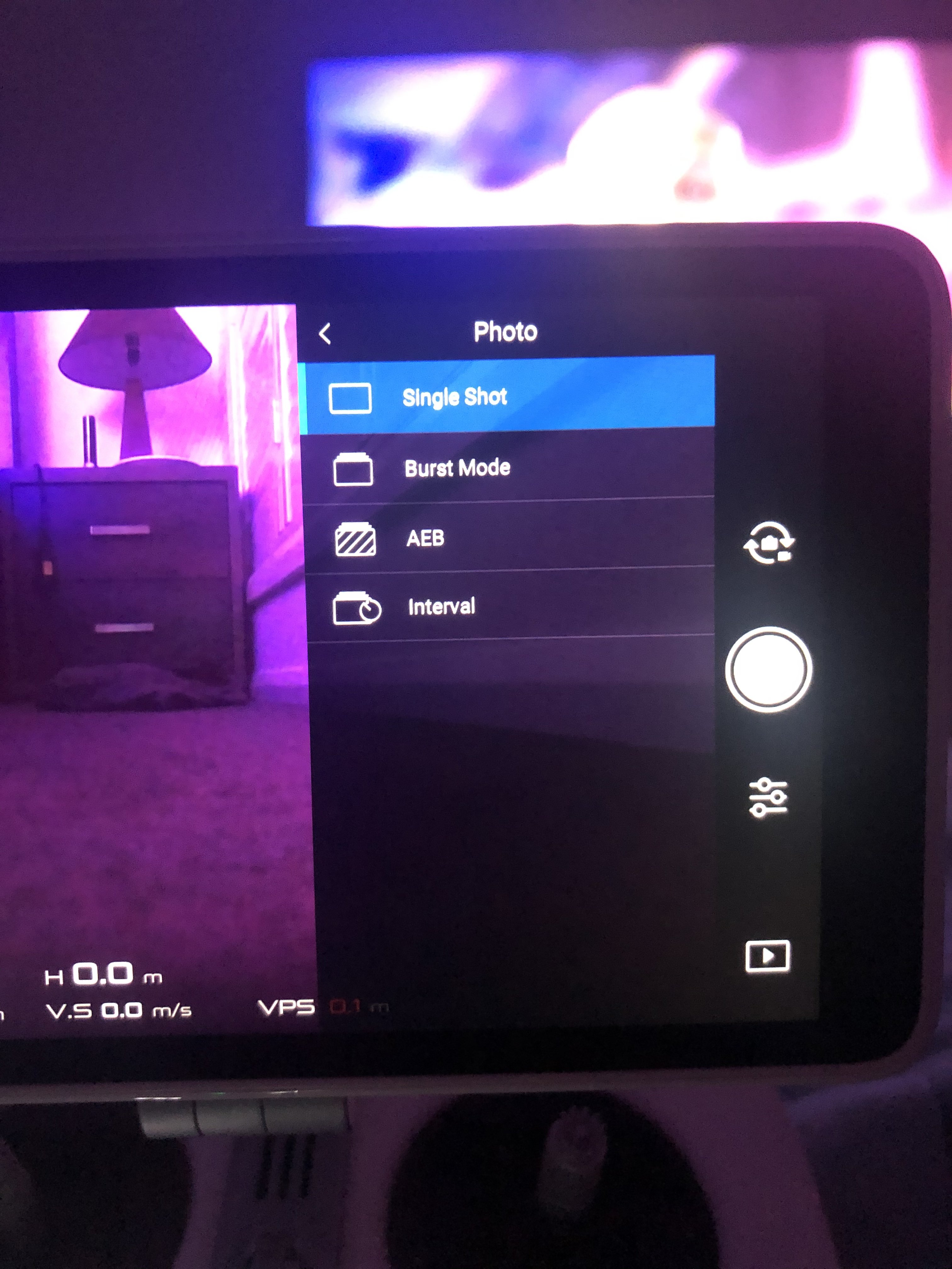

My phantom 4 pro usually has the panorama mode available but today my pano mode was missing, tried in p-mode and all and it has simply vanished. Can anybody assist with this?

First off I have Single shot, multiple, AEB, Timed and Pano once all is up and running.
When I just had the controller on I get HDR Shot and lose Pano but keep single, multiple, AEB and Timed. Once I turn on the Phantom and it connects with the controller Pano comes back and HDR goes away. Strange. Try powering up the controller, then drone and finally the app. Sometimes mine will show all options but if I shut down the app and restart it, it comes up normally.
what display are you using? I'm on an IPad with the latest updates and Go 4 app.
