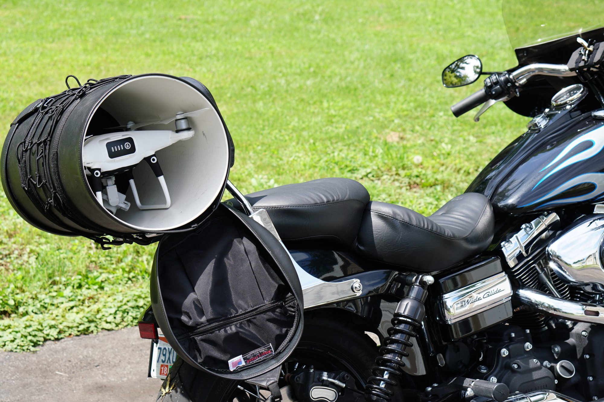

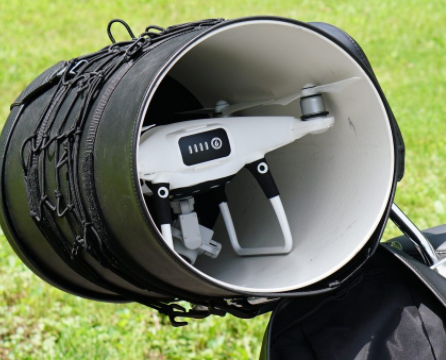

We carry the drone , and take it everywhere and I mean and any way we can. See pic below , and we have never had an issue with the gimbal , so that is one less problem not having to worry about the cover.

I like your motorcycle tube carrying method. Ready to fly with props installed is clever. However, without the gimbal lock installed inside that tube, every dip and bump (railroads tracks, speed bumps) you hit will push the landing legs together with the slick interior wall surface, it appears. If it had a flat floor it wouldn't be an issue. If you had the gimbal lock installed it would prevent undue stress of the legs being pulled together, while steadying the gimbal from swinging about, flaying all around uncontrolled. This would be especially helpful on dirt roads if you ever get up into the hills.

I assume you have no problems with vibration from your Harley. I’ve been wondering about throwing it in my tourpak in the case. Now if the weather will just cooperate.
