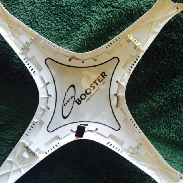

    Hello all!
    Saw this Buzzcam GPS Booster on the kitchen table (Thanks Simon) that looks pretty cool and I was wondering how anyone that has one likes it. My neighbors and I all have 1.5 acres or more but there are a lot of large old trees around and when I want to go out for a quick fly around on occasion I have a hard time getting 7 satellites at ground level. So I end up going up 75 feet or so until I do get a GPS lock even when my GPS Plan App says there are 12 or more available. Don't really like doing that and it would be great if this simple mod would help out. Any feedback would be greatly appreciated.

    Especially if you work on your P2, some of the shielding surrounding the GPS can get frayed/loosened/etc, exposing it to more interference from electronics.
    Open and check if this is the case. I'm in Philly area too, and I've never had any GPS issues. Sometimes it takes a while to acquire enough satellites if you are right by the trees. It's not nearly as quick as my P3 in getting satellites. But it gets there. 2 minutes max.
    IIRC, some people have done the same "mod" by just using some aluminum foil and making sure the original shielding is properly secured in place.

    https://www.google.com/url?q=http:/...ds-cse&usg=AFQjCNFw5ewWwpop9Y6VgA0uof3pPEj69w There's a template in this thread that makes it easy if ya want to try all the different ways to improve your GPS and says it's for the copper but ya can use the tinfoil instead. I have even used both at the same time just to see if that gave me even more . I have found many of my mods in the P2V+ section as they basically the same except for the camera's and the way they receive the Wifi signal . You also can change the antenna on top of your GPS puck and has helped some and tried that but it didn't change anything with mine so I just went back to the stock one . What ever you do I found that it is good to put a little hot glue on the side of the connecter that goes to the GPS just to make sure it stays tight as that has caused some to have issues .

    Thanks Dirk. I've never had more than 11 at one time that I have noticed. I regard to your other post thanks for the advise and I think I'll go straight away to the Buzzcam insert. Can't beat the price or the ease of installation. ;)

    Well after I tried all the other ways and they did work I just found that one to be the easiest and like it . I wasn't really having any
    issue to start with but just trying different stuff cause that's what I like to do .I guess where you at has a lot to do with how fast you get sats but here with that by the time I have powered up everything and get the app open I normally have around 8 or 9 . and then as I go up so do they .
