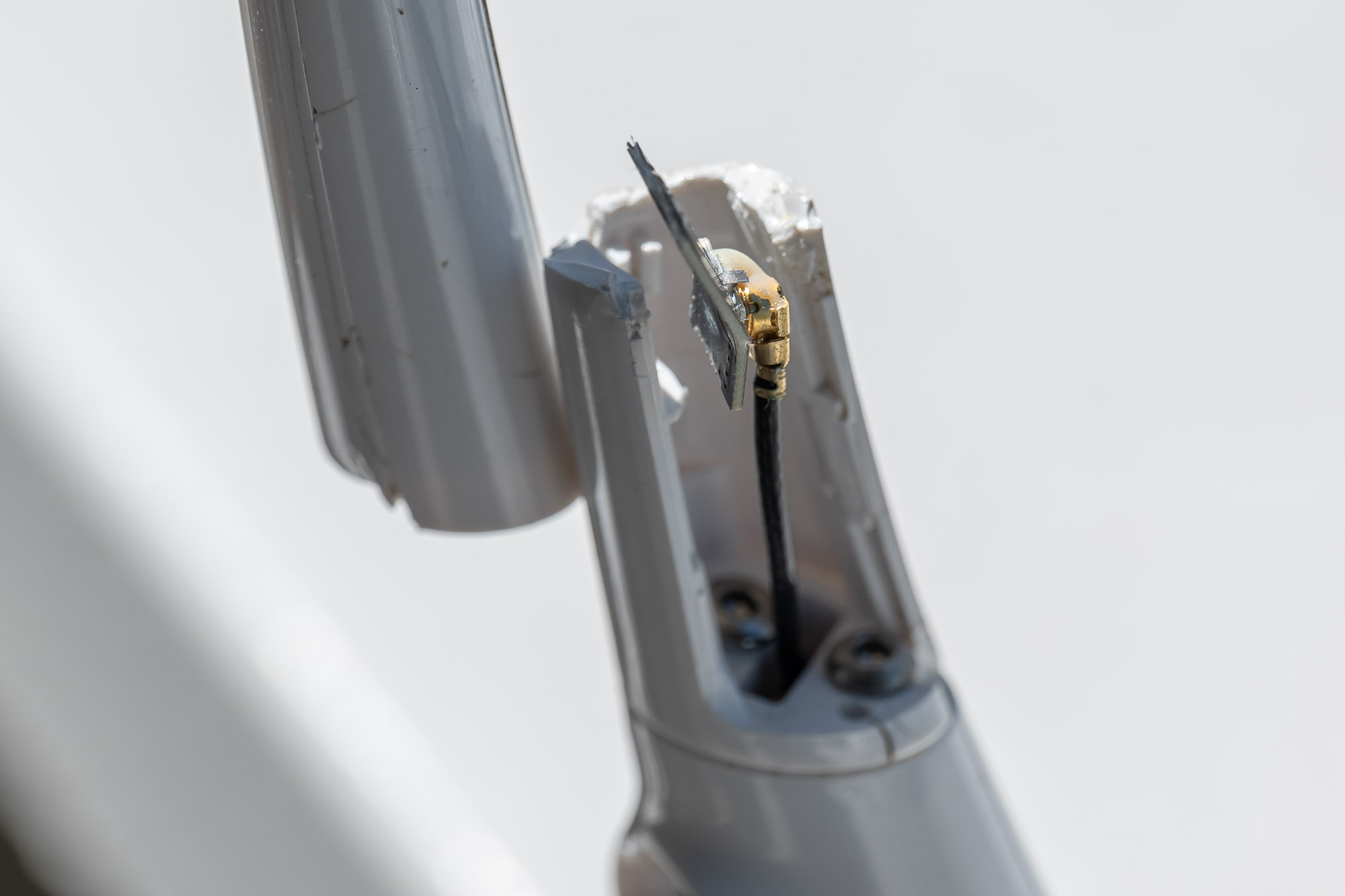

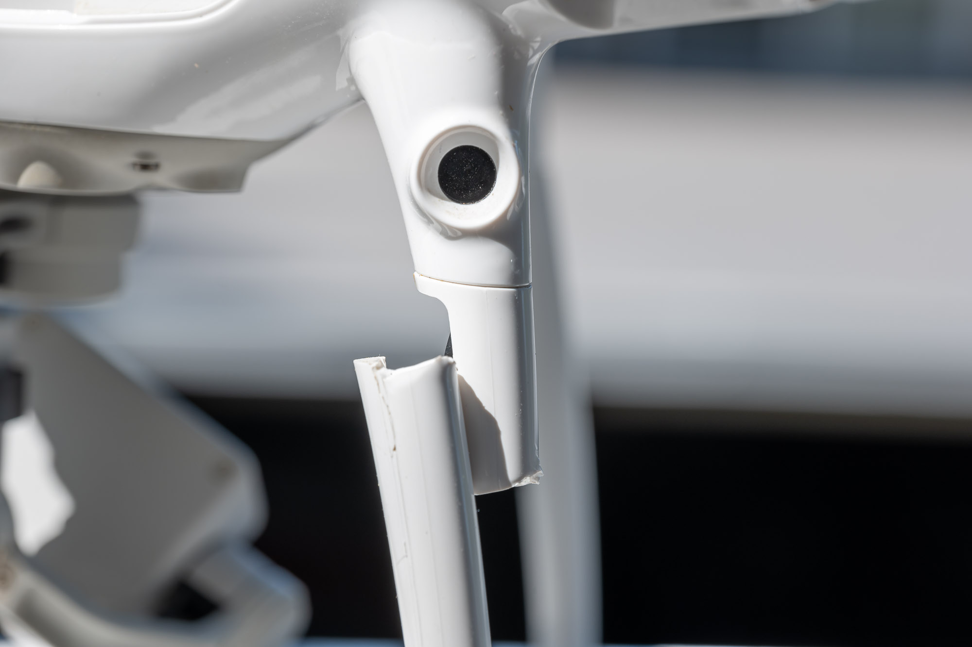

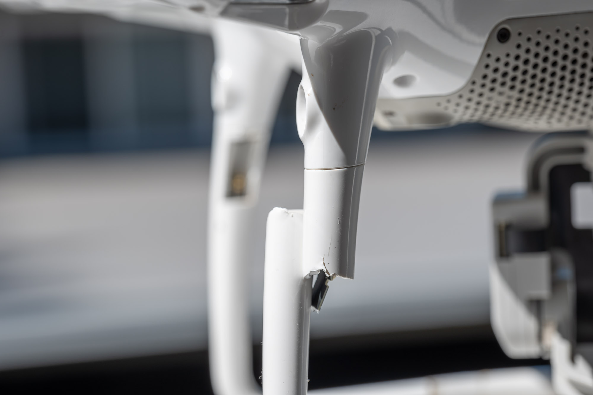

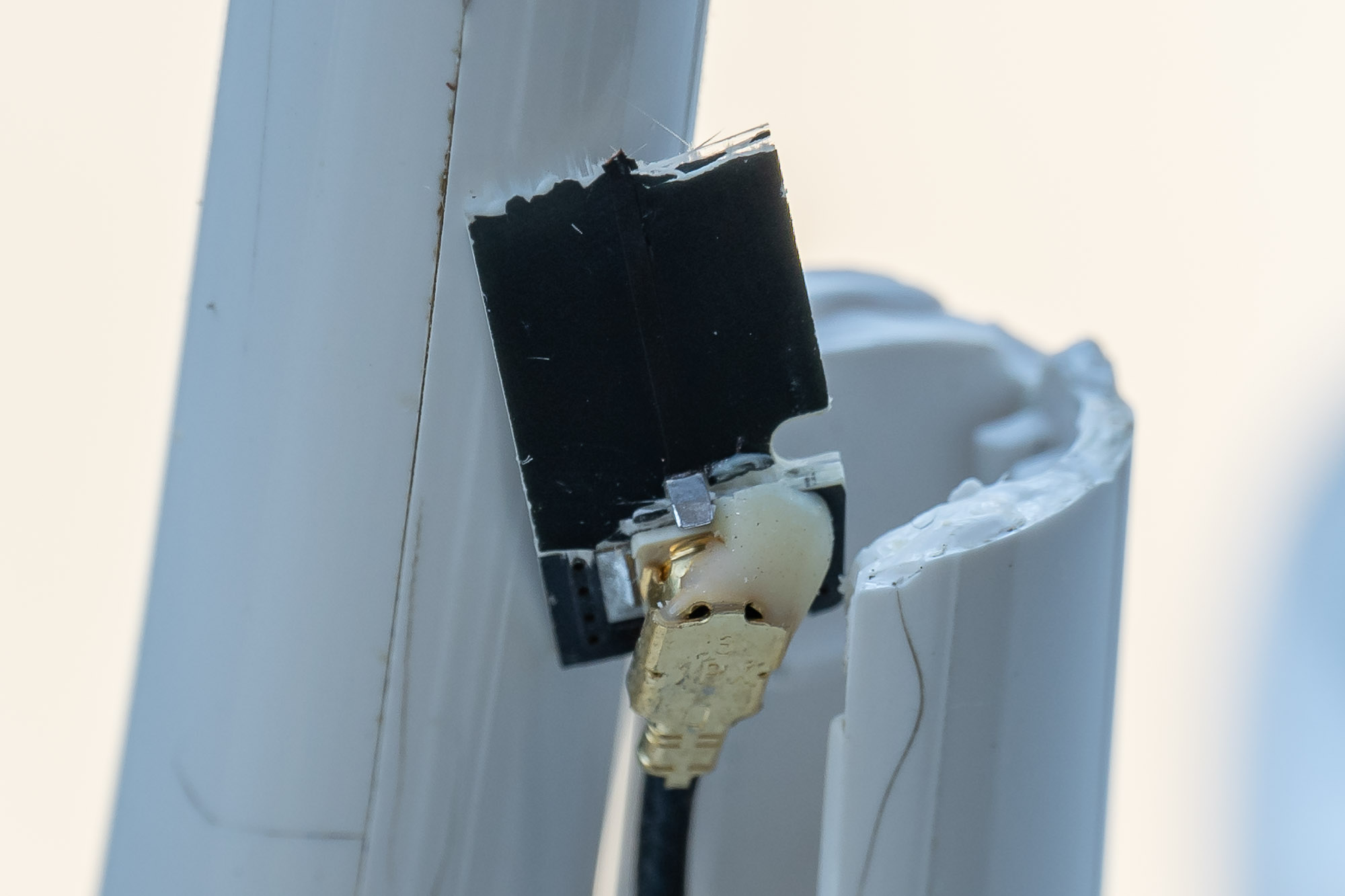

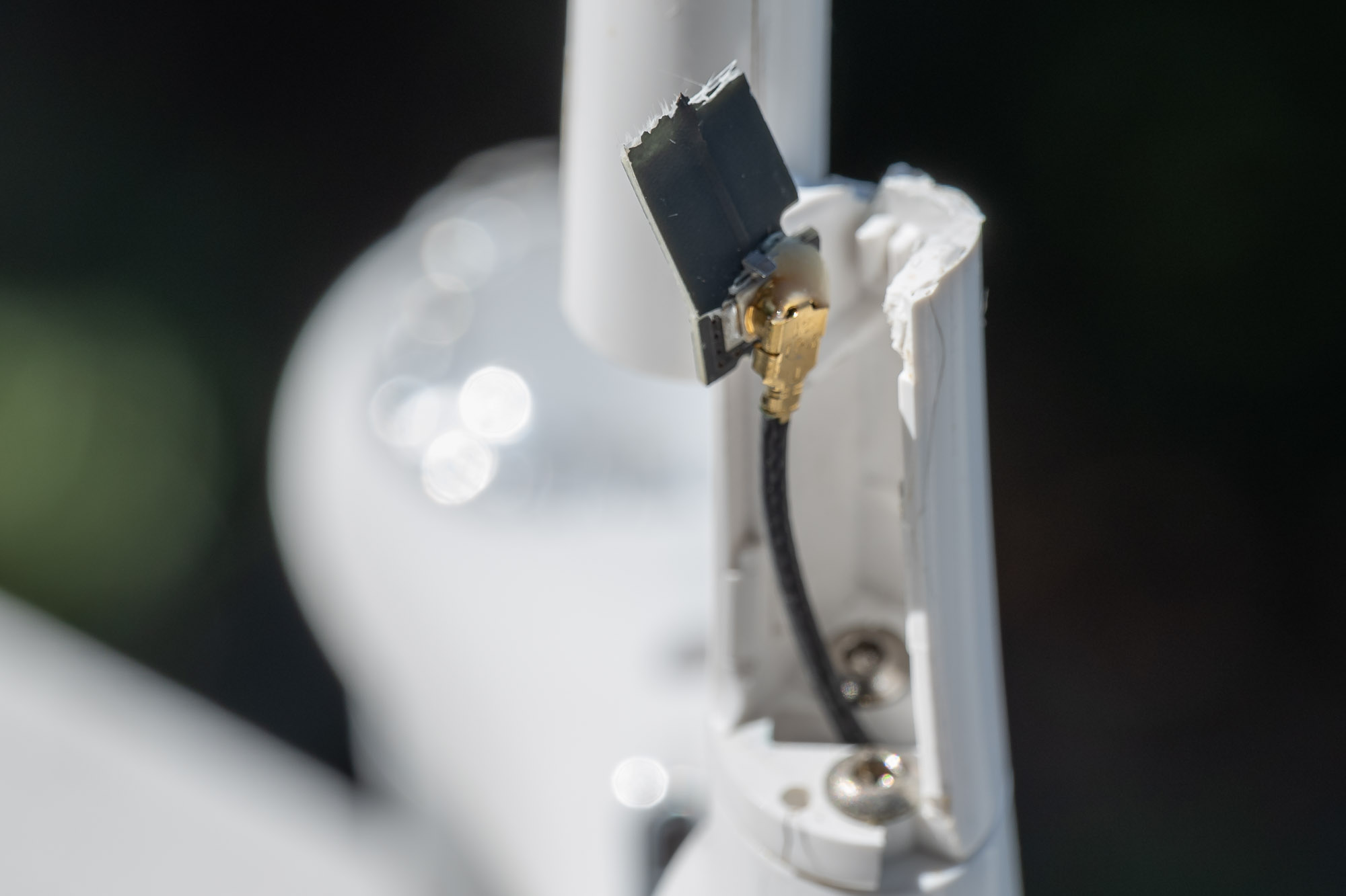

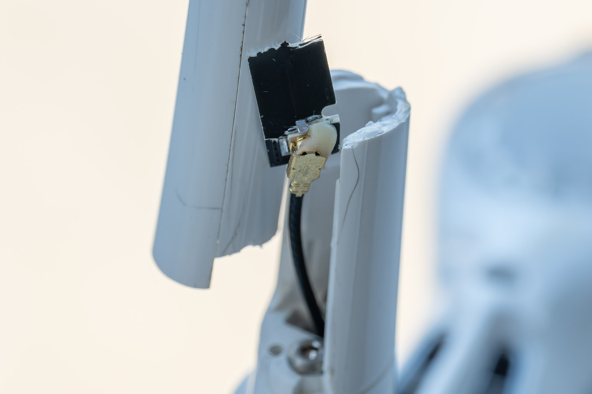

Can you please help identify what part this is that is broken? (See photos)
It is in the landing strut. There is a black wire that seems to be soldered on to some thin black "wafer" of some kind. This is about two inches below the sensor on the back right hand side of the drone.
What is this wire for? Can I fly with it broken like that? )I would of course tape up the landing strut.
Please note that the first FOUR pictures are upside down to give you a better view of the broken cable and black wafer. The last two photos are taken with the drone right side up so you have a better idea of where this is on the drone.

You will need to acquire a new set of landing legs. You have an antenna board that has lived its life. May be a compass board. I just can’t remember which one is where.
Reactions: Just Mark
First, thanks for the reply.
I just ordered this kit from Terrestrial Imaging. I think it is correct because my P$P is a version 1, not a V2 (it has the SILVER colored logo).
I got the set with both legs because the other leg also has a crack / break in it (although the cable and board at the end of the cable seems to be intact).
