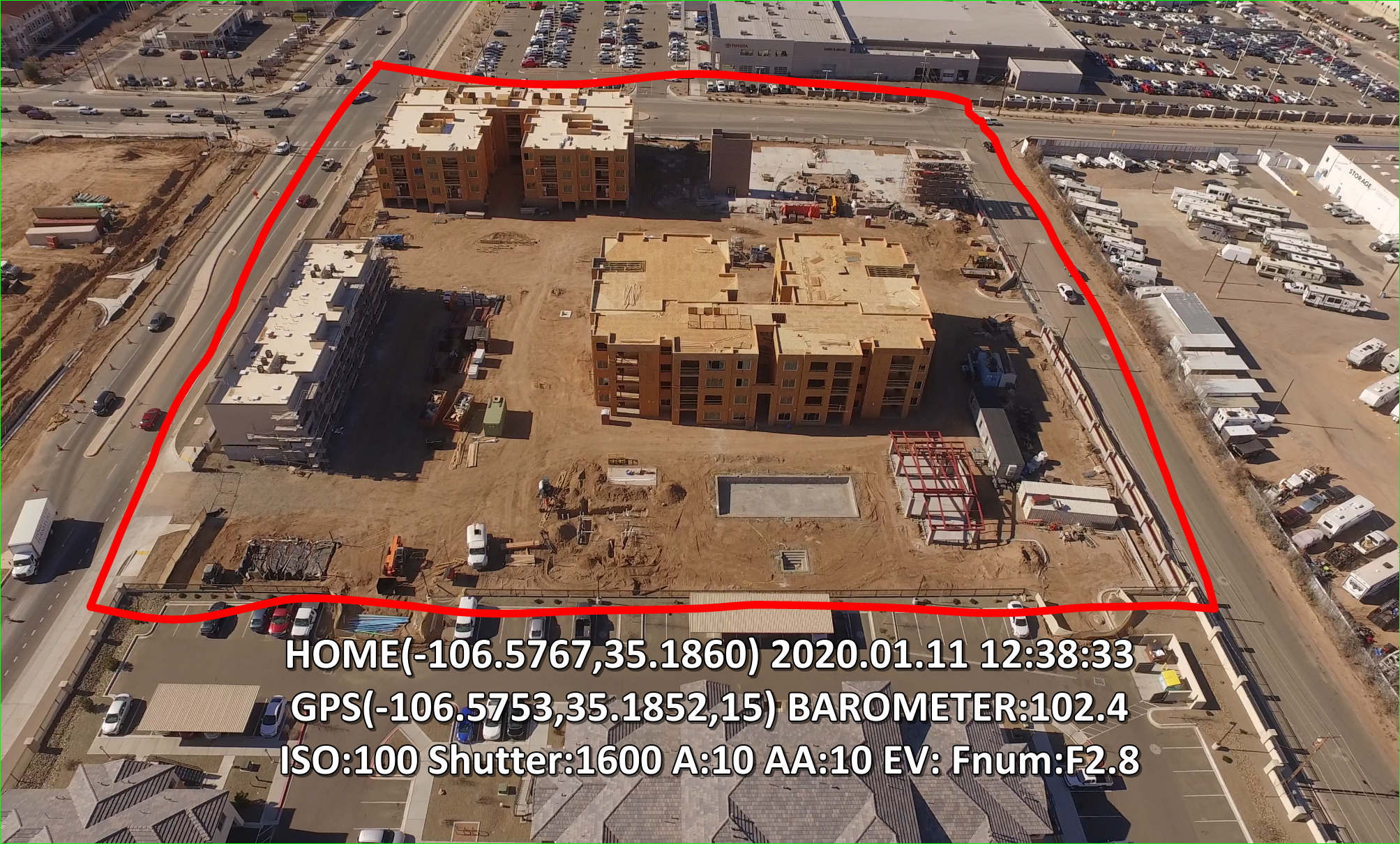

Early on I learned the hard way to shoot my raw construction footage in the Log color curve (D-Log for DJI). As you can see from this un-color-corrected sample, my earlier footage suffers from the same color artifacts as yours does:

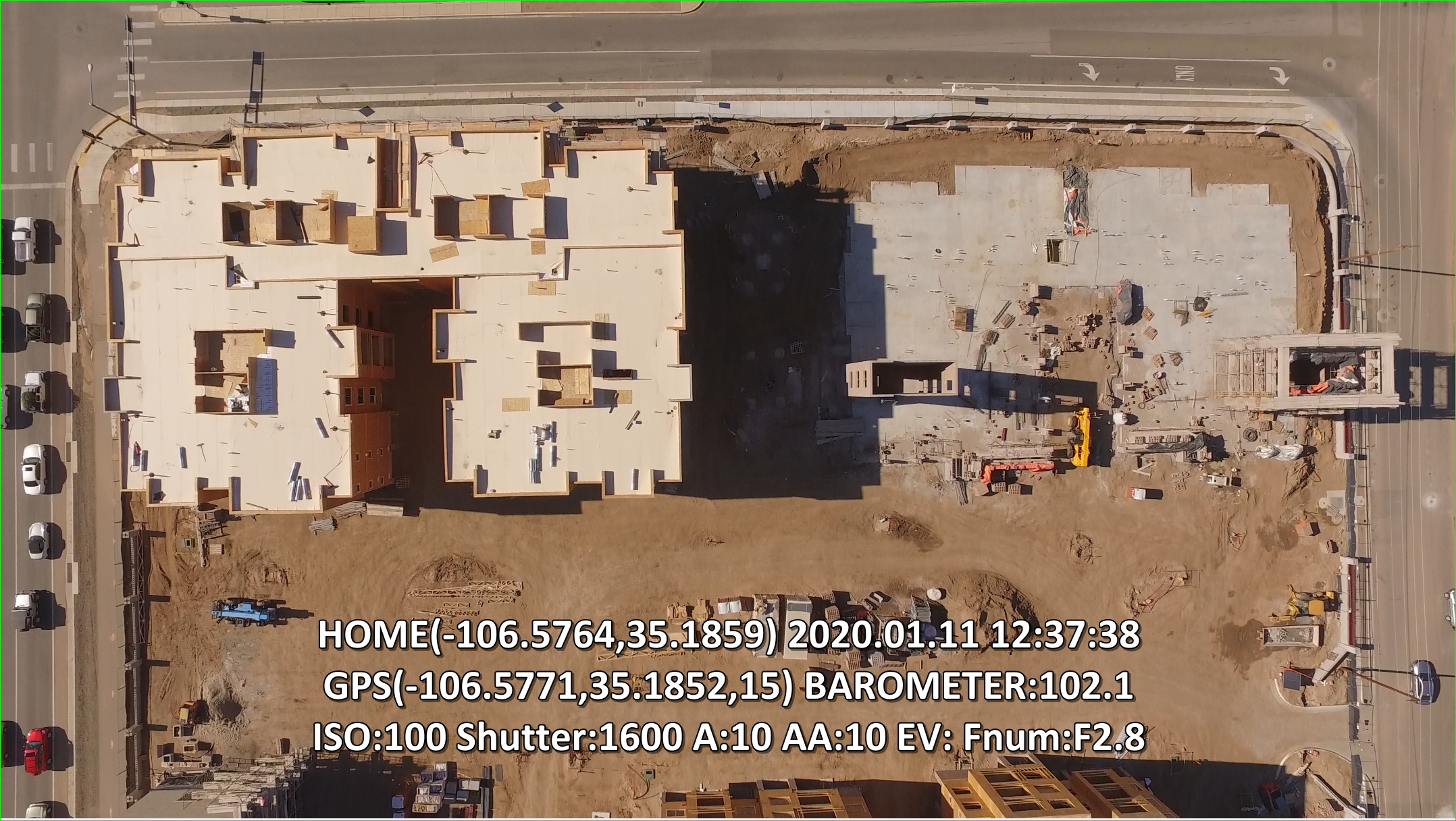

I had convinced my inner photography child that this video was just "quick and dirty" and was being utilized for "forensics," so "color didn't matter." So I left the camera in a mostly auto setting. Big mistake. It didn't take long before I started shooting in D-Log and custom WB, which allowed me to get a better handle on the color:
The challenge is keeping color consistent across seasons and different weather conditions. I try to shoot the same time of day for color and shadow consistency, but I can't always do that. Sometimes I have to shoot later in the day, which changes the WB. Subtle color temp changes throughout the season are inevitable.
I don't allow AWB because AWB will change the WB in the middle of a shoot. So instead I hard-code the White Balance based on the season and/or cloud cover. Ideally, I would shoot on only sunny days. But clients are more concerned with construction video delivered in a timely manner than color temperature. If I had my druthers, I would set custom WB using a gray card. But I just don't have time for that and the conditions are less than ideal for that method. So I take "best guesses" to get WB into the "ballpark." I'd bet dollars to doughnuts I'm not more than a 200K or 300K off...but I digress....
Regarding composition, construction is kind of easy. Video is about telling a story. And the story you are telling is "construction progress." My clients were only concerned with forensics, so I suggested basically 3 shots;
* a POI of the entire site
* a nadir, strafe of the entire site (flying forward)
* and then an oblique shot of the entire site (flying backward)
So far, every construction client has been very satisfied with my work. This is reflected in the "call backs" for new projects.
