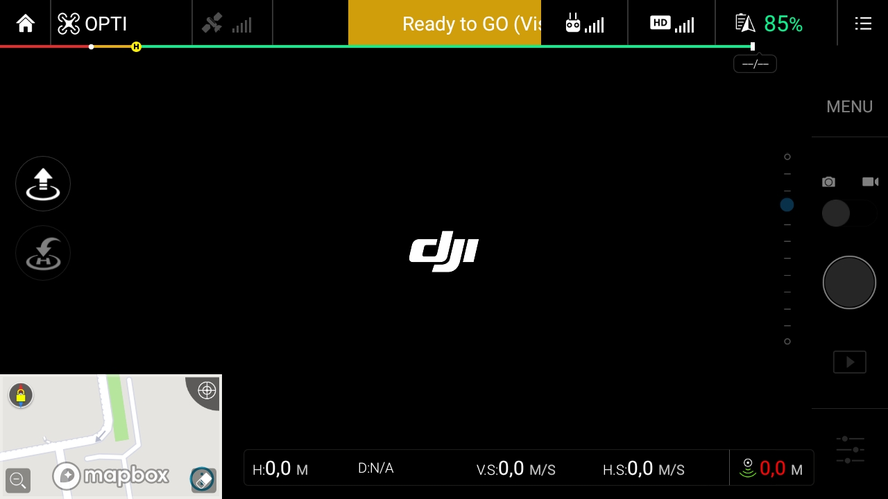

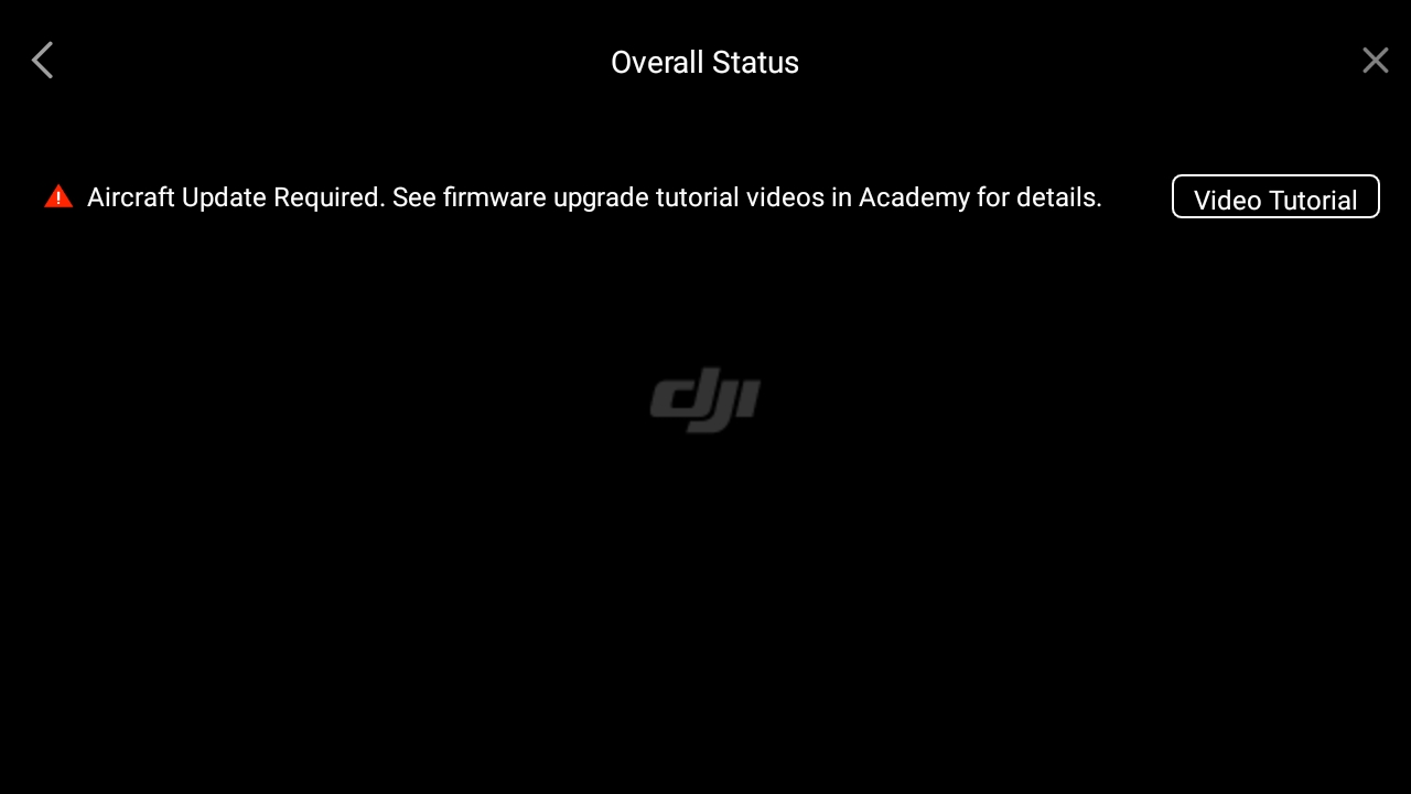

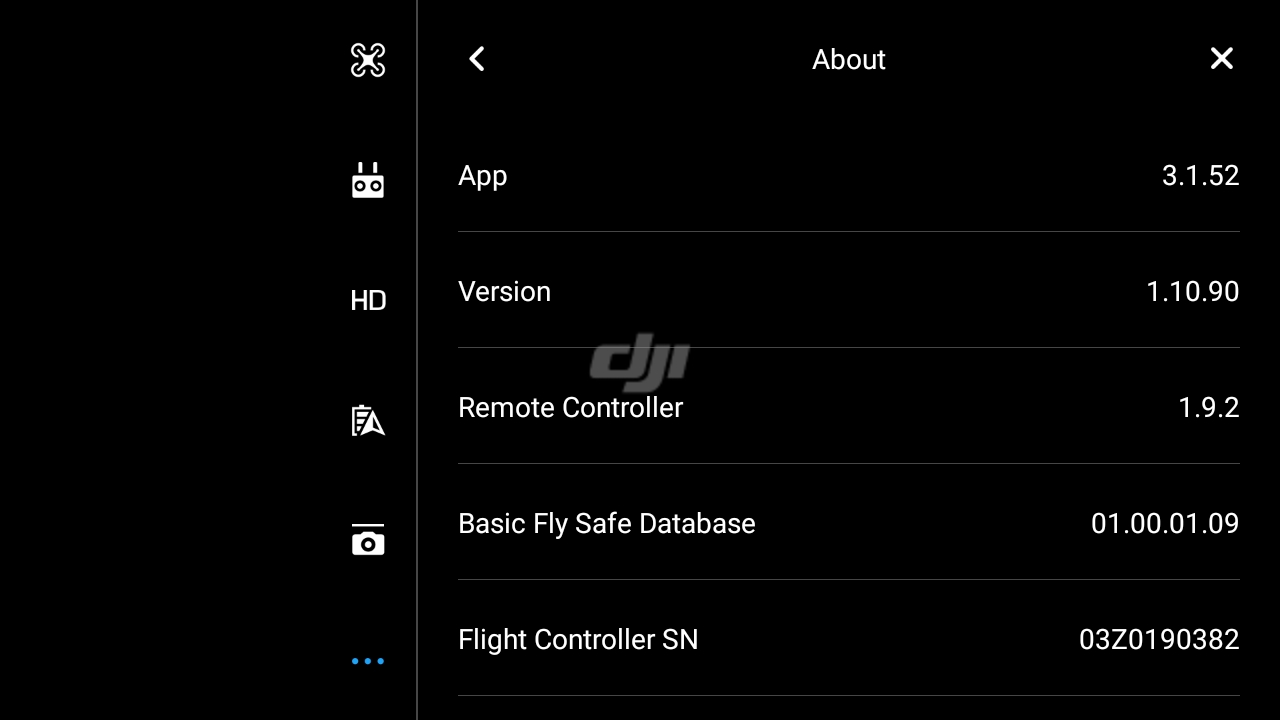

Hi guys, my Phantom 3 Pro problem: on my phone display is black. I got 1.10.90 version, so maybe I should upgrade to 1.11.20 firmware?
Pictures & video below:

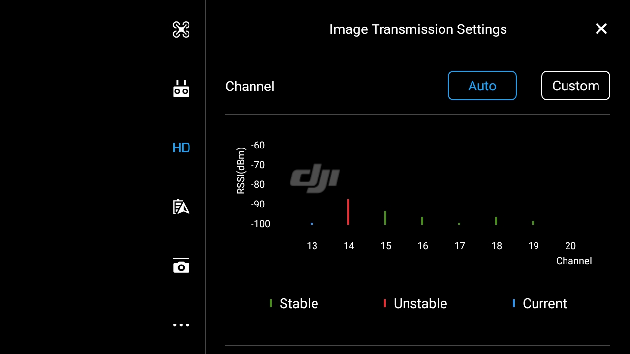

See if relinking again will help,you could try select another channel by switching to custom,not to sure with pro cause I not have one,,you could try reinstall the app but that will give you latest version which might make you do firmware which is supposed to be our decision, it's just a prompt at this point or it will say craft locked with solid red lights,I have had it on p4,,,couple ideas there , I still thinking
I have tried to relink but it did not work :(
Have you previously been able to see what the camera sees with that drone, controller and viewing device?
I’m glad my black screen (P3S) was easier to fix. Had two flight programs running, Litchi and Go. If I put one to sleep, I would get my video back on the other.
Guys, you see white DJI logo in the center, right? Anyway, SOLVED! I’ve just installed new firmware onto aircraft.
