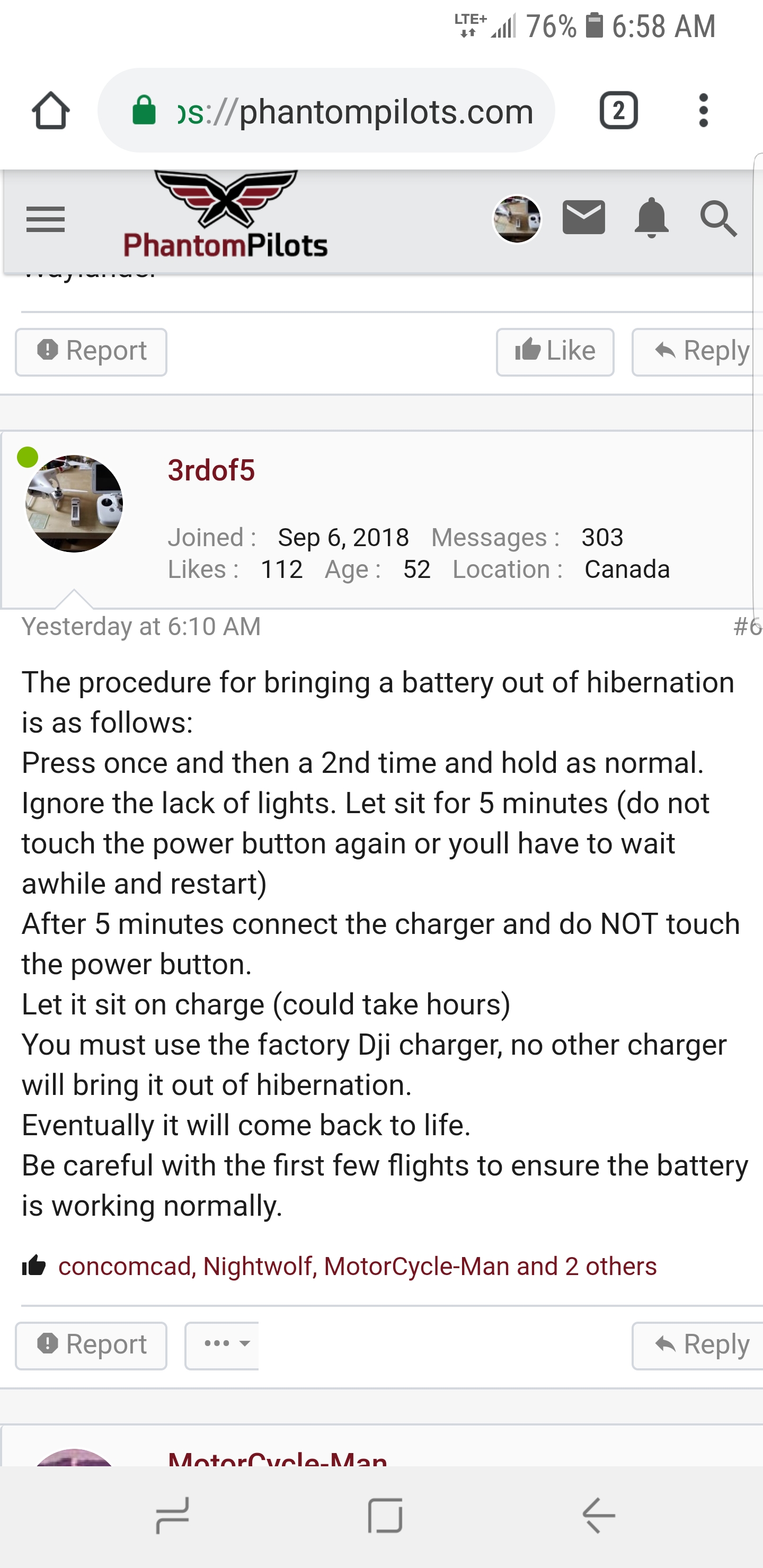

If its gone into hibernation, which is very likely, you will need to follow these instructions exactly:
