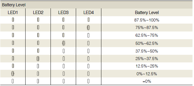

I wish there was a way to check the battery to see what the level is at any time without having to plug it into the Phantom and set it all up
When the battery is turned off, press the battery button once to see the current charge level.
Yes, but that's just a relative look. It doesn't tell you at what percentage the battery is at.
