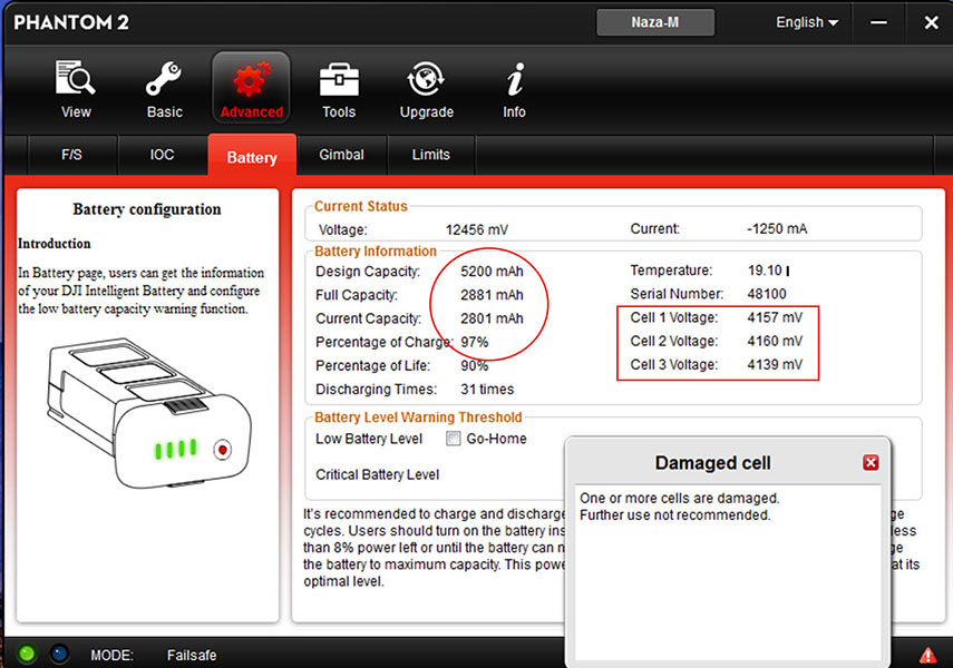

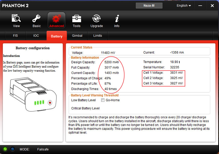

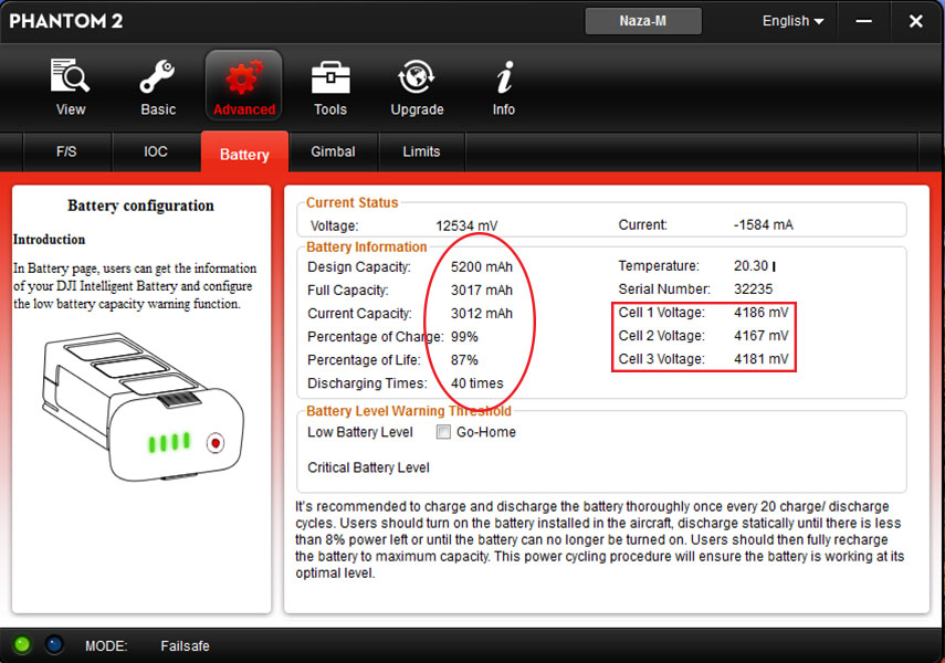

Sound as though you haven't been your battery properly at 50% when not using them after several days. The four photos you posted really do not the true story of the battery condition. Cell voltage levels are not as important as the current levels as you can see in these two photos.
Lucky if this battery would keep the P2 in the air more then 6 minutes. If you are using FPV you can monitor only the voltage level and when it reaches 10.6 v you be ready to land your craft before it falls out of the sky.
So my advice is to charging those battery fully then check them using your P2 software and be aware of of the current levels. This battery was 100 feet in the air when I noticed the voltage level was at 10.6 volts at which time I landed it quickly.
View attachment 68894 View attachment 68893
