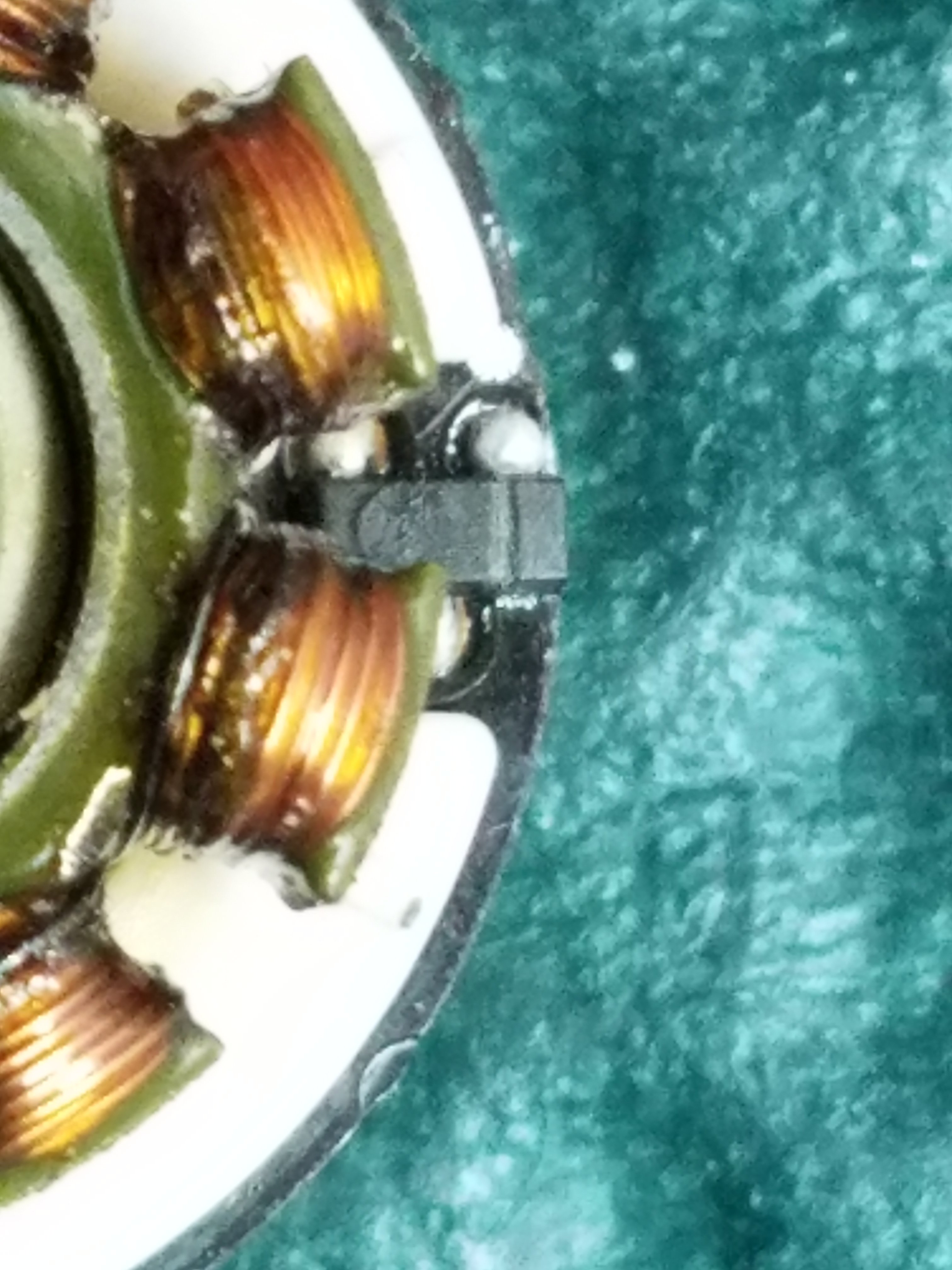

9 times out of 10, the yaw motor sensors are damaged. When you get done, if the camera won't point straight ahead, the sensors are bad. Do not trow away the old motor. You will need the casing. The is a special procedure for fixing it. Go to YouTube and look up droneted

The yaw motor is controlled by an ESC board on the back of the yaw arm. The yaw motor has 2 small (tiny) black sensors. You need a jewelers loupe to see the damage on them. The casing jams up against those sensors and makes a scratch across them. The problem is that the casing has magnets that are randomly placed. These magnets work with the sensors to tell the yaw where it is pointing. If damaged the yaw will either point left or right or swing about. You need to use the original casing on the new yaw motor. My video will show you how to do this.
Is that better? LOL I am very old and sometimes I get lazy.
I'm pretty certain this isn't on the 4 and 4 pro
