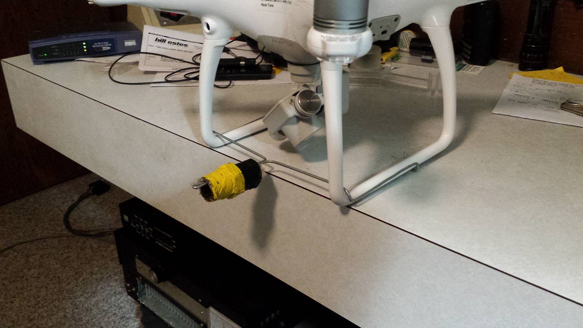

I will never use a slingshot again after this, but it really cant be too windy.
Let me see if this works.....
A single zip tie on either leg at the rear holds it on with no problems.

Rick, what is the clump at the end of the stub?

That is just the weight I tie the string to....A brass pipe fitting, The yellow tape is so it shows up.
Rick
