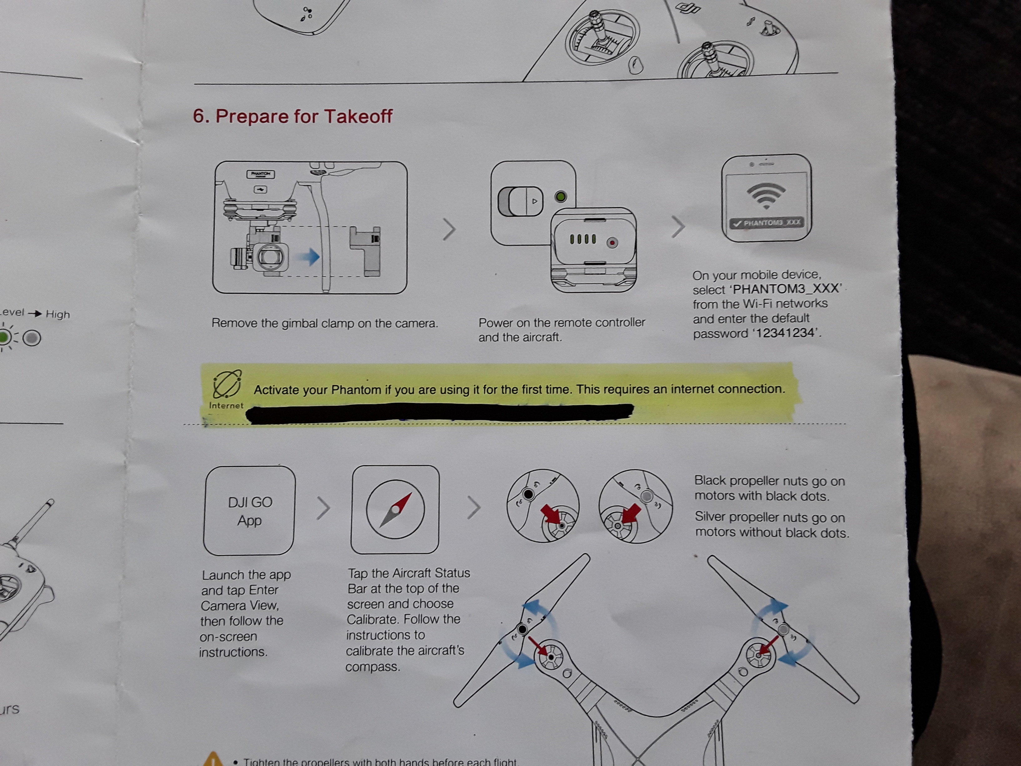

,HI here's a pic of quick start Guide ,does batt stay power on when out of the drone when pressed twice,if so batt working,It should have start up tune like 4 or 5 beeps,on your second press on batt ,not have to hold for long,it might be showing a form of batt test that is done to check batt cell which is a 5 sec press,,,if enter cam view that good and not the how to conect on screen,wifi working and connected, I'm thinking try not to hold 2 press on batt for no more than 2 sec,

Yes the battery stays on if out of the drone. When out of the drone and on I press and hold the button and all 4 green LED's blink. I can also turn the battery off the same way it's turned on.
Stumped!!!
How do you Activate the phantom?
Um also check terminals where batt contacts to,they might need little bend to contact proper,,original activation would have been done on first previous set up back a year ago,either with email address or a phone number,when not signed into dji they give a restriction of flight distance and height,but that not stopping you at moment ,I just checking something,you write to fast,ha,just trying to find a bit of new activation info
