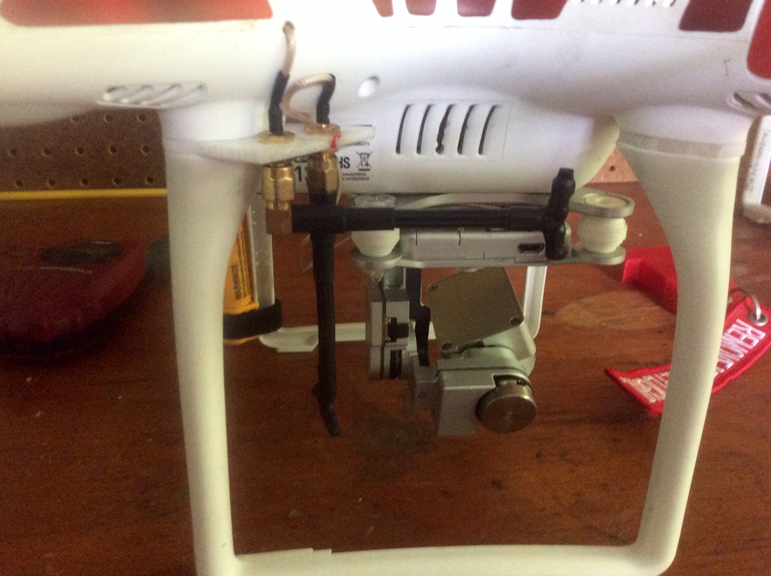

Got em on there, and I'm pretty happy with it visually. Was not that bad at all..
Winds are crazy today of course [emoji31] so hopefully get a test flight in tomorrow morning.
