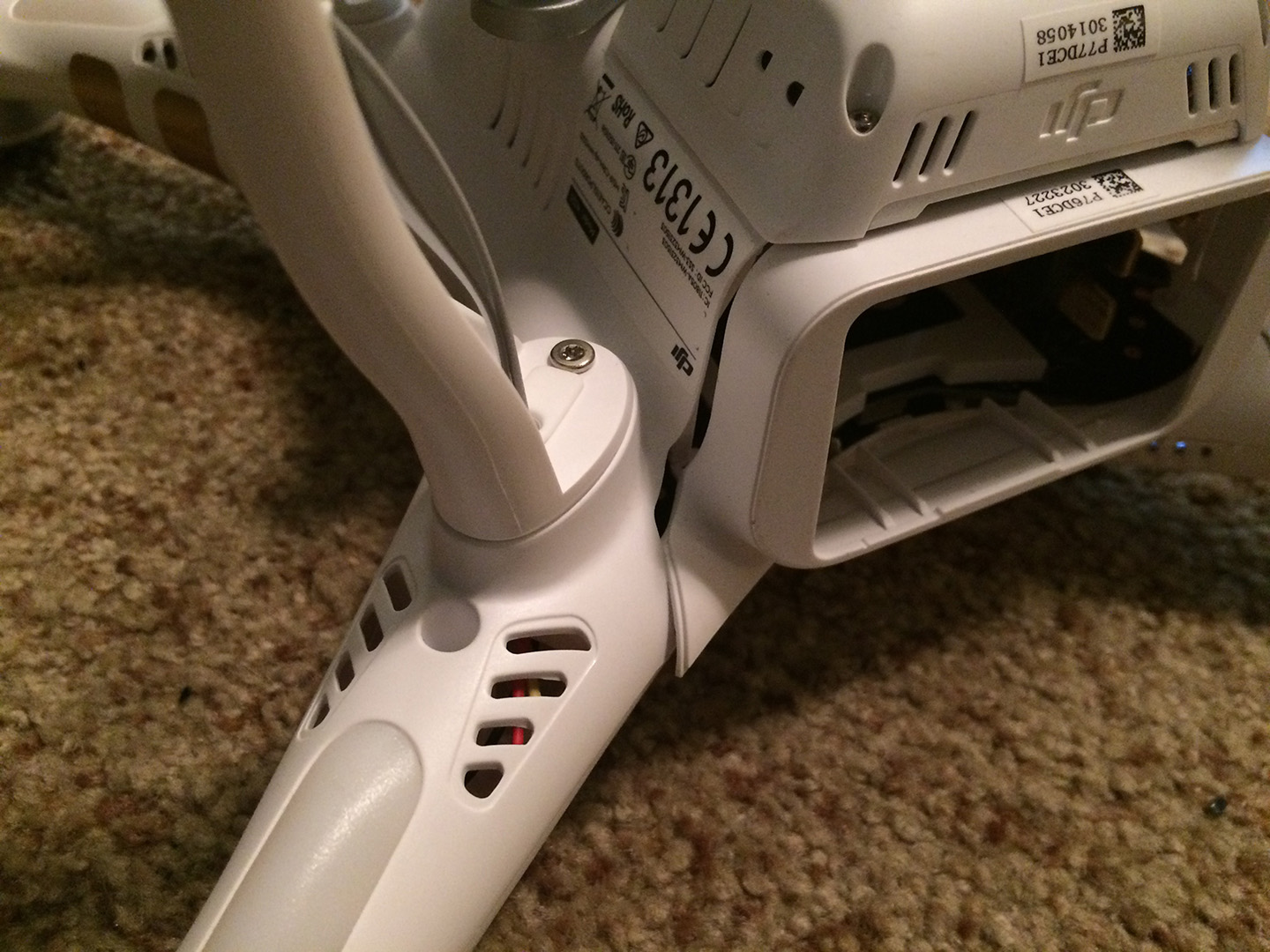

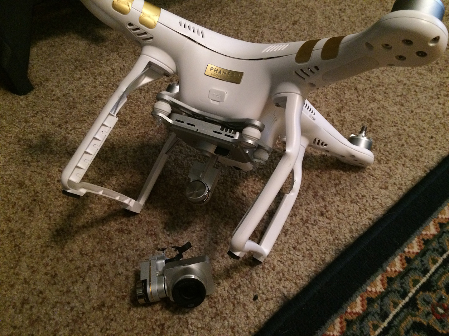

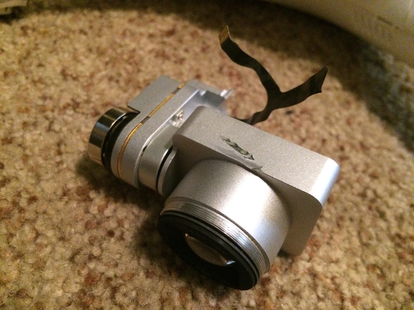

I AM BAFFLED. 207 Flights and never had this happen. All was well as I was flying back. No issues.... then simply spun out of control to the ground. Thankfully it slammed into the neighbors yard... and not their kids or house.
I've called DJI, they sent an RMA and it's been FedExed to DJI in California for diagnostics of the "problem". We'll see I guess. Fingers crossed.
Any input form you guys is welcome as I'm speechless as to exactly what happened. Has anyone had to get a replacement or repair? I'm assuming it'll be quite a while.
