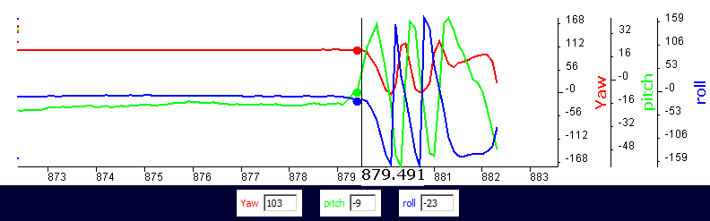

I'm gonna speculate that this incident was due to a leftBack propulsion issue; either a broken prop or a motor failure. Too bad the .DAT can't be retrieved. The onset started with a pitch up and roll left which would be consistent with loss of leftBack propulsion. The AC stated CCW rotations which is consistent with either a leftBack or rightFront propulsion loss.
The loss of satellites, gpsHealth was probably caused by the tumbling.

Interesting graphs! Could it be that a prop came off?
Yes, I guess I forgot to mention that a prop coming off is also a possibility. But, doesn't the P4P have locking hubs? I don't actually know since I only have a P3 and Mavic.
Im not good yet at analzing the data, all I know is the **** thing dropped out of the sky for seeminglly no reason!
Trust me, there's always a reason why it happened... A prop lost, compass errors, internal board issue, even striking a bird or a bird striking your drone... There are always a reason why a perfectly working drone dropped from the sky.
I'm gonna speculate that this incident was due to a leftBack propulsion issue; either a broken prop or a motor failure. Too bad the .DAT can't be retrieved. The onset started with a pitch up and roll left which would be consistent with loss of leftBack propulsion. The AC started CCW rotations which is consistent with either a leftBack or rightFront propulsion loss.
what program is that?
only works on Litchi CSV files though, right?
Negatory. From
