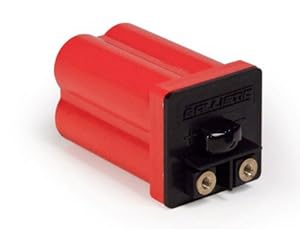

Hey guys, for those interested in super long flight times- could a 12V LiFePo battery be used such as this one http://www.ebay.com/itm/Ballistic-E...Parts_Accessories&hash=item5af03ad85c&vxp=mtr
....can the stock DJI Phantom controller withstand 12V of battery power?
It only weighs 8ozs....
The ad does not say anything about capasity of the battery,
how many mAh does it carry? It says fully charged 13,6 Volts
which is a volt more than a fullt charged 3S, but I dont think
the voltage is a problem as we fly NAZA on 4S on other
platforms.
My 2cents is that its much easier to stick with the
standard packs, just add a pack in parallell if
you need more airtime.
